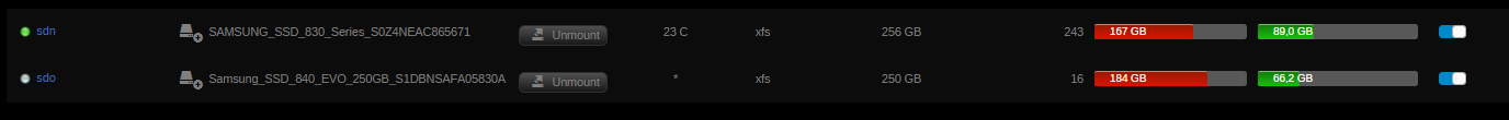

After moving these 2 SSD the trim works now! Thanks. //Peter
Thanks. will check where these are connected to.
root@Tower:~# cat /sys/block/sdn/queue/discard_max_bytes 0 root@Tower:~# cat /sys/block/sdo/queue/discard_max_bytes 0 So it looks like these SSD:s are not able to use TRIM on. //Peter
Hi! I cant see that my 2 SSD disc are mounted with discard operation. FYI: I did manually format the 2 disc as XFS from the command prompt. Is there anything I have missed ? //Peter Sep 18 11:39:40 Adding disk '/dev/sdn1'... Sep 18 11:39:40 Mount drive command: /sbin/mount -t xfs -o rw,noatime,nodiratime '/dev/sdn1' '/mnt/disks/SSD1' Sep 18 11:39:40 Successfully mounted '/dev/sdn1' on '/mnt/disks/SSD1'. Sep 18 11:39:40 Defining share 'SSD1' on file '/etc/samba/unassigned-shares/SSD1.conf' Sep 18 11:39:40 Adding share 'SSD1' to '/boot/config/smb-extra.conf' Sep 18 11:39:40 Enabling the Recycle Bin on share 'SSD1' Sep 18 11:39:40 Reloading Samba configuration... Sep 18 11:39:40 Directory '/mnt/disks/SSD1' shared successfully. Sep 18 11:39:40 Device '/dev/sdn1' script file not found. 'ADD' script not executed. Sep 18 11:39:40 Adding disk '/dev/sdo1'... Sep 18 11:39:40 Mount drive command: /sbin/mount -t xfs -o rw,noatime,nodiratime '/dev/sdo1' '/mnt/disks/SSD2' Sep 18 11:39:40 Successfully mounted '/dev/sdo1' on '/mnt/disks/SSD2'. Sep 18 11:39:40 Defining share 'SSD2' on file '/etc/samba/unassigned-shares/SSD2.conf' Sep 18 11:39:40 Adding share 'SSD2' to '/boot/config/smb-extra.conf' Sep 18 11:39:40 Enabling the Recycle Bin on share 'SSD2' Sep 18 11:39:40 Reloading Samba configuration... Sep 18 11:39:40 Directory '/mnt/disks/SSD2' shared successfully. Sep 18 11:39:40 Running command '/boot/config/plugins/unassigned.devices/Samsung_SSD_840_EVO_250GB_S1DBNSAFA05830A.sh' with action 'ADD'. Sep 18 11:39:40 Adding disk '/dev/sda1'... Sep 18 11:39:40 Mount drive command: /sbin/mount -t vfat -o auto,async,noatime,nodiratime,nodev,nosuid,umask=000 '/dev/sda1' '/mnt/disks/UNRAID_VM' Sep 18 11:39:40 Successfully mounted '/dev/sda1' on '/mnt/disks/UNRAID_VM'. Sep 18 11:39:40 Defining share 'UNRAID_VM' on file '/etc/samba/unassigned-shares/UNRAID_VM.conf' Sep 18 11:39:40 Adding share 'UNRAID_VM' to '/boot/config/smb-extra.conf' Sep 18 11:39:40 Enabling the Recycle Bin on share 'UNRAID_VM' Sep 18 11:39:40 Reloading Samba configuration... Sep 18 11:39:41 Directory '/mnt/disks/UNRAID_VM' shared successfully. Sep 18 11:39:41 Device '/dev/sda1' script file not found. 'ADD' script not executed. Sep 18 11:39:41 Disk with serial 'Storage_Media_9B4001209200016773' is not set to auto mount and will not be mounted... Sep 18 12:10:33 Reloading shared dir '/mnt/disks/SSD1'. Sep 18 12:10:33 Removing old config... Sep 18 12:10:33 Removing SMB share file '/etc/samba/unassigned-shares/SSD1.conf' Sep 18 12:10:33 Removing SMB share definitions from '/boot/config/smb-extra.conf' Sep 18 12:10:33 Reloading Samba configuration.. Sep 18 12:10:33 Successfully removed SMB share 'SSD1'. Sep 18 12:10:33 Reloading shared dir '/mnt/disks/SSD2'. Sep 18 12:10:33 Removing old config... Sep 18 12:10:33 Removing SMB share file '/etc/samba/unassigned-shares/SSD2.conf' Sep 18 12:10:33 Removing SMB share definitions from '/boot/config/smb-extra.conf' Sep 18 12:10:33 Reloading Samba configuration.. Sep 18 12:10:33 Successfully removed SMB share 'SSD2'. Sep 18 12:10:33 Adding new config... Sep 18 12:10:33 Defining share 'SSD1' on file '/etc/samba/unassigned-shares/SSD1.conf' Sep 18 12:10:33 Adding share 'SSD1' to '/boot/config/smb-extra.conf' Sep 18 12:10:33 Enabling the Recycle Bin on share 'SSD1' Sep 18 12:10:33 Reloading Samba configuration... Sep 18 12:10:33 Directory '/mnt/disks/SSD1' shared successfully. Sep 18 12:10:33 Adding new config... Sep 18 12:10:33 Defining share 'SSD2' on file '/etc/samba/unassigned-shares/SSD2.conf' Sep 18 12:10:33 Adding share 'SSD2' to '/boot/config/smb-extra.conf' Sep 18 12:10:33 Enabling the Recycle Bin on share 'SSD2' Sep 18 12:10:33 Reloading Samba configuration... Sep 18 12:10:33 Directory '/mnt/disks/SSD2' shared successfully. Sep 18 12:20:13 Adding disk '/dev/sdq1'... Sep 18 12:20:13 Mount drive command: /sbin/mount -t vfat -o auto,async,noatime,nodiratime,nodev,nosuid,umask=000 '/dev/sdq1' '/mnt/disks/UNRAID_VM' Sep 18 12:20:13 Successfully mounted '/dev/sdq1' on '/mnt/disks/UNRAID_VM'. Sep 18 12:20:13 Defining share 'UNRAID_VM' on file '/etc/samba/unassigned-shares/UNRAID_VM.conf' Sep 18 12:20:13 Reloading Samba configuration... Sep 18 12:20:13 Directory '/mnt/disks/UNRAID_VM' shared successfully. Sep 18 12:20:13 Device '/dev/sdq1' script file not found. 'ADD' script not executed.
