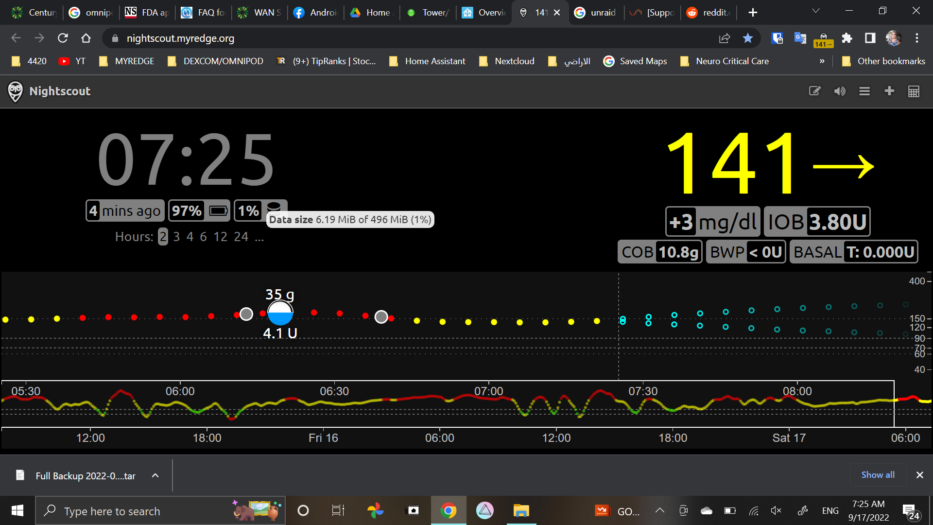

  1. Hi I know this is an old topic, but I hope someone can help. I managed to install the containers and NS is up and running. I have a large (32 TB) storage capacity, however NS is showing only a capacity of 496MiB. Is there a way to make the container read the whole storage capacity of the unraid server or is it just an error in reporting? Thanks
