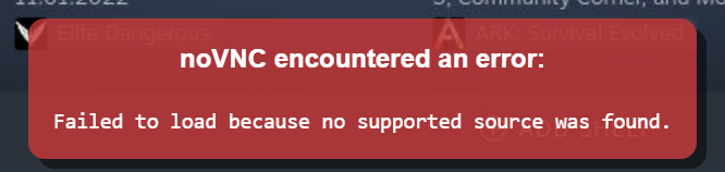

  21. Ok, so i just tried again and it came u fine. I updated it to the latest version. The problems i was experiencing before was this - My problem now is that my xbox controller doesnt work. Its paired to my google TV via bluetooth. My phone with on screen controls doesnt work either. My PC running keyboard and mouse streams just fine. Running 6.10RC2, the plugin is installed too. Server has been rebooted with no effect

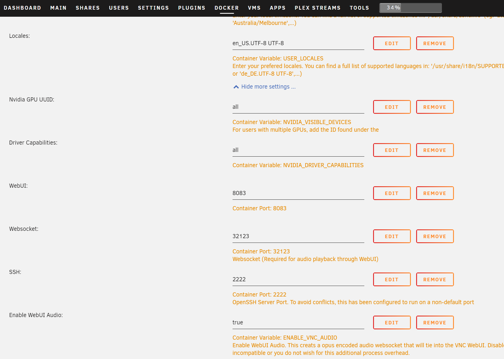

  23. Edit: NVM, full server reboot and it's working. Apart from controller support, that's not working, but that's because I'm not using host network due to port conflicts
