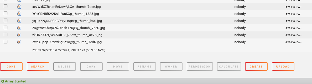

I have just move my database backup to my UNRAID server, on to the disk array. The database has pictures that are linked to the database and stored in a folder next to the database files. Over time the picture collection has grown to 29,900 images in one folder. Viewing the server and folder via the Web browser I can view the 29,900 files, it takes a few moments for the window to show all the images and Krusader happily moves the folder from cache pool to the array. The problem starts when I try and view the folder from my Mac running OS 12.4 (This also happens with OS 12.3.1) via a SMB share. When opening the folder it hangs with a loading symbol but never completes to show the 29,900 images, I can close the window but the finder than crashes and I have to restart my computer. I am currently running UNRAID Version: 6.10.2 but this also happened under Version: 6.10.1. I have only just moved this large folder to UNRAID so unsure about previous versions. Also I moved the folder to a ssd cache pool and made no difference. All the other shares on the cache pool or array work at speed but do not have the quantity of files that the database contains, Probably a 1,000 files at the most. Is there a maximum number of files you can have in a folder with a SMB share? I have already added the following code to the SMB Extras under setting to get the search, copy to and from working. #unassigned_devices_start #Unassigned devices share includes include = /tmp/unassigned.devices/smb-settings.conf #unassigned_devices_end [global] vfs objects = catia fruit streams_xattr fruit:nfs_aces = no fruit:zero_file_id = yes fruit:metadata = stream fruit:encoding = native spotlight backend = tracker [share name] path = /mnt/user/share name veto files = /._*/.DS_Store/ delete veto files = yes spotlight = yes Even in Version: 6.10.1. I need the SMB Extras code to get the search working.
