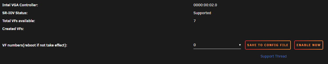

  1. I still havent managed to get this to work as well, so any help on this would be great!
  2. yep i've rebooted and no joy, do i just hit enable now, or save to config then enable? I've done both before a restart, and each on their own before a restart and none of the 3 have worked
  3. Great! that installed! but now i can seem to get it to add any VFs, no matter what i change, or clicking enable, i just stays like this, and i cant see any added VFs in the VMs setup
