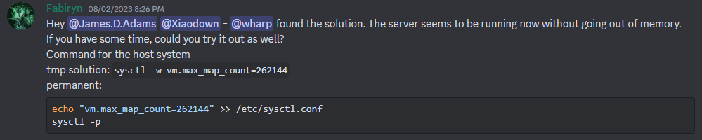

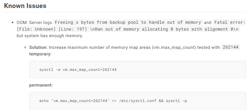

It is the same issue; the slowdown and physics breaking is just an early symptom of the server running out of memory blocks. It crashes when it runs completely out, and kicks everyone out before restarting to recover. I get the exact same errors Ran out of memory allocating 0 bytes with alignment in the exact same circumstances as mentionned in the discussion and ReadMe, with more than 30Gb of spare physical memory available. No pressure, I understand; I can imagine it'd be a nightmare as a maintainer to keep track of, and troubleshoot, every baind aid fix - which may or may not work, when the real solution lies upstream with the game itself. From what I understand, even the Windows dedicated server is still in "beta". Commands worked as you explained, thanks! I'll do a quick test run that way, to see if this "fix" even works in the long run. Will it be reset if the docker container is restarted (not Unraid as you mentioned, but the docker container itself)? I back up the save files with the appdata backup plugin every night, and it restarts the game containers in the process. Either way, in the long run I think I'll just spin up a Windows VM if the issue keeps coming up, until the Icarus devs release a native Linux server client (there seems to be some demand for it), or adress the issue specifically. I'll take your word that this fix is far from ideal anyways, I'd rather not play around with things I don't fully understand! If you have the time and opportunity to do so though, I'd be curious to see if you can replicate the issue on your end. Intuitively, I'd imagine running out of memory blocks becomes more of a thing when the world grows larger (as players explore) and more populated (with structures, equipment and creatures). So it could take some time before the issue comes up.
I've had a week and a half of smooth sailing, good performance and no bugs; but just yesterday and today, the friends I host for reported massive slowdowns, physics not working, followed by being kicked out of the server. I've rebooted yesterday, thinking it was a one-off, but it occured again today after about 14 hours of uptime. So I've experienced the issue twice at this point. I saw no mention of your container by searching the thread. I don't know of a "semi official" docker, but the one with the fix in the ReadMe is a SteamCMD variant like yours. The discussion itself had a variety of users: desktop linux, hosting providers, some Unraid users. Interesting. Following the discussion, I was under the impression that no one had really run a stress test over time yet to determine if it was a flawless fix. But the people at Shockbyte are apparently testing this specific fix for their customers. Yeah, I was surprised too; it's strange that it ran fine for over a week, then it all came crashing down in the past few days. Maybe it has something to do with the world size growing as the clients keep playing.
Hello @ich777! There seems to be an issue with Icarus running on linux, where it runs out of memory blocks, causing the docker container to crash (OOM) and restart. The community seems to have found a fix however, but it's beyond my capabilities to apply it myself; so I thought I'd forward the issue. Icarus "Linux and Docker Support" discord thread discussing the issue. Fixed community docker hub page has a ReadMe at the bottom explaining the issue and the fix. Is this a fix that can be implemented on your end through the Docker Hub? Or is it something we have to implement on our end? If so, I'll finally have to sit down and learn how to edit docker files on Unraid. If I understand correctly, I can use the docker console to apply the fix, but it won't "stick" through updates unless I edit the dockerfile itself? Regardless, thanks for taking the time and effort to put out all these containers and make life simple for the rest of us! Much appreciated. TL;DR: Those who have issues with the Icarus Docker crashing with a "Ran out of memory" error, it's a known issue with the dedicated server running out of memory blocks. Community seems to have found a fix, which you can find in the links above.
