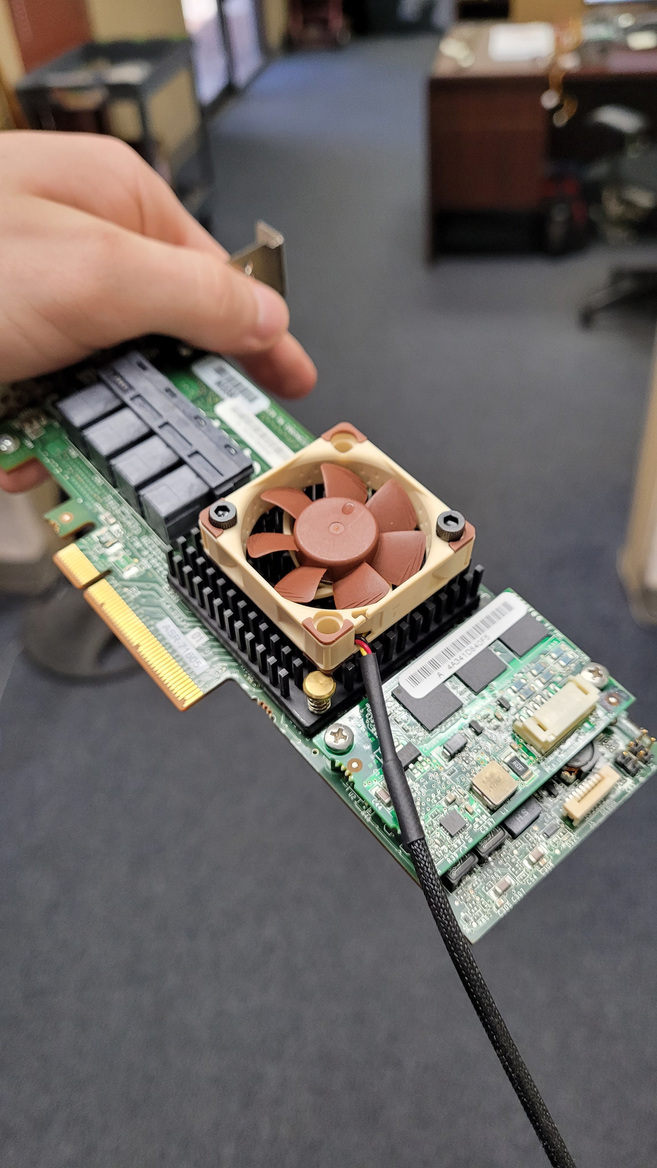

I looked into this a bit further and found the following; Some of the problems seem to be coming from the Adaptec HBA card. I am getting "aacraid: host adapter abort request" errors, as well as "detected capacity change from 1600900661248 to 0" on sdf, sdb, sdc, and sde, with sdc and sde being some of the ones showing the problems. To me, this points to one of my sas breakout cables potentially being bad, as that's 4 drives, and I have 4 drives per cable on one cable, and 2 drives per cable on another. So, I powered down the server again, and I moved the SAS breakout cables from the right half of the ports on the adaptec to the left, and pressed them in securely until I heard the click, and then rebooted. Still no dice, on the exact same drives. I have a feeling that I should replace the cables or the adaptec. I do not feel that the drives are bad. Edit: added the diagnostics for my most recent boot. Very different from the first diag. sedona-diagnostics-20230504-1659.zip

Hello forum, My UnRaid server started exhibiting an odd error earlier this morning. I was unable to access any of my user shares, so I started to look into why. When viewing the main tab, there is a red X next to Parity and next to Disk 2. In my system, there are 6 total hard drives in my system, with 4 drives as data, and 2 as Parity. They are all connected through an Adaptec ASR-71605 in HBA mode, using 8643 SAS to SATA breakout cables. My first thought was to try checking SMART data, so I went to Tools > Diagnostics > Download (with anonymize turned OFF), and tried to read the SMART data. To my surprise, All of the SMART files did not display any data, and were mostly empty. The problem drives were showing errors such as "Smartctl open device: /dev/sde failed: No such device or address" My next thought was to try checking from the UnRaid GUI by clicking the drives, and generating a smart short self test report per drive. To my dismay, nothing would show at all. Figuring there was some sort of bigger problem at play, I tried to click "STOP" on the array under Main in the webGUI, thinking it would allow me to generate SMART data afterwards. I went to the drives individually again, and I couldn't get anything to display, which was quite odd. Now, I figured the next easiest thing to do would be a simple reboot, so I opened the terminal, and typed "powerdown -r" to give it a fresh restart. Once the system booted, I went back into the webGUI, then to Tools > Diagnostics > Download for a new diag file, before ever mounting the array. This worked, and I was able to read the smart data. To me, the data seems alright. Not like there would be drive failures, but not fantastic either. I've linked the diag file here. Considering the SMART data seemed alright, I went back to the "main" tab, and even before the array was mounted, the same two drives were disabled. I tried mounting the array anyway, and again, they were disabled. My next thought was that there could be some sort of loose cable for power or data for those two drives, so again, I powered down the machine, but this time, without an immediate restart. I went into my server room and unplugged all cables from the drives, and reseated them, and then rebooted the system, and grabbed another diag file. Again, they were disabled. My final thought before deciding to write this was to check the system logs from my initial diagnostics zip, before I ever rebooted the system. I noticed some odd entries after 5AM this morning, a time when nobody would be using this system. I have no clue what any of these mean, so I wanted share that here and ask. Since that diag zip was not anonymized, I have linked solely that syslog.txt here, and it doesn't show anything I am uncomfortable sharing here. What is going on with my system? Is there bad hardware, or is something wrong with my configuration? --------------------------------------------------------------------------- For some additional context for the drives, the system was build on April 27th of 2022, and the drives were brand new off Amazon. I doubt that two of the drives would fail in the same morning a year later after working just fine for this long. Considering they're from the same batch, I would assume they would ALL fail within a close period of time to each other, but not only two of the drives. sedona-diagnostics-20230504-1133.zip syslog.txt

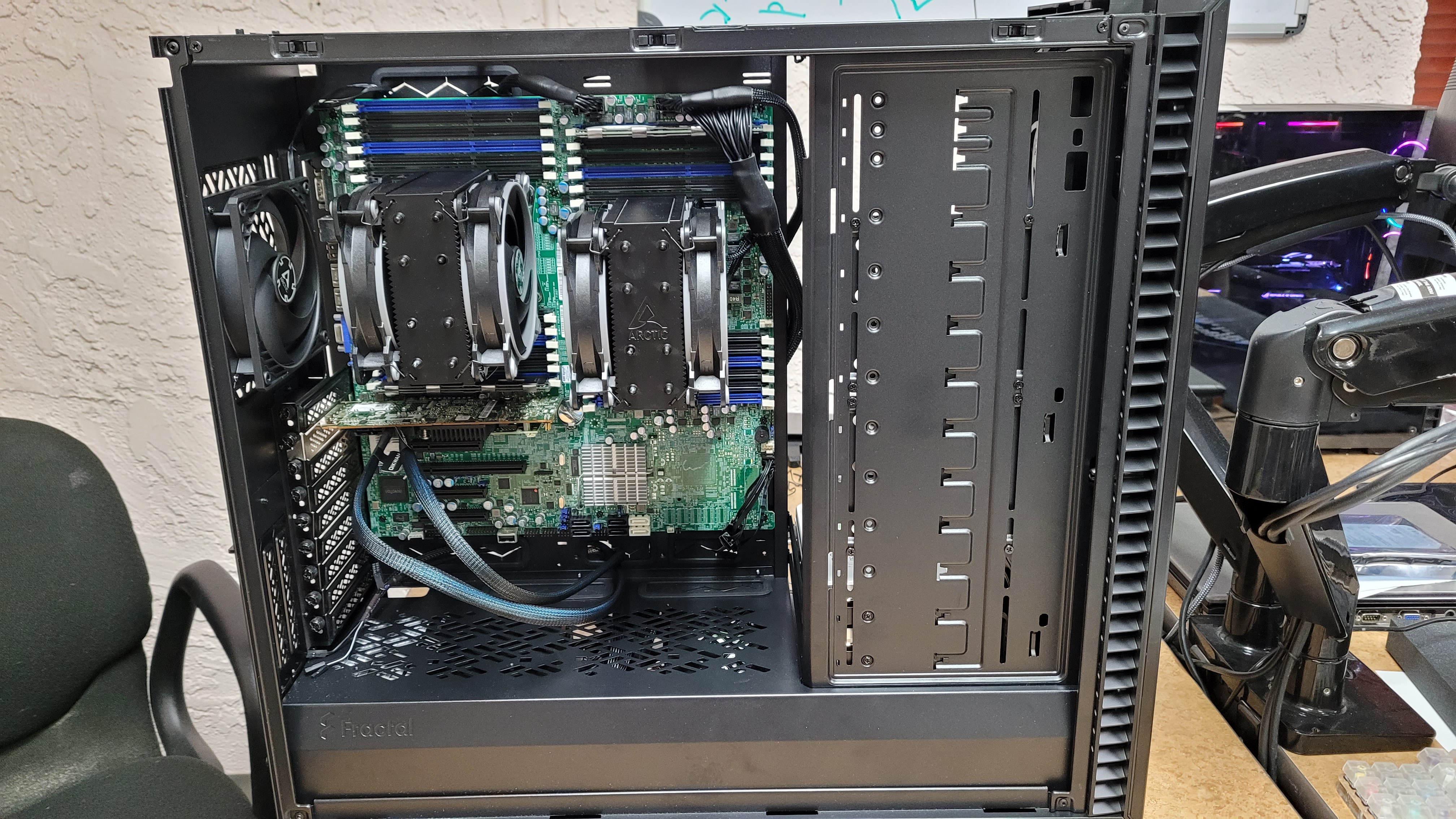

For my own personal answer, My server cost roughly $2511 to build. The specs of my server are shown in my signature, but here's a breakdown Base Fractal Design 7XL ($250) (Newegg) Corsair HX750 80+ Plat Fully Modular PSU ($145) (Amazon) Adaptec ASR-71605 ($89.99) (Ebay) CableCreation Mini 8643 SAS->SATA Breakout Cable, 0.5M / 1.6ft ($15.59) (Amazon) Unraid Pro ($129) Compute Supermicro X9DRE-TF+ ($155) (Ebay) 2x Xeon E5-2660-v2 ($20/each) (Ebay) 2x32GB IBM 78P1539, RDIMM, 1066MHz ($34/each) (Ebay) Cooling Arctic P12 PWM 5 pack ($30.99) (Amazon) Noctua A4x10 FLX ($13.95) (Amazon) Arctic Freezer 34 Esports Duo ($46.7/each) (Amazon) Storage Samsung BAR 32GB USB (boot drive) ($13) (Newegg) 6x Seagate Exos x16 16TB (array) ($244.5/each) (Amazon) Things that I wish I purchased differently; I wish that I purchased a slightly newer CPU, for the sake of idle power consumption. I did not realize that the idle power consumption for this server would be 105-110w. To me, that seems like quite a bit. Power numbers are observed from my UPS with nothing else plugged into it. I also feel that the CPU coolers are entirely overkill for what I anticipated that I would need. I have literally never seen the temperatures go over 45C, And that's with extremely warm room ambient temperature, as I live in a hot climate and the server is in a room with no air conditioning. I wish that I purchased higher static pressure fans for the intake for the server. Some of the hard drives in the PSU basement get a little bit toasty in the summer, reaching 51C at max when the server is under full load from 5-10 users, which gives me concerns about drive longevity. Outside of the summer, the drives seem to stay comfortably in the 38-45 range under load, depending on ambient temperatures. The Supermicro board has its power connectors at the top... and this required me to get the most out of the cable lengths from even this power supply, which is pretty long. I would recommend cable extensions for other users in the future. The same can actually be said about the fan cables. It was difficult to get the fans to reach all the way along the case. I would have routed cables cleaner if I had enough slack to do so. I have also attached two pictures of the server from just before I deployed it. (Edit, added another picture showing the HBA with fan)
