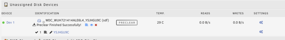

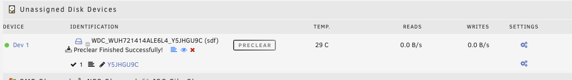

  2. How do I spin down an unassigned HDD? I've pre cleared this drive, and I want to keep it in the server as a ready spare. How do I spin it down? The green dot to the left isn't clickable. I don't think it's mounted -- it has no mountable filesystem because it's just been pre cleared. I can't seem to find any spin down settings anywhere applying to this drive. I need to keep it connected so I can swap it in if necessary from the road, but don't have any need for it to be spinning, accruing Power On Hours, and wasting electricity.
