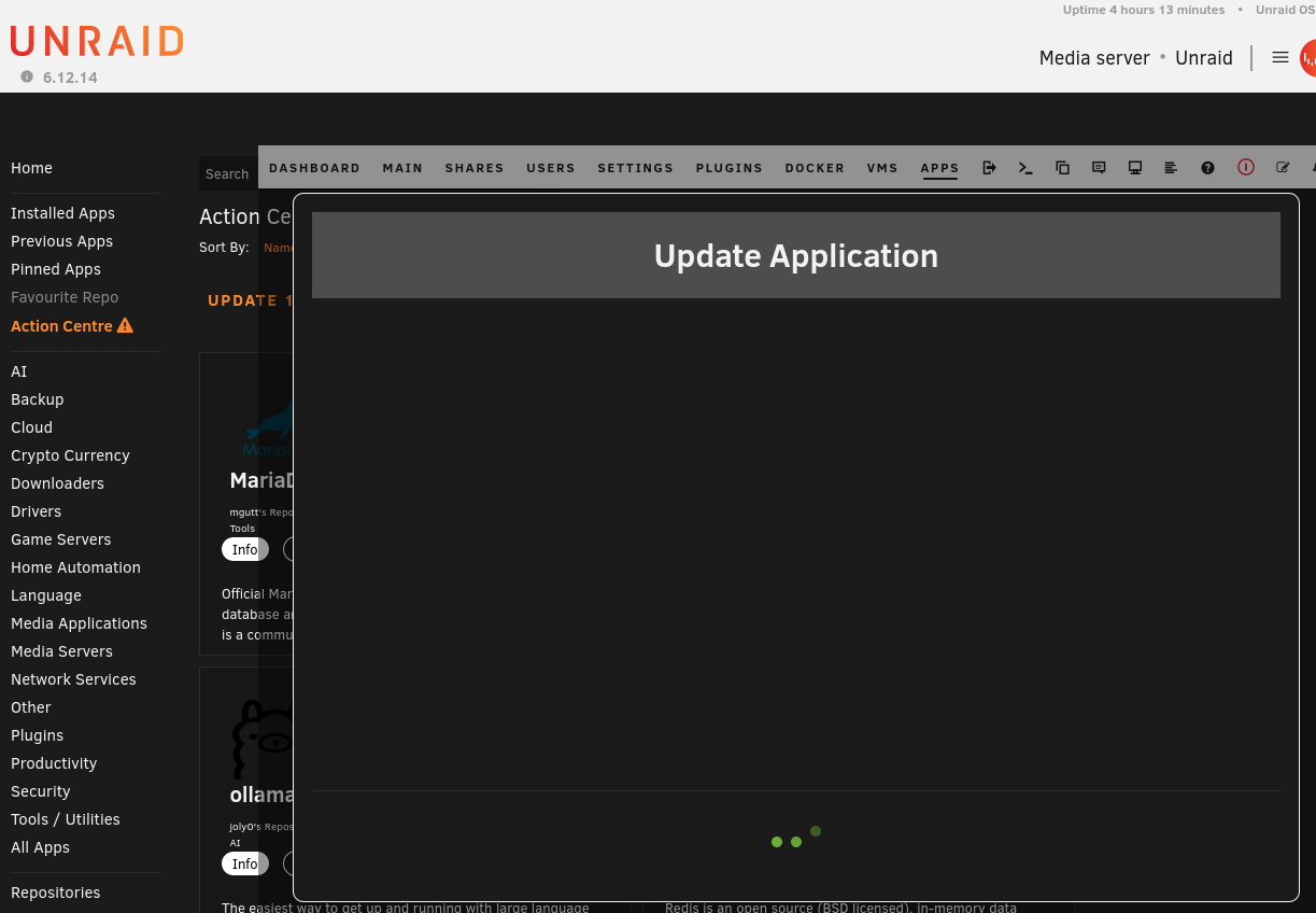

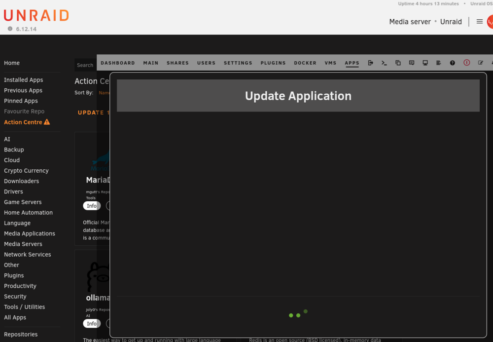

Hi @Squid, since updating to unraid v 6.12.14, using CA version 2924.11.29 - if i am updating any application via "Action centre" i get the usual modal with headline "Update Application" but inside it there is no text, nothing, no progess/log is visible during updates. I did already restart the server, tried to clear browser caches as well, network console/F12 dev tools shows now errors. How to fix this?
