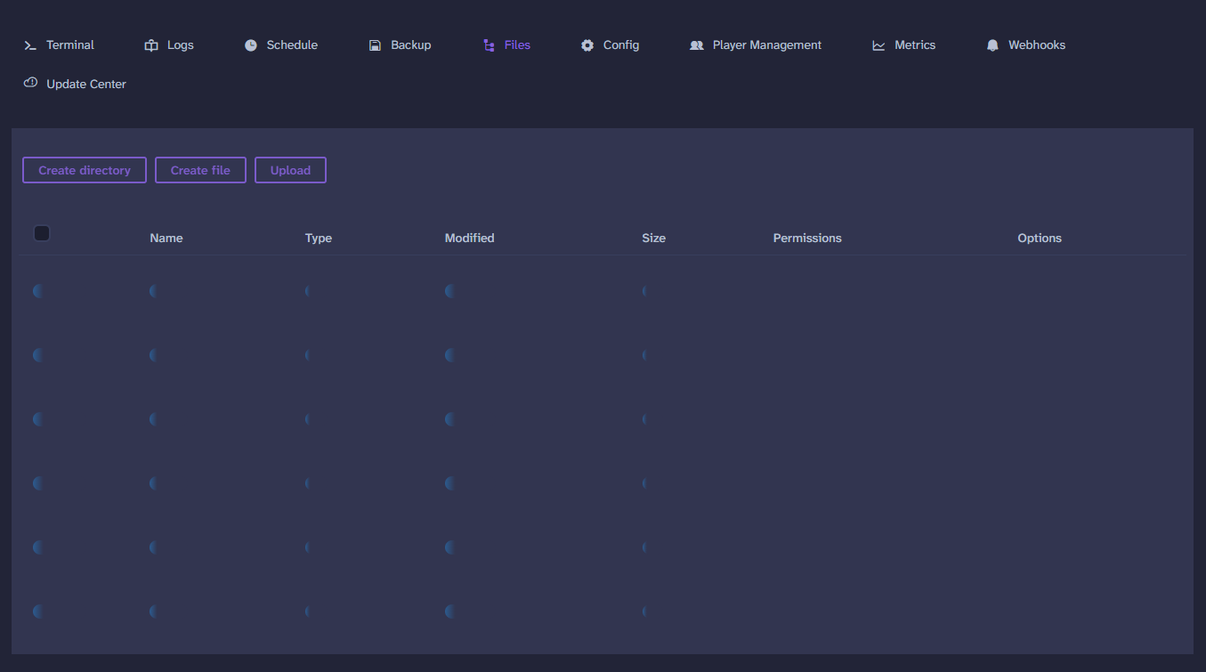

  4. Hello, I'm testing this docker container to maybe move from AMP. I do folder and file permissions set, but the Files tab for the Minecraft server just never loads. Am I missing something? I don't mind uploading from unraid into the plugins folder but would be nice to be able to do it from the Files section too. It seems to do the same thing from local IP and from reverse proxy (pangolin, cloudflare). Any help would be great.

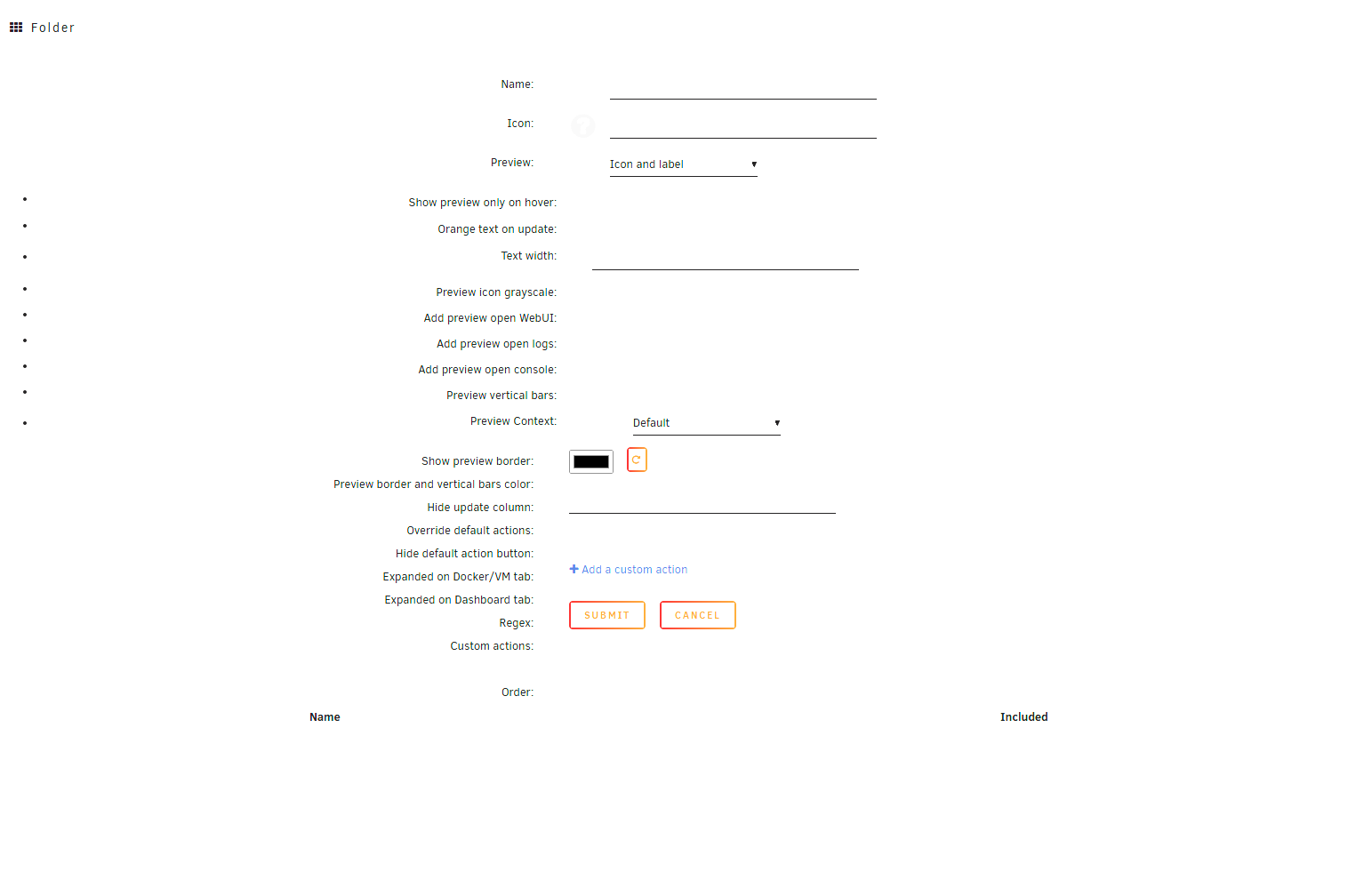

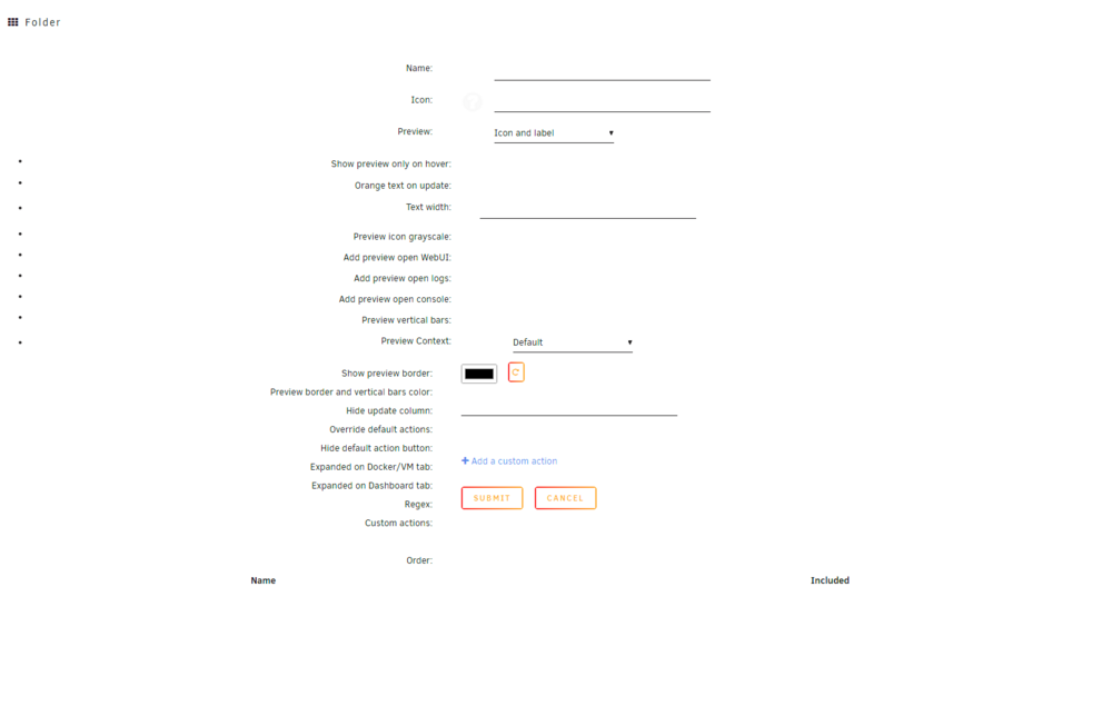

  7. I just installed this on Unraid 7 and this is what I get when I click Add Folder for docker containers. I don't see the toggle switches like in other screen shots or the dockers listed in it. Clicking submit refreshes this page doesn't create anything. Not sure what's happening. First time using this plugin.

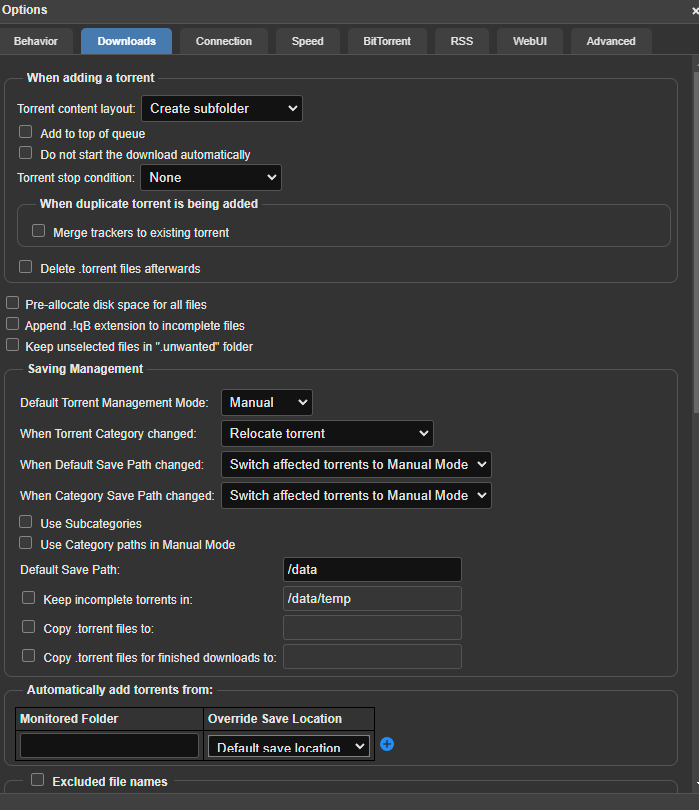

  12. I just ran a test by download a tv series, and it stayed stalled for about 6minutes, then the seasons that hit 5-6 minutes started downloading, the ones listed as <1minute or 1 minute stayed stalled, and as soon as they turned to 6 minutes Time Active they started to download. Strange behaviour but all seems to be working again. Also, yesterday the GUI took a really long time(> 5minutes) to get access to it, and now I get instant access once the container is started. Guess my issue is resolved. Might have all been due to unraid 7.0/the CA update.
  13. Seems to be random, sometimes after a restart torrents stay in a Stalled state, and other times it only stalls for a few minutes and then starts. The one I just downloaded started as stalled and now downloaded. The only difference from yesterdays issues is I installed the latest CA update from yesterdays initial unraid 7.0 fix: 2025.01.11 to todays: 2025.01.12. Ill keep an eye on it, and if I see it stalled with a bunch of torrents then Ill post updated logs.
  14. For some reason even though I disabled the VPN last night, it was on again when I just checked. Not sure why. Just tried to download another torrent and it Stalled right away. zer0ish_supervisord.log zer0ish_qbit_dockerrun.txt
  15. I was simply stating that for me, the issue disappeared once I disabled the VPN part of the docker. The container does start with VPN on, and using WG command shows it's getting the handshake, every torrent goes in Stalled state though. Turned off VPN and all is good. For some reason even though I disabled the VPN last night, it was on again when I just checked. Not sure why. Just tried to download another torrent and it Stalled right away. zer0ish_supervisord.log zer0ish_qbit_dockerrun.txt
