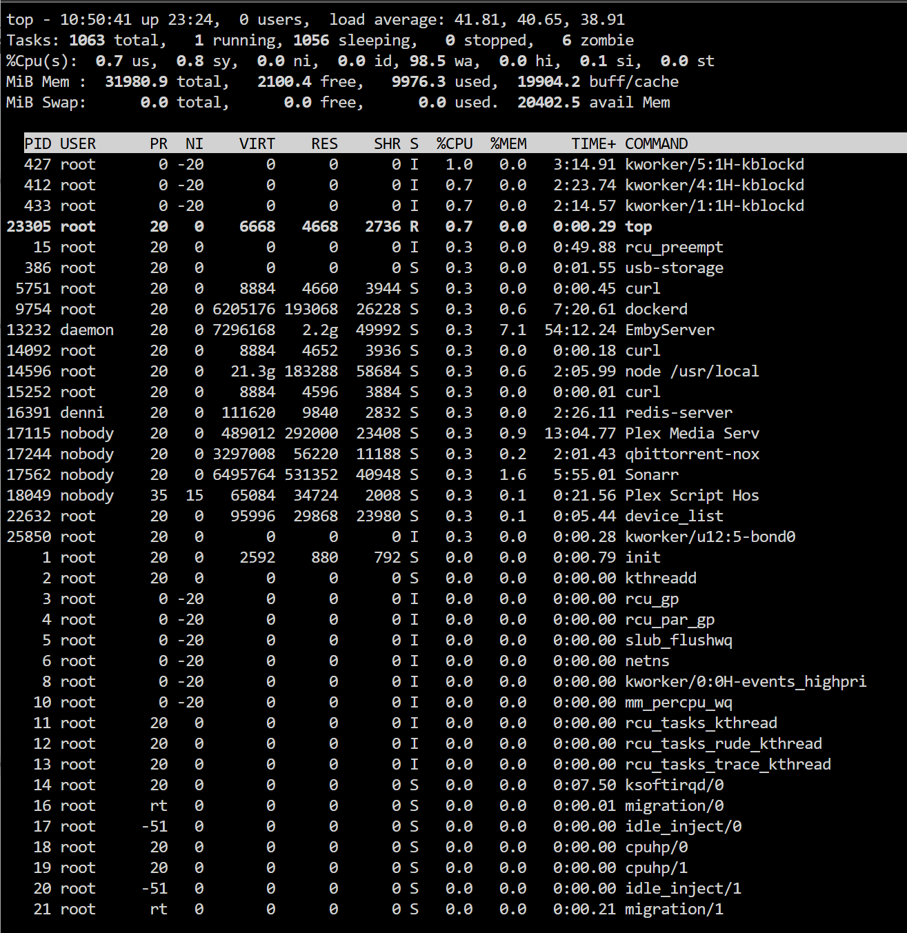

  1. It happened again last night/this morning. I am able to use some terminal commands such as top but not others such as reboot. I've attached a screenshot of top results in case that might point to something. I looked at the (updated) syslog and there doesn't seem to be anything related to Plex. Can you take a look at the latest syslog and see if you can spot anything? I'll disable Plex and see if that makes any difference though. Thanks. syslog-192.168.0.208.log
  2. I suspect my issue is related to Plex and transcoding. A couple of weeks ago I let a friend access my Plex (remotely) and this problem seems to coincide with when this started happening (it's happened 3 times so far in the last month or so) They watch on an iPad that requires transcoding for some media. I could be completely wrong but that is the only thing that's really changed. I turned on Syslog server and things were fine for a couple of days but then this morning I couldn't access Plex on my local network and the UnRaid GUI was showing all CPUs pinned at 100% and was unresponsive (I had left a browser tab open). I suspect this is the pertinent error in the log: Mar 21 04:07:35 NAS kernel: Plex Media Scan[20791]: segfault at 0 ip 0000148e546fdeed sp 00007fffa7536610 error 4 in libavcodec.so.59[148e54587000+3e1000] likely on CPU 4 (core 4, socket 0) Mar 21 04:07:35 NAS kernel: Code: 41 56 41 54 53 0f 57 c0 0f 11 46 20 0f 11 46 10 0f 11 06 48 c7 46 30 00 00 00 00 8b 6f 10 48 8b 17 89 e9 48 89 e8 48 c1 e8 03 <8b> 04 02 0f c8 80 e1 07 d3 e0 8d 4d 10 8b 57 18 c1 e8 f0 39 ca 0f Mar 21 04:09:15 NAS kernel: Plex Transcoder[21501]: segfault at 0 ip 000014ea52efdeed sp 00007ffd32840310 error 4 in libavcodec.so.59[14ea52d87000+3e1000] likely on CPU 4 (core 4, socket 0) Mar 21 04:09:15 NAS kernel: Code: 41 56 41 54 53 0f 57 c0 0f 11 46 20 0f 11 46 10 0f 11 06 48 c7 46 30 00 00 00 00 8b 6f 10 48 8b 17 89 e9 48 89 e8 48 c1 e8 03 <8b> 04 02 0f c8 80 e1 07 d3 e0 8d 4d 10 8b 57 18 c1 e8 f0 39 ca 0f I could be completely wrong as I am not knowledgeable about this sort of thing. I have attached a diagnostics and the syslog hoping to get some help with this and possibly remedy this issue. Any help, or advice is much appreciated. nas-diagnostics-20250322-1134.zip syslog-192.168.0.208.log
