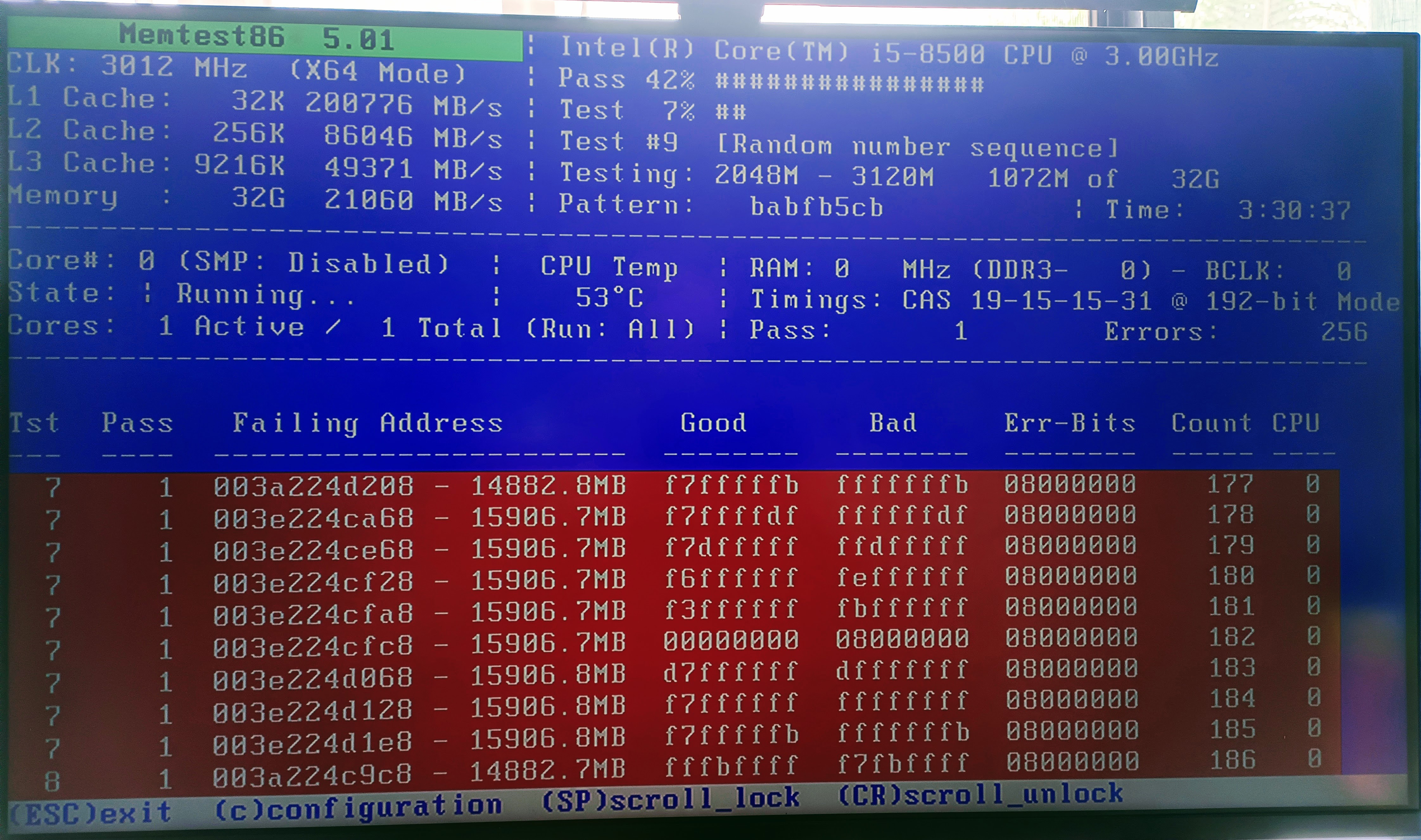

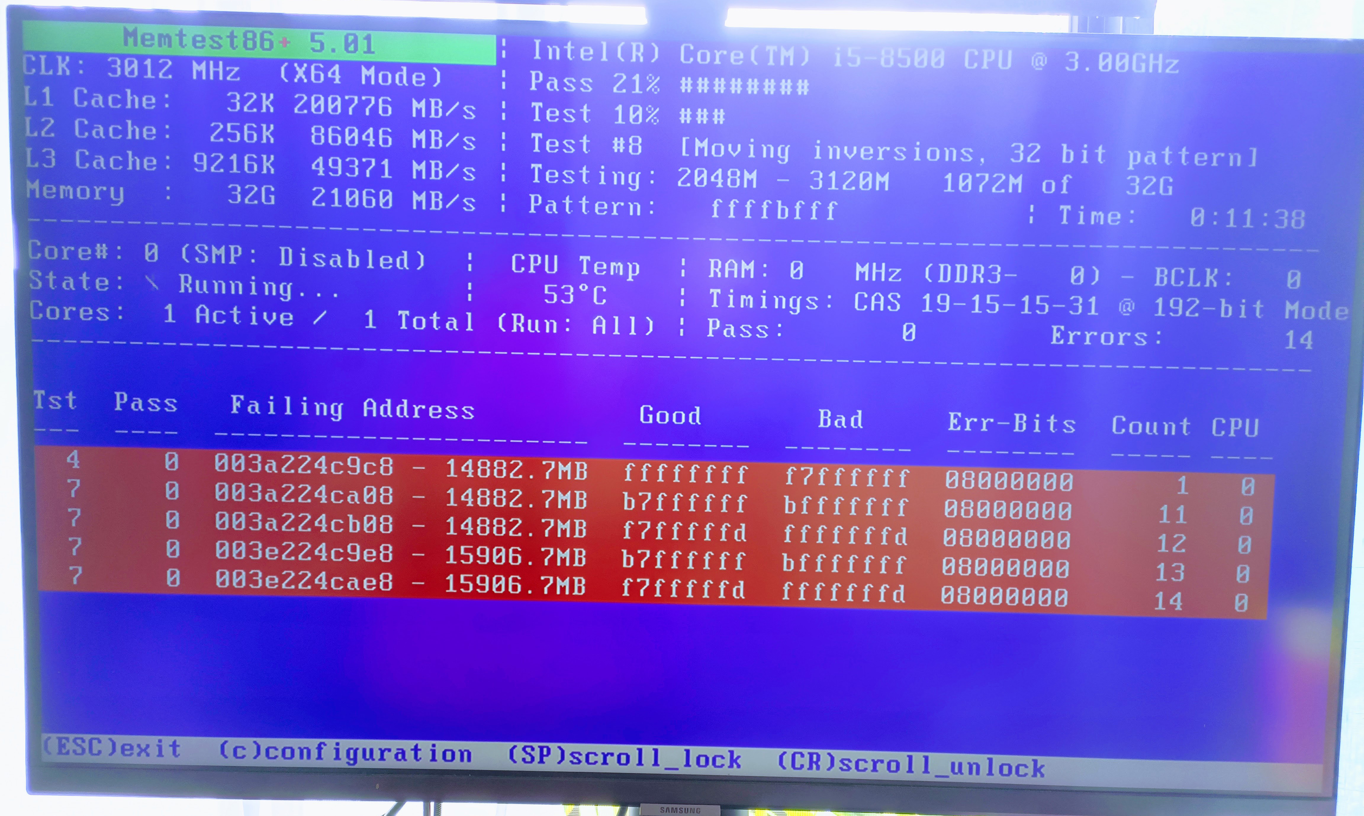

UPDATE 1: I started testing my memory one stick at a time (in slot 1) 2 sticks passed (zero errors after 1 hour+) and the 2 other sticks (tested separately and repeatedly) would not let my system POST. So I am going to run my system with the two "good" sticks and see how stable everything is. I'll update this thread either way. Thanks for the help so far! UPDATE 2: It's been over a week and everything has been stable. Once again, thanks for the help figuring this out!

Thanks for the reply. What would be a good amount of time to run each memtest for each stick/slot? (I have 4 sticks/slots)

Thanks for the reply, I am running Memtest and getting plenty of errors (see attached images). Pardon my ignorance but let me ask... are these types of errors solely due to the ram itself or could it be motherboard related? Should I just replace this memory? It looks to me like more than one stick has errors, does memory "go bad" like this in multiple sticks at the same time? What might cause multiple (or singular) failures like this, in other words what should I do to fix this and hopefully have it not happen again in another 2 years?
