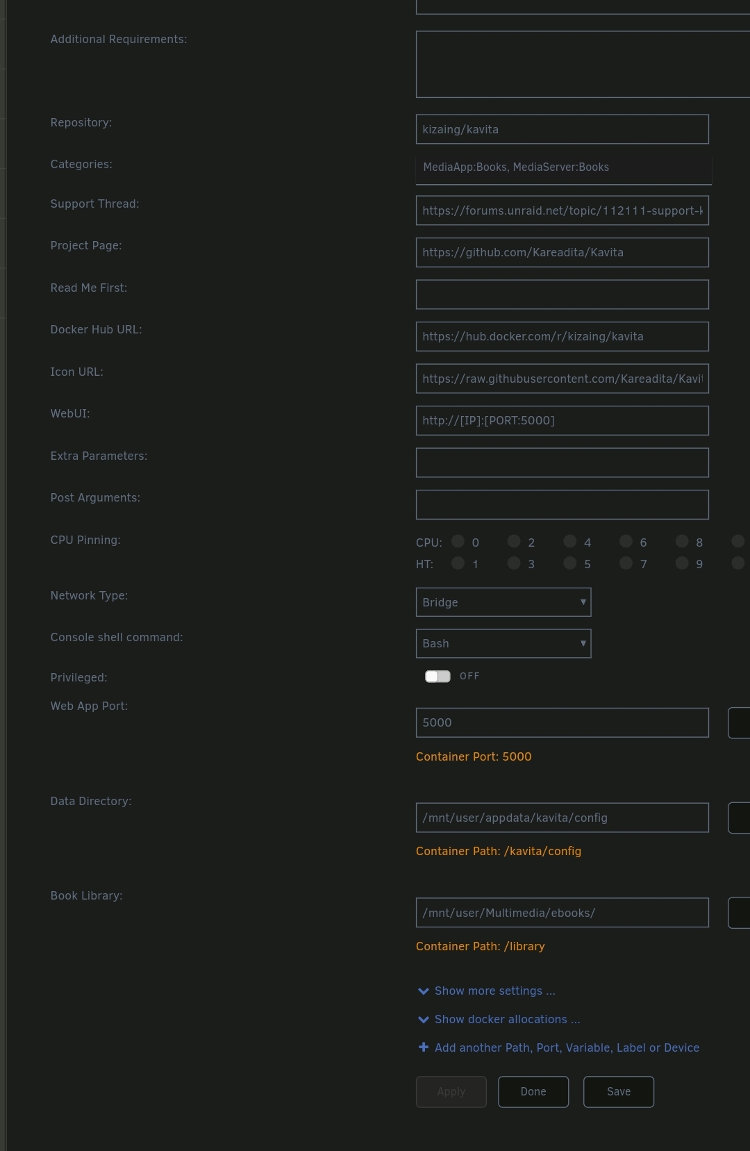

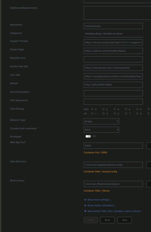

  2. I think, I got it. I need folders. Currently all data in one folder. No action required from your side. I have to check this first It works now. Minimum one folder is required in the root
  3. Good day to you. I'm new with unraid and installed the docker. I understood anything wrong. Is the script also required when the docker will installed via App Center? I installed it via App Center and set the folders via edit Docker. WebGui works fine and I see my Folder Library in the Web. I created a Library but scanning don't found anything. Could you please try to help Thanks a lot
