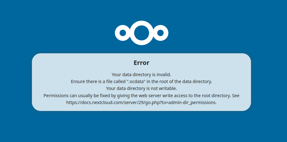

[Support] knex666 - Nextcloud
Same issue for me. I have re-downloaded the docker image and started working again
Solved. So data folder has to be nobody:users And despite what they are saying online the cron shouldnt be run as www-data user. I just removed the --user flag and it works: this is my cron script #!/bin/bash docker exec Nextcloud php /var/www/html/cron.php
../ is /mnt/user/Private ./ is /mnt/user/Private/nextcloud nextcloud dir is already 770 root@TEVENAS:/mnt/user/Private# stat -c "%a" ./nextcloud 770 Ok this might not be obvious for me I'm not really good with the understanding of linux permissions: if the Private dir is not owned by 33:33 will it not work? /mnt/user is owned by nobody:users so I guess it should work, everything else works on my system.
Hi @Kilrah thanks for your answer. Are you sure my permission on nextcloud is not 770? For me it seems to be. Here I redo everything from scratch: root@TEVENAS:~# getent passwd sshd #Making sure sshd:sshd is the 33:33 id user on my unraid sshd:x:33:33:sshd:/:/bin/false root@TEVENAS:~# chown -R sshd:sshd /mnt/user/Private/nextcloud #Make sshd:sshd the owener of nextcloud folder recursively root@TEVENAS:~# chmod -R 770 /mnt/user/Private/nextcloud #Chmod 770 the entire folder and its contents recursively root@TEVENAS:~# cd /mnt/user/Private root@TEVENAS:/mnt/user/Private# ls -ld ./nextcloud #Check folder permission and owner, seems to be correct drwxrwx--- 1 sshd sshd 142 May 6 13:20 ./nextcloud/ root@TEVENAS:/mnt/user/Private# cd nextcloud root@TEVENAS:/mnt/user/Private/nextcloud# ls -l -a #List all the stuff to see its users and permissions total 1108 drwxrwx--- 1 sshd sshd 142 May 6 13:20 ./ drwxrwx--- 1 daninet users 6 May 7 12:46 ../ -rwxrwx--- 1 sshd sshd 542 May 6 13:06 .htaccess* -rwxrwx--- 1 sshd sshd 0 May 6 13:06 .ocdata* drwxrwx--- 1 sshd sshd 130 May 6 15:33 appdata_ock2dw0o714w/ drwxrwx--- 1 sshd sshd 76 May 7 09:09 daninet/ drwxrwx--- 1 sshd sshd 27 May 6 13:20 files_external/ -rwxrwx--- 1 sshd sshd 0 May 6 13:06 index.html* -rwxrwx--- 1 sshd sshd 1129157 May 9 21:00 nextcloud.log* root@TEVENAS:/mnt/user/Private/nextcloud# cd .. root@TEVENAS:/mnt/user/Private# stat -c "%a" ./nextcloud #check chmod as a numeric value 770 After all this i still have this on my start screen:
Hi! I'm having trouble with the user data folder. I could not found solution so far. These are my allocations: /var/www/html /mnt/user/appdata/nextcloud/html /var/www/html /custom_apps/mnt/user/appdata/nextcloud/apps /var/www/html/config /mnt/user/appdata/nextcloud/config /var/www/html/data /mnt/user/Private/nextcloud/ Inside the container there is a user called www-data:www-data (33:33) running the cron jobs. In my unraid the 33:33 user is sshd:sshd I made the owner of the dir /mnt/user/Private/nextcloud/ the sshd user and the cron job suggested me to make the permission 770. I did. If I make the permission 770 this is what I get on the frontpage (and the cronjob runs on the same error saying it has no permission): The data directory is invalid. Ensure that there is a ".ocdata" file in the root of the data directory. The data directory is not writable. Permissions can typically be fixed by giving the web server write access to the root directory. See https://docs.nextcloud.com/server/29/go.php?to=admin-dir_permissions. Ok so 770 is not enough? Make it 777. Then I get this: Your data directory is readable by other people. Please change the permissions to 0770 so that the directory cannot be listed by other people. Welp.. maybe 775? The data directory is not writable. Permissions can typically be fixed by granting write access to the web server on the root directory. See https://docs.nextcloud.com/server/29/go.php?to=admin-dir_permissions. This is a bit comical.. :)) where is the issue now? root@TEVENAS:/mnt/user/Private/nextcloud# ls -ld drwxrwx--- 1 sshd sshd 142 May 6 13:20 ./ root@TEVENAS:/mnt/user/Private/nextcloud# ls -l -a total 1104 drwxrwx--- 1 sshd sshd 142 May 6 13:20 ./ drwxrwx--- 1 nobody users 18 May 7 12:46 ../ -rwxrwx--- 1 sshd sshd 542 May 6 13:06 .htaccess* -rwxrwxrwx 1 sshd sshd 0 May 6 13:06 .ocdata* drwxrwx--- 1 sshd sshd 130 May 6 15:33 appdata_ock2dw0o714w/ drwxrwx--- 1 sshd sshd 76 May 7 09:09 daninet/ drwxrwx--- 1 sshd sshd 27 May 6 13:20 files_external/ -rwxrwx--- 1 sshd sshd 0 May 6 13:06 index.html* -rwxrwx--- 1 sshd sshd 1123780 May 9 20:50 nextcloud.log*

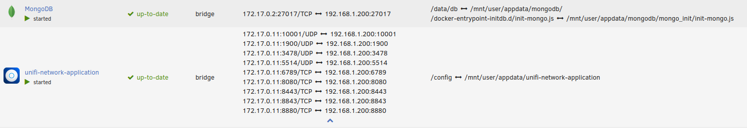

[Support] Linuxserver.io - Unifi-Controller
working, thanks๐
I'm having trouble with the setup and not sure why. I have tried to follow the instructions. The unifi web interface is not reachable. These are the steps I took: 1. backup the deprecated ls.io unifi container. 2. Install mongodb with the init script init-mongo.js db.getSiblingDB("unifi").createUser({user: "daninet", pwd: "pwd", roles: [{role: "dbOwner", db: "unifi"}]}); db.getSiblingDB("unifi_stat").createUser({user: "daninet", pwd: "pwd", roles: [{role: "dbOwner", db: "unifi_stat"}]}); docker run docker run -d --name='MongoDB' --net='bridge' -e TZ="Europe/Budapest" -e HOST_OS="Unraid" -e HOST_HOSTNAME="TEVENAS" -e HOST_CONTAINERNAME="MongoDB" -l net.unraid.docker.managed=dockerman -l net.unraid.docker.icon='https://raw.githubusercontent.com/jason-bean/docker-templates/master/jasonbean-repo/mongo.sh-600x600.png' -p '27017:27017/tcp' -v '/mnt/user/appdata/mongodb/':'/data/db':'rw' -v '/mnt/user/appdata/mongodb/mongo_init/init-mongo.js':'/docker-entrypoint-initdb.d/init-mongo.js':'rw' 'mongo' 53b1599bcd21ae9bca1461eb19327e5e4a4952ee6df196f2025fe28c26cd325a Then setup the new unifi container: docker run -d --name='unifi-network-application' --net='bridge' -e TZ="Europe/Budapest" -e HOST_OS="Unraid" -e HOST_HOSTNAME="TEVENAS" -e HOST_CONTAINERNAME="unifi-network-application" -e 'MONGO_USER'='daninet' -e 'MONGO_PASS'='pwd' -e 'MONGO_HOST'='unifi-db' -e 'MONGO_PORT'='27017' -e 'MONGO_DBNAME'='unifi' -e 'MEM_LIMIT'='1024' -e 'MEM_STARTUP'='1024' -e 'MONGO_TLS'='' -e 'MONGO_AUTHSOURCE'='' -e 'PUID'='99' -e 'PGID'='100' -e 'UMASK'='022' -l net.unraid.docker.managed=dockerman -l net.unraid.docker.webui='https://192.168.1.200:8443/' -l net.unraid.docker.icon='https://raw.githubusercontent.com/linuxserver/docker-templates/master/linuxserver.io/img/unifi-network-application-icon.png' -p '8443:8443/tcp' -p '3478:3478/udp' -p '10001:10001/udp' -p '8080:8080/tcp' -p '1900:1900/udp' -p '8843:8843/tcp' -p '8880:8880/tcp' -p '6789:6789/tcp' -p '5514:5514/udp' -v '/mnt/user/appdata/unifi-network-application':'/config':'rw' 'lscr.io/linuxserver/unifi-network-application' aaa2d5762f3f99c50def5ef5a419972aba766006c1351c58382cfe57347f8bf5 Now the container log is telling me the following: *** Waiting for MONGO_HOST unifi-db to be reachable. *** *** Defined MONGO_HOST unifi-db is not reachable, cannot proceed. *** What is exactly unifi-db? I did not define it anywhere but the documentation says use this. They are both on the same subnet. My other DBs are working on this subnet.

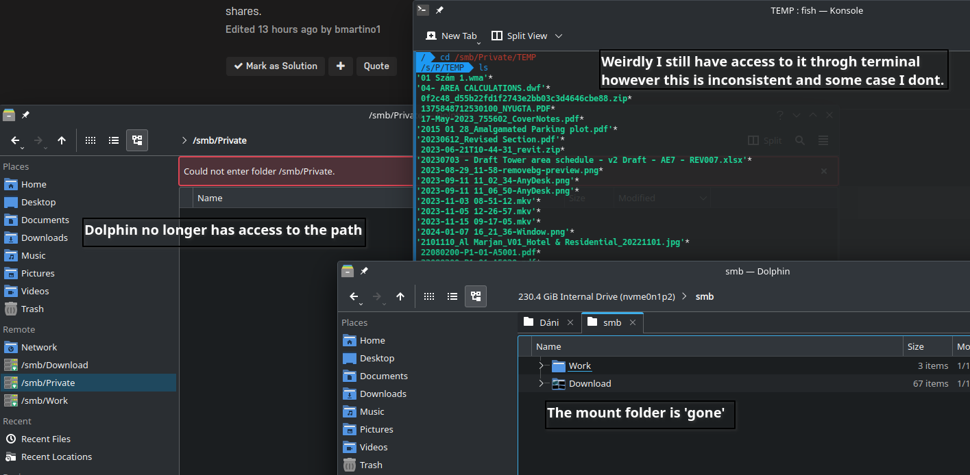

Repeated trouble mounting unraid shares in linux systems
Hi, Thank you for your replies. I think I have cracked it and it is related to inodes and unraid's cache. The file inode changes when unraid moves the file from cache to hdd and the share unmounts. Adding noserverino flag to the smb mount resolves the problem. This is the proper config for unraid cached shares with fstab: //server_address/share_name /mount/path cifs credentials=/home/username/.smbcredentials,uid=1000,gid=1000,vers=3.0,noserverino,nounix,_netdev 0 0 Thank you for all the help it was really useful and have learnt a lot.
Thank you for the detailed answer. There is a lot to unpack and I will dig myself through the settings. As for some of your questions: I initially thought xdg-desktop-portal is somehow responsible (the window that lets you pick or save a file). Very often the following happens: I download a file (any file really, pdf, image etc) from the internet, save the file to my share with the xdg-desktop-portal and when I open dolphin the share is no longer reachable. Edit: I'm really happy now, I was able to trigger it with xdg-desktop-portal and record it also. See video attached. This is an SMB mount. This also happens if I just let it be for an hour. 2024-01-16_10-54-59.mkv
