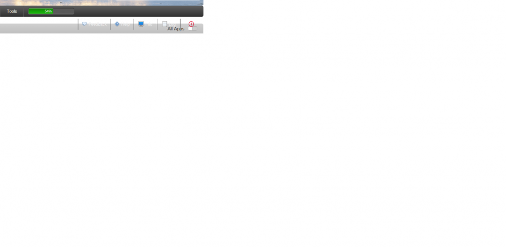

System Buttons On my Elite TV Server its display behaviour is fine, however on my Stacker Media Server its behavious is odd, meaning that the buttons are located below the main menu bar, with a white background on certain Tab(-Subtabs). Both using Windows explorer and both with Tabbed Views. This happens on the Tab(-Subtab): Dashboard, Shares-User Shares, Settings, Plugins-Installed Plugins, Apps-Installed Apps, Stats-Disk Stats and Tools. It not a real problem; just annoying (to the nice layouts).
