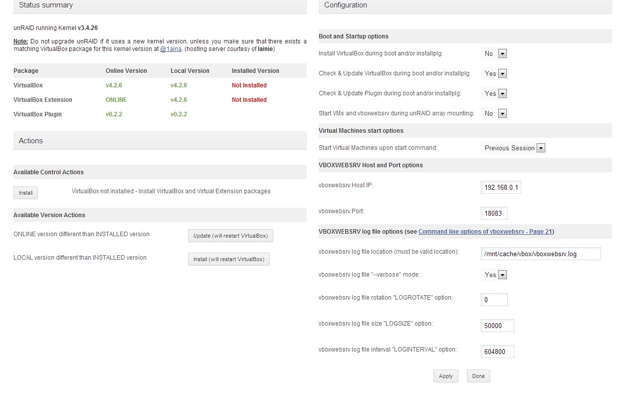

The WEBUI is divided into 3 parts:
1. Status Summary - Shows all versions of packages and plugin and there status (installed/local/online).
2. Actions - Shows all possible actions available to the user depending on the status of the user's server.
  - Start/Stop/Restart vboxwebsrv and Virtual Machines.
  - Download/Install/Update packages and Plugin.
  - Start and Savestate of individual Virtual Machines.
3. Configuration - Change settings of the plugin.
Configuration Notes:
1. Boot and Startup options - Change what happens during boot or installplg.
2. Virtual Machines start options - Change what Virtual Machines to start once START command is given.
3. VBOXWEBSRV Host and Port options - Change Host and IP settings for vboxwebsrv
4. VBOXWEBSRV log file options - Change the vboxwebsrv log file options.
  - It is important to set the log file location accurately otherwise vboxwebsrv will not run properly.
  - You may want to place the log file outside of your flash drive.

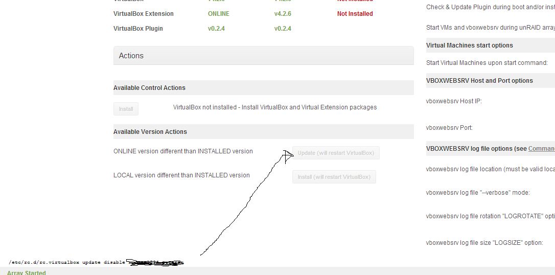

  • Looks like issue with 5.1.20 extension pack.  I see a brief question something like do I agree to these terms or whatever with a y/n? along the bottom of the GUI before a message saying install failed
Nothing get installed ? see images atatched
Shall it be 127.0.0.1 in the GUI and in the config.php ? someone told med to change it to IP for the server, in my case 192.168.0.199
Is there any changes I need to do more in config.php fpr phpvirtualbox
the plugin have DL following files
Oracle_VM_VirtualBox_Extension_Pack-4.2.6.vbox-extpack
vbox-4.2.6-unRAID-3.4.26.tgz
And it stated that the installed version differ ? before I installed the plugin, no installation of vbox existed.

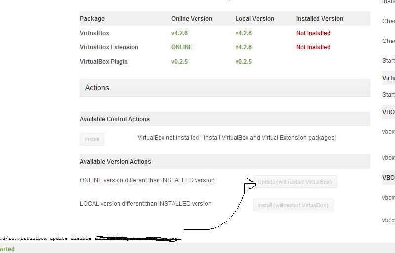

On RC10 now, but the plugin want install , same as was before ..... ?
//Peter
Please post screenshot and syslog.

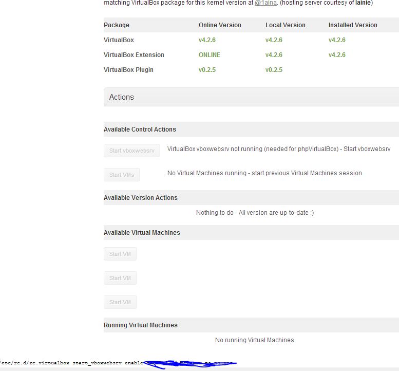

I saw this now on the GUI !!
/etc/rc.d/rc.virtualbox update disable xxxxxx yyyyyy
Where x & y is my login details for openvpn !!!!
Strange !?
//Peter
Strange !?
//Peter
Please add screenshot - I need to see exactly what the status is (what the plugin sees).
without the XXXXXXXX and YYYYYYY ofcourse ;)
Still reading my variables from openvpn plugin ?
It's very strange
//Peter
Believe me I am not doing any such thing - the source code is open for checking if you wish.
I also had this problem (unrelated parameters shown in command line - progressbar) and I am not running openvpn.
I think it was a from naming issue in the WEBUI code but I am not sure - I don't have the problem anymore.
Can you try and restart your server?
I can check from the prompt,
What is the command to manually install and start this?
Its' very strange :-)
//Peter

looks my vbox-4.2.6-unRAID-3.4.24 was corrupt, removed it and DL new.....
How can I check the validity of a downloaded file to check after download?
If it is possible I will add it to the code.
Its' installing fine now from prompt, but from web GUI it still looks still strange, when I click on restart, I see my variables from openvpn
I will rebot later ......
//Peter
Calc an MD5 sum.  Use /usr/bin/md5sum to compare against a known good hash.

I'm on Rc10 now, still have issue with
VirtualBox error: The object functionality is limited (0x80070005)
I got this when clicking on the machine in attached image
And I'm running with an untouched config.php
Foe a week ago this was working ...
I have removed some plugin, but no luck.
Anyone that know a solution for this? if some on more have it working, can you tell me what other plugin you are using and where you have store the phpvirtualbox
Can this belong to some settings in SF web server ? But I have more thing running on the web server that works (newznab, spotweb , owncloud, ajaxplorer and phpmyadmin)
//Peter
