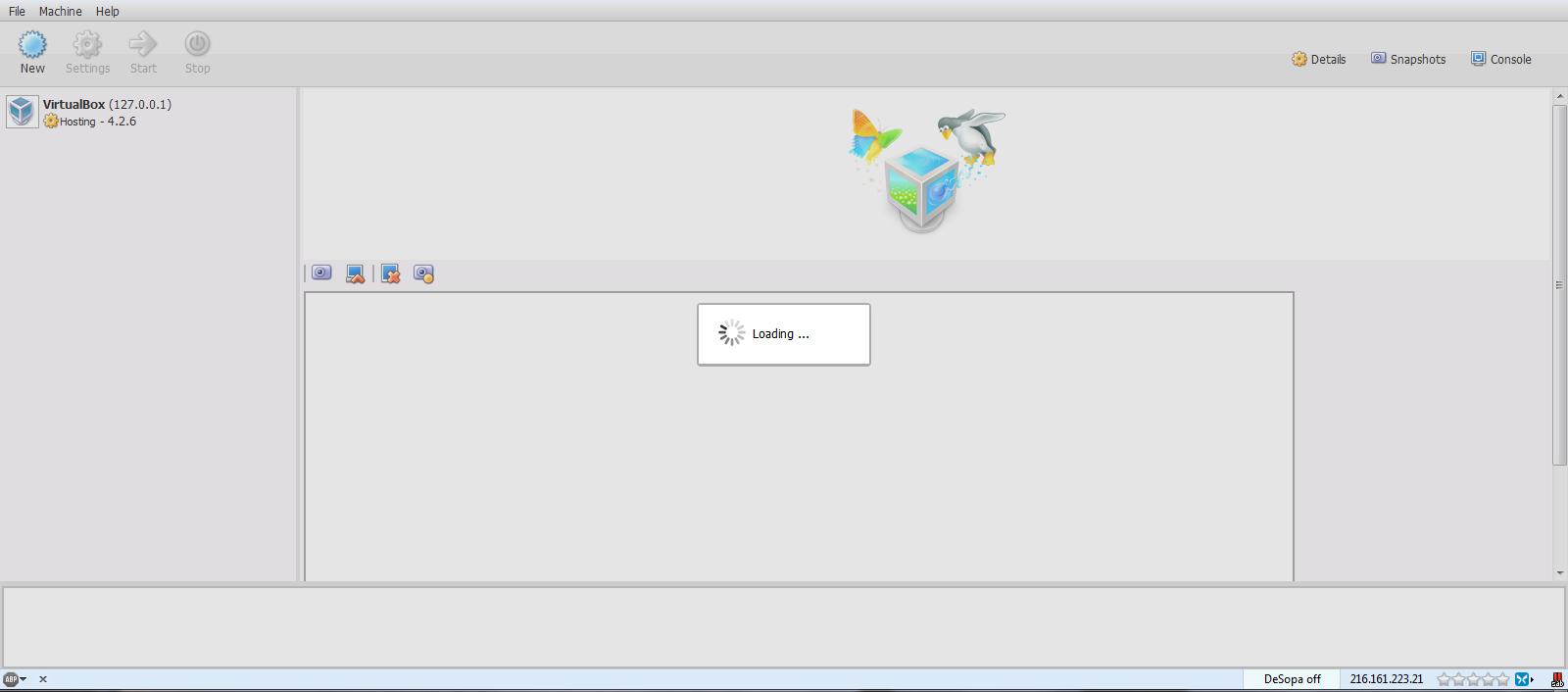

now if I can just get phpvirtualbox up and running - i get a error message with a loading box on top of it and cant see what its hollering about

What exactly did you do to install phpVirtualBox?
extracted it into my webserver docs area - edited the config.php and put it my root login/pass and double checked the port

error text is:
Method 'ns1:ISystemProperties_getMaxVDISize' not implemeted: method name or namespace not recognized
Myk
ok, think i got it figured out - version of phpvirtualbox I grabed was for 3.x of VB not the 4.x series - fixing - will post back
Myk
ok, there is where i am stuck now :(
Myk
hm... must be a firefox issue and it comes up fine in chrome.... :(
