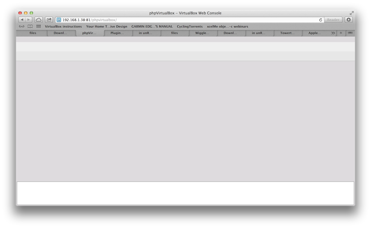

Hi All
I have been messing around with this for ages and thought it might be easier to post. Seems to have the SF webserver installed and Virtualbox installed but dont have the guest additions (not sure if I need at this point).
As you can see in the attached screenshot, I can get to the phpvirtualbox folder but there is nothing there. Can anyone let me know what I am doing wrong please?
Show us your SF Web Server settings page.
Where did you extract phpvirtualbox? Show full path.
What is your server's IP?
