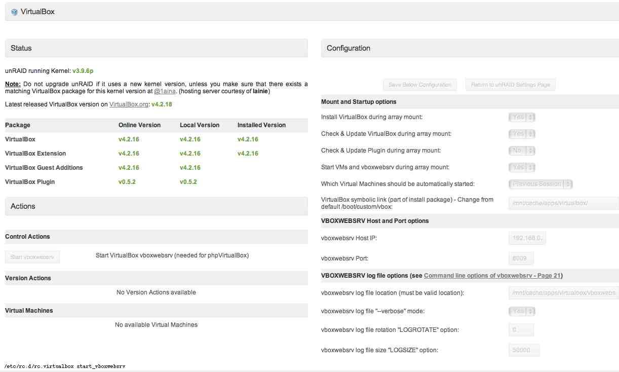

EDIT** If i refresh the page "control actions" gives me the options to restart and stop, which would suggest it is running.
EDIT** I just noticed the link in your sig and there is some guidance on there....i'll give that a whirl and see how far i get.

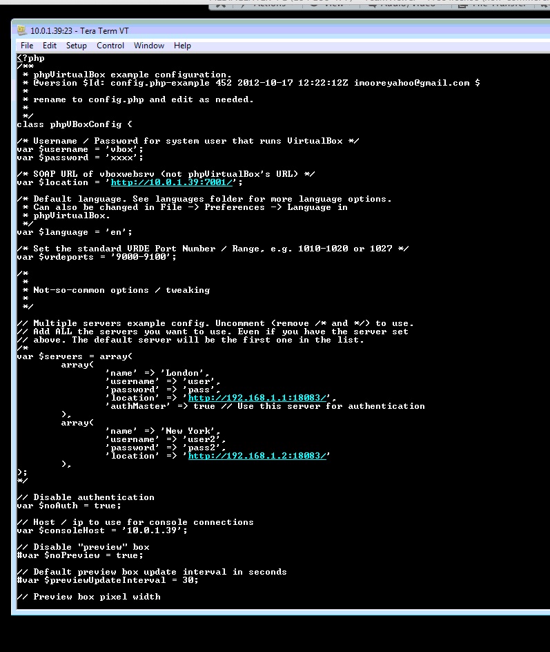

Its now working, also running phpvirtualbox via lighttpd from the simpleFeatures web server plugin.
had to tweak config.php
/* Username / Password for system user that runs VirtualBox */
var $username = 'vbox';
var $password = 'xxxx';
/* SOAP URL of vboxwebsrv (not phpVirtualBox's URL) */
var $location = 'http://192.168.1.254:18083/';
// Disable authentication
var $noAuth = true;
// Host / ip to use for console connections
var $consoleHost = 'tegunux';
In the end I beleive the big issue was connection problems with the hosted versions of the virtualbox builds on the http://vbox.a1aina.com/ site... could just be temporary, but the plugin / settings menu couldn't grab the right files so the install wouldn't complete.  This would be a manual install if you can get the packages downloaded to the plugin folder

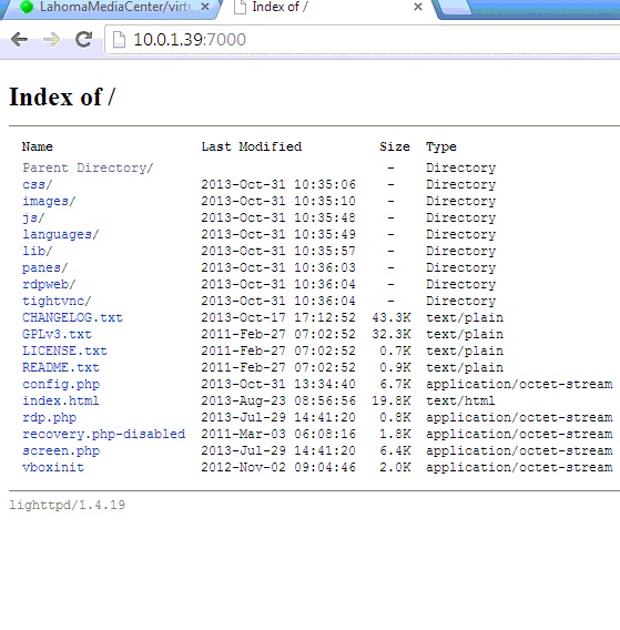

Need some help, i forgo the SF install, i dont like to reboot the server alot. I need help with minor tweaks to get phpvirtual to work i feel im really close.
Pictures are attached for reference.
Background info
DL the plg from here install virtual box and downloaded all the updates (running on V5 stable)
I DL lighttpd from unmenu installed it and configure it to port 7000, works fine see picture.
DL phpvirtualbox from git hub choose the versin 4.3 (which is what i have) extracted it to a folder on my cache drive named (www same folder that lighttpd is configure to use as the web server). renamed config.php and edited a few lines. see picture
On vbox i used the ip of the tower and port 7001, which is also in the config.php. See picture
When i call the webpage for phpvirtualbox i get prompted for a user name and password. If you notice that on my config.php i un-commented the not auth variable. (side note i do have a password to get to the main unraid webpage, in other words 'root" has a password)
So i have tried the username and password in the PHP file no luck, it keep prompting for user/pass. I read the instructions for phpvirtualbox and used "admin' and password "admin" this yielded a blank webpage.
Using unraid 'root' login also yielded the same outcome of a blank webpage.
So i know i must be close, i just know that i missed a step.
