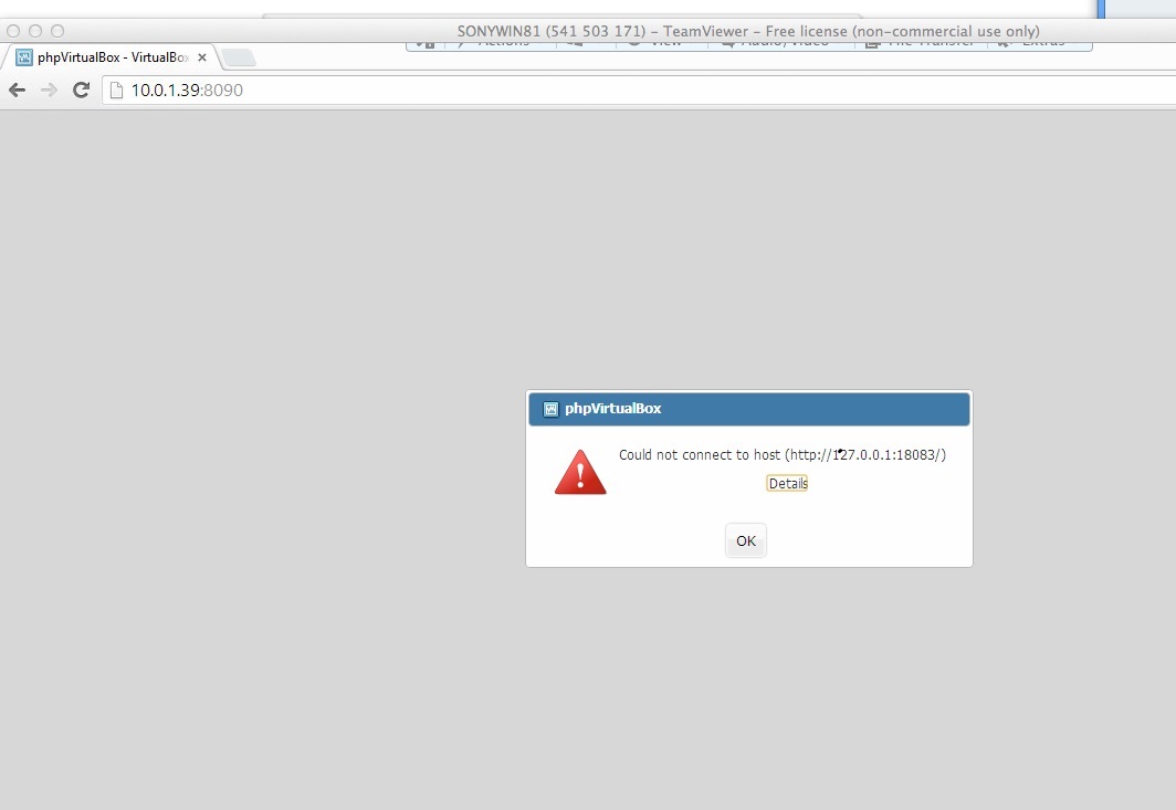

If I'm already using the SF webserver for an actual webserver is there a way for me to run php also?
I have manage to get SF web server install and on port 8090, got phpvirtualbox extracted to my root /www and configure the config.php and i thought i hit jack pot when the phpvirtualbox login pop up ( i left the login as admin admin) but i get the error "looks like there is no xml document" i;ve read the manuals but can seem to figure out why i get this. I will attach screen shots
Can anyone help a noob here I'm sure I got all the config correctly what I'm I missing?

Quote from: ijuarez on December 26, 2013, 10:27:31 AM
what do you have configured in your phpvirtualbox Config.php file?
should be:
var $location = 'http://127.0.0.1:18083
or
var $location = 'http://127.0.0.1:XXXX - XXXX being what port you have configured in the VirtualBox Plugin.

hmmm also having same issue.
should be:
or
if you go back a page or two you can see my config. I've tried both with the tower IP and 127  and port 8090 and 8090 in virtualbox
Sent from my SGH-I747 using Tapatalk
I dont think the webserver and virtualbox are suppose to use the same port... keep webserver with 8090 and virtualbox with 18083. then to access phpvirtualbox goto server ip:8090
checkout the pics that i posted on page 22 http://lime-technology.com/forum/index.php?topic=25715.msg277669#msg277669
and make sure that you have 127.0.01 in both the virtualbox page and config.php file... this part kicked my butt and was racking my head to get it going...
AHHHHH !!!!
thank  I will try that.
almost there..
that should be working - make sure that the vboxserv (virtual Box service) is running. I can start and stop from the plugin page, but others have had issues so they would start and stop from command line.
Yep did that from the command line. Try again and it gave me the same error I will probably reboot my system later and report back
I went back and looked at the rest of your virtualbox plugin settings, will you try something for me, change the "VirtualBox symbolic link (part of install package) - Change from default /boot/custom/vbox:" /boot/custom/vbox  to something else, i have mine set to /mnt/cache/vbox or something thats not on the flash drive, then restart vbox and webserver - retry login.
Did that I notice that on yours and change it to my cache drive
Here's another pic of all the screens with config.php - let me know what happens after the reboot.

I think I got everything loaded and installed properly but getting an error in phpvirtualbox
I get the login screen then get this error
could not connect to host
You said you fixed it by setting the log file properly. Can you elaborate? Do you mean that vboxwebsrv wasn't running because of the incorrect log file?
For me, it's running according to the log file, but I still get the error above. From my log:
00:00:00.016569 SQPmp    Socket connection successful: host = 127.0.0.1, port = 18083, master socket = 12

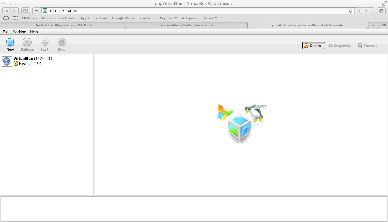

I reboot as I was telling nacat78, except for me, i had trouble downloading all the files that SF webserver requires. What i had to do was install a different version of open ssl and then it was able to download the dependencies and webserver worked. However all that went down the drain when I rebooted. So I'm back at square one. Im going to try Dynamix webGUI and see that goes.
anyhow i'm keeping an eye on this thread i really want to get vbox working so i can have a few vm running and get rid of computers that i dont need.
Sorry took a long time, got rid of SF and install Dynamix, man was that easy, got a web server going and configured the php for SOAP and webservbox is running. I am still having the error cannot connect to 127.0.0.1:18083
@ijuarez
Lets double check everything again in virtualbox and webserver config files
/boot/config/plugins/virtualbox/virtualbox.cfg
# VirtualBox plugin configuration
INSTALL_ON_BOOT="true"
UPGRADE_ON_BOOT="false"
UPGRADE_PLG_ON_BOOT="false"
START_ON_ARRAY_MOUNT="false"
START_VMS_ON_START="false"
VBOX_SYMLINK_LOCATION="/mnt/cache/vbox"
VBOXWEBSRV_HOST_IP="127.0.0.1"
VBOXWEBSRV_HOST_PORT="18083"
VBOXWEBSRV_LOGFILE="/boot/config/plugins/virtualbox/vboxwebsrv.log"
VBOXWEBSRV_VERBOSE="true"
VBOXWEBSRV_LOGROTATE="0"
VBOXWEBSRV_LOGSIZE="50000"
VBOXWEBSRV_LOGINTERVAL="604800"
/boot/config/plugins/dynamix/dynamix.web.server.cfg
service="1"
path="/mnt/cache/www"
port="8089"
phpError="On"
error="0"
access="0"
phpvirtualbox contents dumped/extracted to the root directory of the web server - in my case /mnt/cache/www
/mnt/cache/www/config.php
/* SOAP URL of vboxwebsrv (not phpVirtualBox's URL) */
var $location = 'http://127.0.0.1:18083/';
after everything is verified correct or changes made if needed enable webserver and restart virtualbox
for my setup I would access phpVirtualbox Web Console @ 192.168.0.145:8089
All most everything was good except for this
for some reason i had put that on the cache drive, i don't know why. Fixed that and boom
see below. know i just need to get my windows 7 vm and i am set.
nacat78 thank you very much for taking the time to put it in a simple way.
No worries ijuarez, that's why we have the forum - for collaboration and helping each other out. Dont forget to set your preferences for VM image storage - default location is on the thumb drive.
