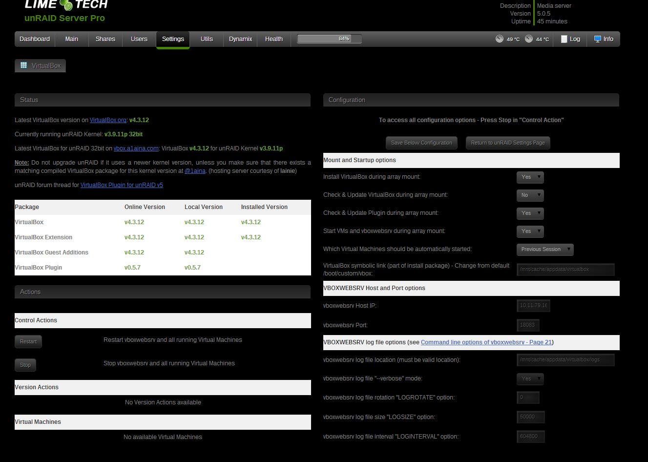

Ok, so my plugin wasn't setup all the way.  For the plugin, what should the IP address be?  I tried going to 127.0.0.1:18083  didn't work.  Changed the IP to my server address, still didn't work.

address is VirtualBox WEBUI should be 127.0.0.1:18083 as you stated.
What is the address set-up on your web server?
Ok, put it back to 127.... still doesn't work.

Please post a screenshot of the WEBUI when you have virtualbox running and some VMs are shown as in session and others aren't but are running.
