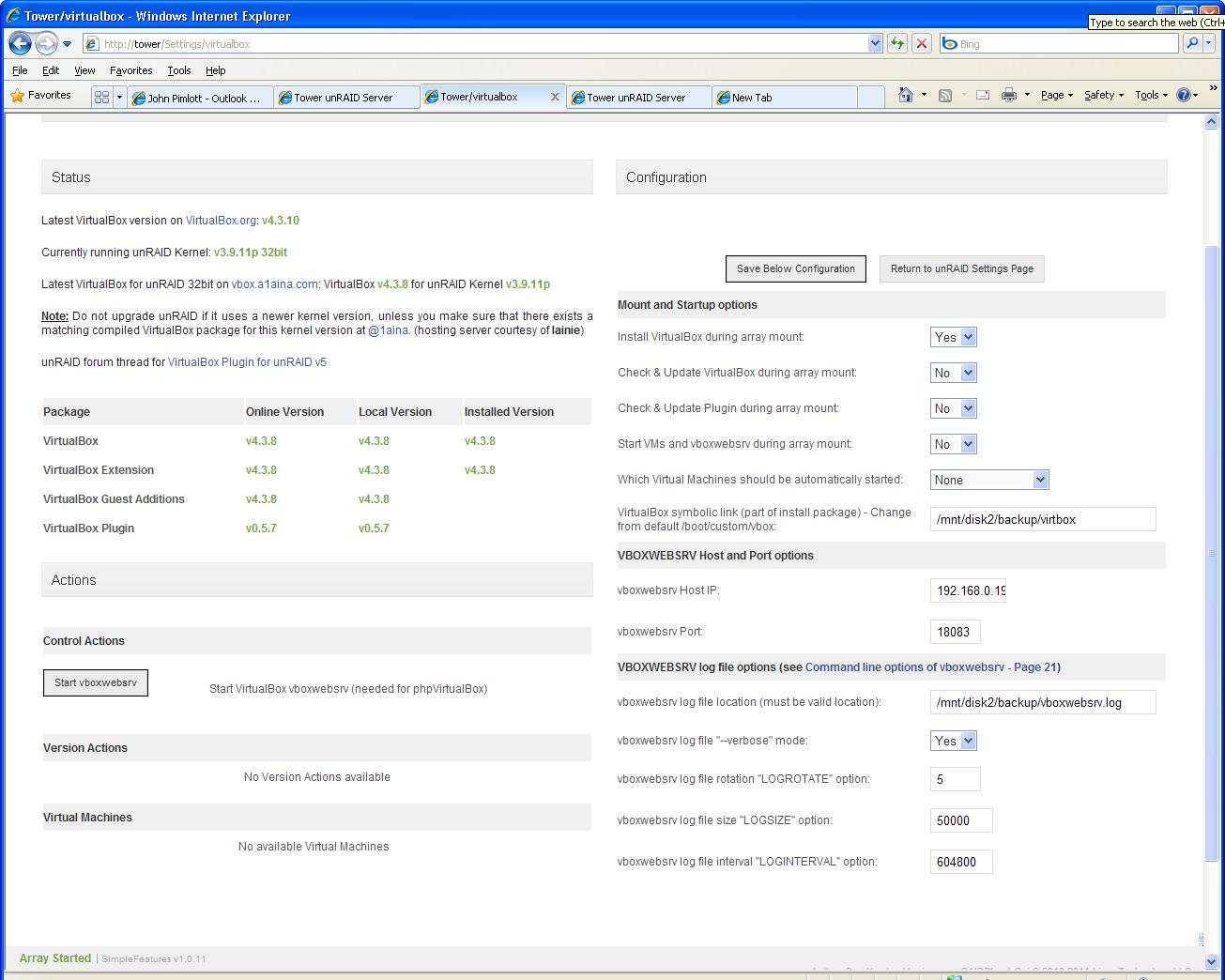

I just  installed 5.05 and the vbox upgrades and now the vboxwebserv will not start.
It tries to start when I hit the button them comes back not running
Where do i look next to trouble shoot?
Check and make sure your logfile location exists - as defined in WEBUI.
Thank you for helping so far but no dice. I checked that and even tried it one of the array drives  /mnt/disk2/backup
It did the first time after I updated it from the old ver then I tired importing a VM got part way and crashed. I restarted and now
will not start at all.
Can you post a list of running processes "ps -aux" and screenshot of the Virtualbox plugin WEBUI.
the bottom half
Two things that got me working
Leave the 127.0.0.0 alone
And change the the vboxwebsrv log back to the default on the thumb drive.
When I did this phpvirtualbox started to work for me
I know a lot of folks use a cache or a different disk but that did not work for me
I tired both of those things and it still will not start.
I did find this error message
the time of the file is currant
VBoxSVC.txt

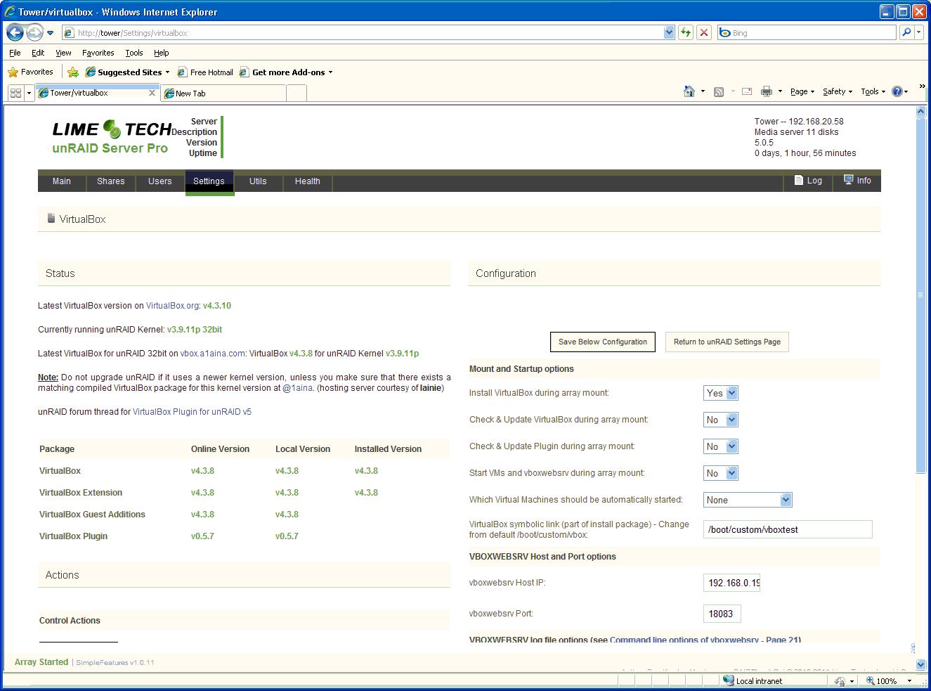

Hi, I have installed the plugin for the first time on unraid 5.0.5 and it is not working. It is complaining about the kernel version. The webui also does not look good. The packages can not be installed. Please see log and screenshot. How can I fix this?
EDIT: the symbolic link location is on a disk that is outside the array (not a cache disk either). It is mounted after the plugin is installed but before rc.virtualbox is ran. Is that a problem?
EDIT 2: Never mind.... I Just had to click the 'Download and install' button under Version Actions. Can't believe I missed that one...
T.i.a.
Harmen

Jun  5 20:29:19 NAS rc.virtualbox[22465]: VirtualBox package kernel v does not match unRAID kernel v3.9.11p - no plugin installed
Jun  5 20:29:19 NAS rc.virtualbox[22491]: VirtualBox and/or VirtualBox Extension not installed - cannot start vboxwebsrv
Jun  5 20:29:19 NAS rc.virtualbox[22517]: VirtualBox and/or VirtualBox Extension not installed - cannot start Virtual Machines
