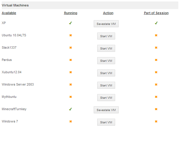

So if I start and stop VM's using phpvirtualbox, the sessionlist is never updated? I ran into an issue yesterday where I tried to stop the array so I could reboot, and I intentionally left some VM's running to see how the plugin would handle it. The VM's that were on the sessionlist savestated automatically, but a VM that I started from phpvirtualbox was still running, and kept the array from stopping. I manually saved it from the command line, and the array finished stopping.
Please post a screenshot of the WEBUI when you have virtualbox running and some VMs are shown as in session and others aren't but are running.

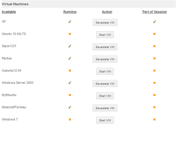

jonathanm,
Can you post the following (in this order) for the "MoveVMs" instance you showed above:
1. Existing vms_session.cfg file content.
2. Output of /opt/VirtualBox/VBoxManage list runningvms from terminal.
Press STOP button in VirtualBox Plugin WEBUI
3. Syslog
4. vms_session.cfg file content (again).
3. Syslog
The picture is labled "MoreVMs" not "MoveVMs"  :)
1.
"XP" {57133605-735f-4d6f-a8ea-392cb1f54ef3} "MinecraftTurnkey" {0486ab8a-b94b-445c-b13e-1484b57f0806}
2.
"Slack1337" {b5491bcb-42ec-464e-a0da-b0cd5e2b4f6c}
"Pardus" {61ee87f5-b044-4e49-89f4-bd4db8983c3e}
"Windows Server 2003" {eaad3b3b-539a-4d25-b7cb-fdc592803e5d}

4.
"XP" {57133605-735f-4d6f-a8ea-392cb1f54ef3} "Slack1337" {b5491bcb-42ec-464e-a0da-b0cd5e2b4f6c} "Pardus" {61ee87f5-b044-4e49-89f4-bd4db8983c3e} "Windows Server 2003" {eaad3b3b-539a-4d25-b7cb-fdc592803e5d} "MinecraftTurnkey" {0486ab8a-b94b-445c-b13e-1484b57f0806}
Repeat of runningvms command after pressing stop and waiting for command to return.
I found the problem. As you can see in (4) you postedd there are no "new line" which means my "while do" command only does the first and only line existing.
I need to figure out how to fix this and fix it !

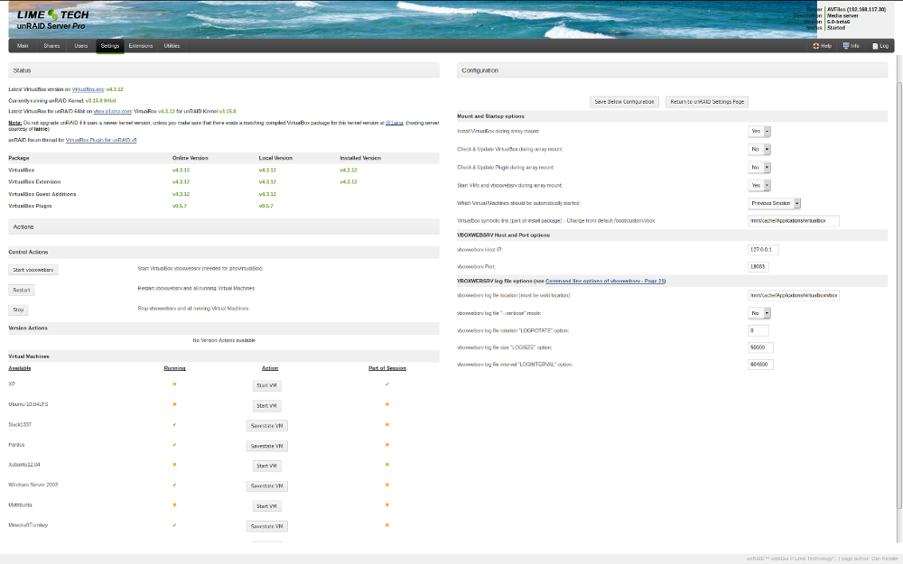

6.0 beta 4
Two issues:
1. When I "Save Below Configuration" it blanks out all the settings in the virtualbox config file, except for the symlink location, regardless of what settings I have on the webpage.
2.  I 'll restore the previous settings by editing the file manually, including upgrade on boot, start on array mount, etc, however after a system restart none of the settings are followed and according to the log it says these settings are disabled?  The plugin doesn't install on boot, and obviously nothing else happens either.  I have to manually install it from the webpage and start everything up.
Everything else works fine and I can run VMs without problems.  Just wish it would survive a restart as expected.
