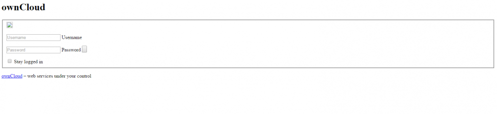

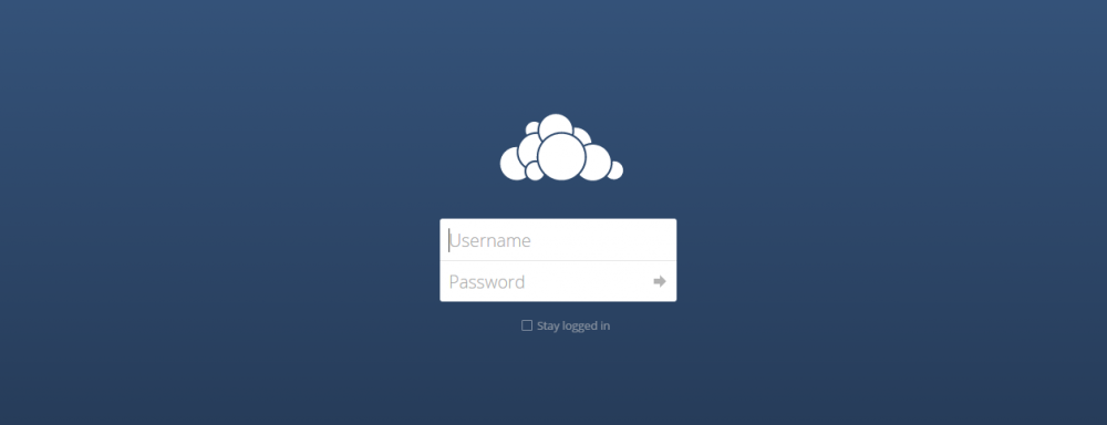

  24. Can you tell me how to change my path from var/www/html/data to var/www/owncloud/data I am stuck on this issue. I am installing the container to /mnt/cache/appdata/owncloud/ I cannot change it in the intial install in the docker. The I attempt to change it in the web config and it states I do not have the rights to write into that directory. Thank you very very much for responding and helping. I have been working very hard lots of hours to get this working. Bill
