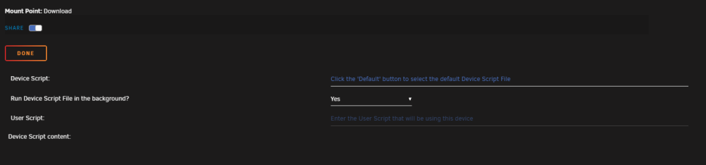

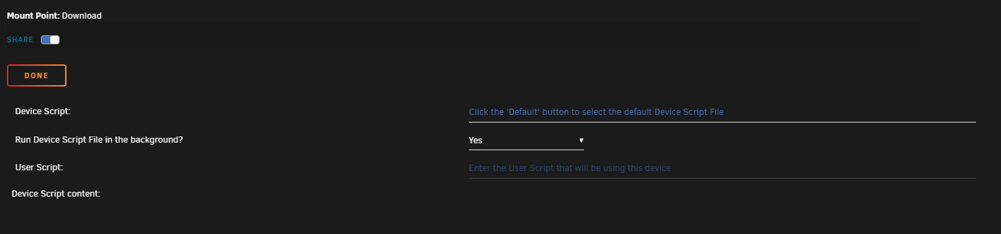

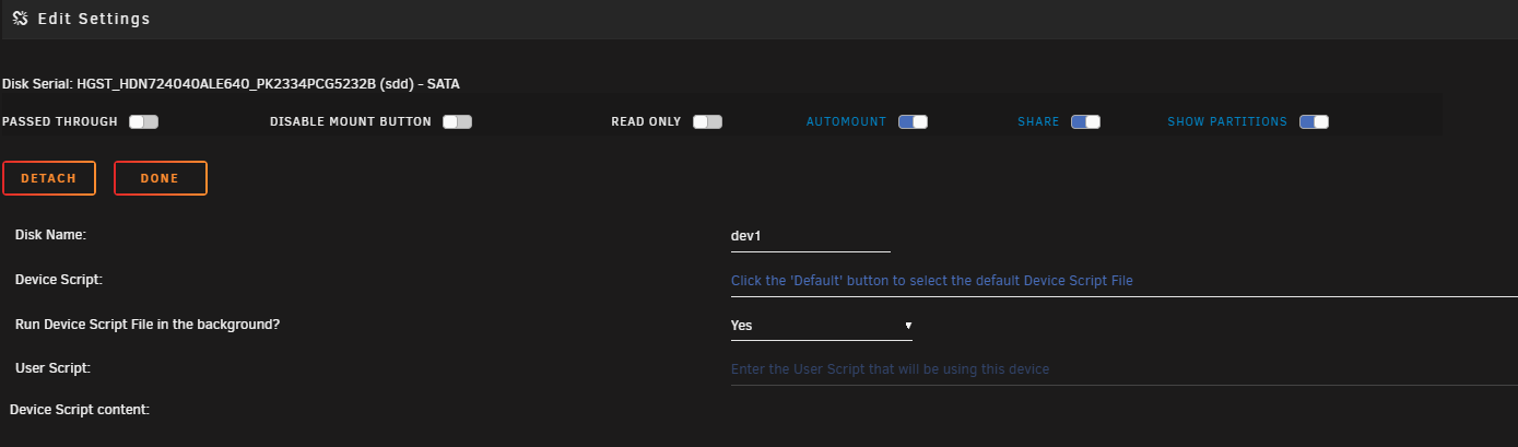

  1. Yes I am also working now thank you for all of your assistance! Can I turn down the Debug Level in UD Settings?
  2. I have never turned on SMB Security. Those users were created in an earlier version of unRaid. I did uDev and Hotplug and toggled the share. mediatower-diagnostics-20230220-1017.zip
  3. I toggled the share option on/off while it is mounted. No change in results. SMB Security, where is that located? I don't think I have ever seen that option screen.
  4. Same issue here. Visible internally to Sab/Sonarr/Krusader but no longer visible from Windows 10 clients on my network. This happened within the last few days. mediatower-diagnostics-20230220-0812.zip
  5. I have a share(Download) that exists on an unassigned HGST 4TB Drive. I use it for all of my sabnzbd downloads. This has been working fne for over a year but now I can't access any of the files on the share after i mount. The share is not available on any of my windows clients. Sabnzbd can't find this share anymore. I can see the share in Krusader but it shows empty. I can browser this share from the Unraid Main Page and see folders and files. Am I missing something here? Checked Syslogs but I don't see anything eventful.
