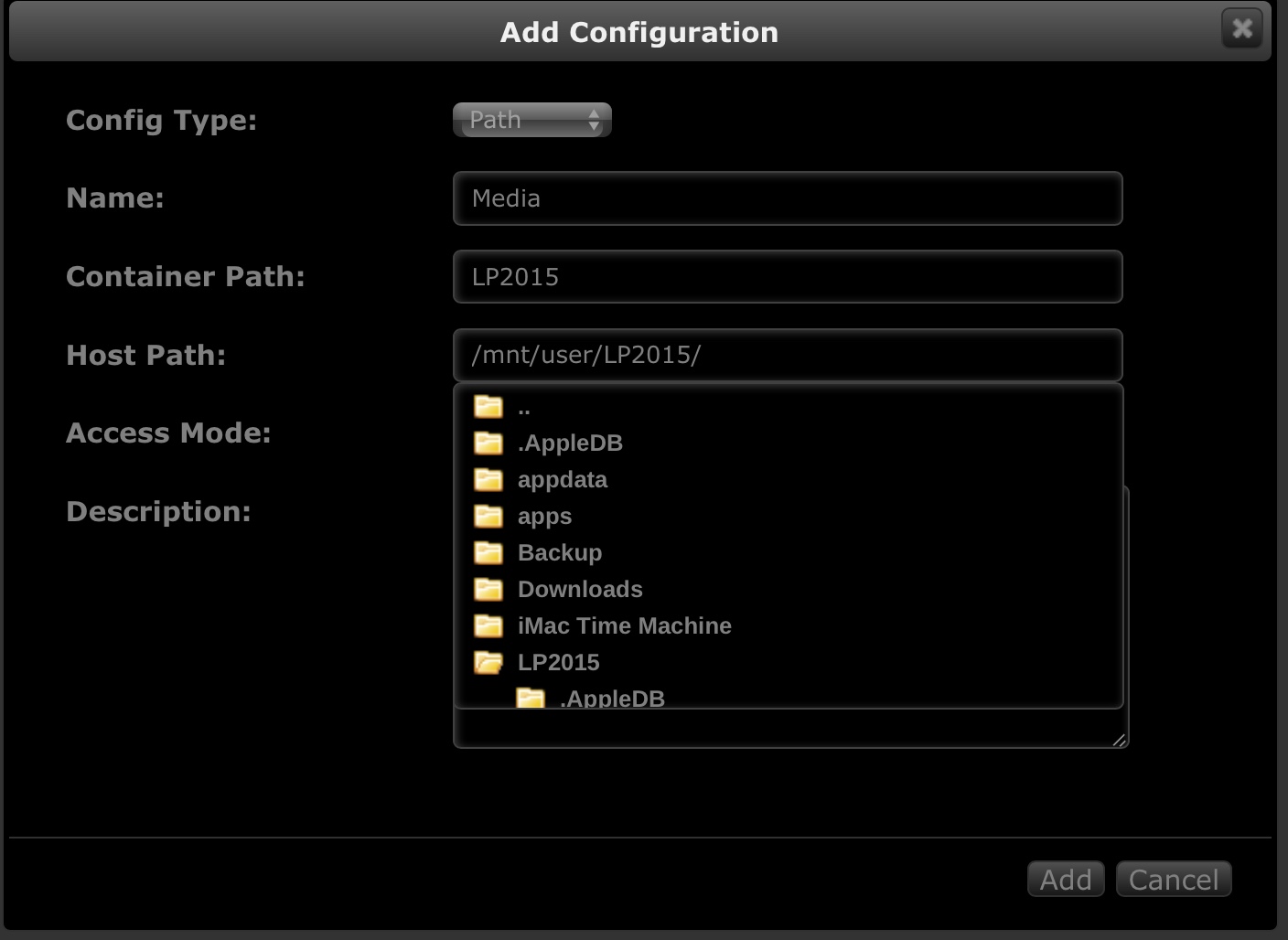

Hi, here is the data you asked for and a short commentary. 1) Add Docker without path to Media (attach 1) 2) Plex start up, some network errors, I think I can ignore? (attach 2). Plex runs with Metadata but no Media 3) Add path to Media (attach 3) 4) Click done and Docker command fails and orphans the image (attach 4) I understand the path process and although it has changed this surely right? The Media is in sub-folders below LP2015 which I can map in Plex Plex_Docker_install.txt Plex_Log.txt Add_path_result.txt

I just switched to this docker and I'm encountering some problems. 1) I don't see anywhere to tell Plex where my media is. Previously I created paths to each Plex Category but there doesn't seem to be anywhere to add even a single path by default although the instructions imply there is 2) So I add a simple Path config and the following error pops up - Says something about 'Invalid volume destination path: 'LP' mount path must be absolute.' but I use all I did was provide a name and use the path select process /mnt/user etc 3) Then the Docker disappears and I am left with an empty orphan image file needing deleting? 4) The default config file should be on the cache but it isn't so this needs correcting every install? 5) Adding the Media path after a start (which Plex does though no media files just metadata) kills the image as per 2) I did visit the Linuxserver.io forum where there are reports of others with problems. Just tried the needo version and get this same error 'Invalid volume destination path: 'LP' mount path must be absolute' Advice/help please
