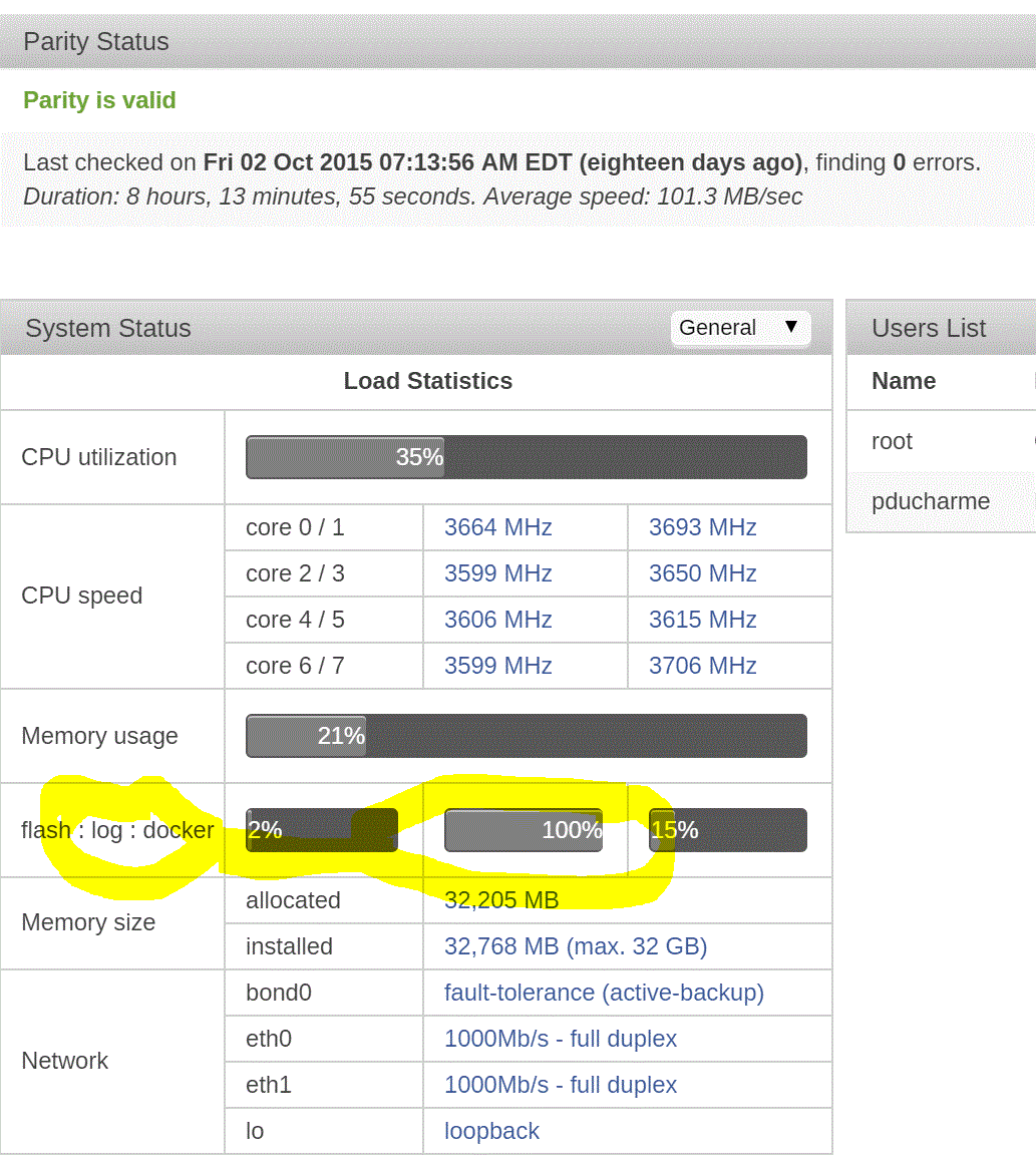

I guess we will know later when the logs starts to get in every day. I didn't increased it before yesterday, except that my LOG partition was full, I didn't had any issue with it. Also, If it's not speficied in the install instructions, I wonder if it's only on certain hardware that would generate more logs (?)... Here is the command to insert in the go file. You can also run it on a live server without reboot and the LOG part increase right away. # Enlarge the LOG partition (because Dynamix System Stats needs at least 186Mb, default LOG is 128Mb) mount -o remount,size=384m /var/log I don't know if it's safe to delete the /var/log/sa/* (content), if so, we could do a if in the go file that check if the sa30 exist, and delete all sa* if it exist. I think that would make it keep the last 30 days (UNTESTED).

Ok, I fixed it by upping the size of /var/log to 384m instead of default 128m. Dynamix System Stats needs 186mb, so I put 384mb to have free space. I think that the size of the LOG partition should be configurable in the WebGUI. Anyway, I put the command in my go file.

seems to be the /var/log/sa folder that contains lots of files and it look like it use 122Mb on the 128Mb total... But I don't know why, and what to do to find out why and to prevent it!

Here it is : root@Unraid:~# df -h /var/log Filesystem Size Used Avail Use% Mounted on tmpfs 128M 128M 0 100% /var/log root@Unraid:~# du -sm /var/log/* 0 /var/log/btmp 0 /var/log/btmp.1 0 /var/log/cron 0 /var/log/debug 1 /var/log/dmesg 1 /var/log/docker.log 0 /var/log/faillog 1 /var/log/lastlog 1 /var/log/libvirt 1 /var/log/maillog 0 /var/log/messages 0 /var/log/nfsd 3 /var/log/packages 0 /var/log/plugins 0 /var/log/removed_packages 0 /var/log/removed_scripts 122 /var/log/sa 1 /var/log/samba 1 /var/log/scripts 0 /var/log/secure 1 /var/log/setup 0 /var/log/spooler 1 /var/log/syslog 2 /var/log/syslog.1 2 /var/log/syslog.2 1 /var/log/unassigned.devices.log 1 /var/log/wtmp root@Unraid:~#

Hi, a while ago, I tested all version of Unraid 6 beta. I think one plugins did fill all the LOG partition and now, everytime I install a plugin (or update it), I always get lots of error because it is full. Attached is the picture of the dashboard showing the LOG at 100%... I would appreciate if someone can tell me how to clear it.
