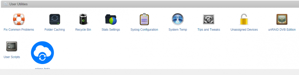

Great work, I haven't tested the scripts yet, I already have some working once, but it is a good step forward for new users. Only issue I did spot is that your icon seems to be a different size to the others.
