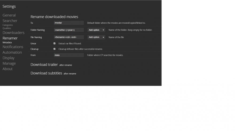

  1. Just looking for a little advice really. I have couch potato setup as I would like it in terms of its links to delugeVPN and its downloading exactly as I would like. My question is in relation to the Renamer. Currently delugeVPN downloads to a downloads folder. I want my renamer to get the downloaded video file only, rename it, then put it into my movies folder and finally clean up the excess files that get downloaded with a torrent. I have included a picture of my current renamer settings and im curious as to weather this should work as I want it to or do I need to change something? Also how often does this renamer run?

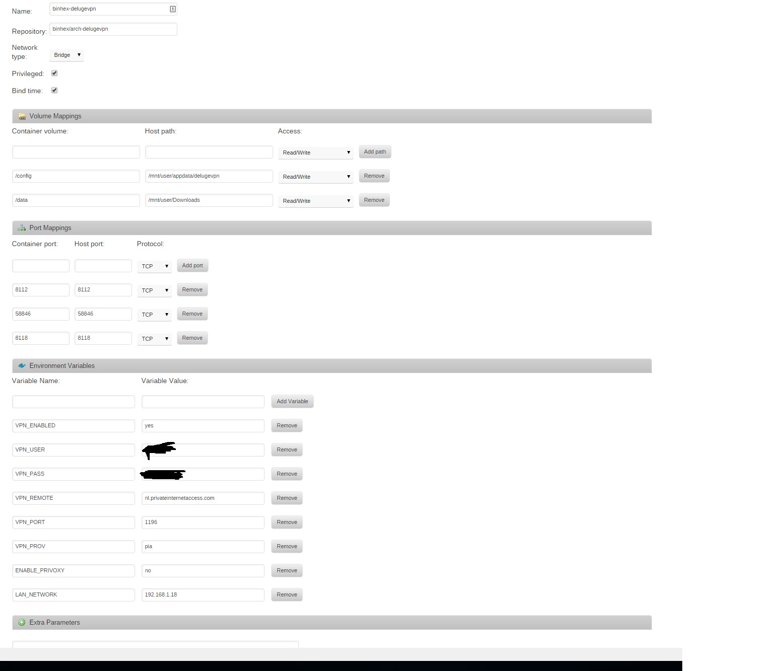

  5. So I've tried: 1. deleting the container and reinstalling 2. deleting the container & image and installing 3. deleting the docker.img and reinstalling the container and even: 4. deleting the docker.img, deleting the docker comtainer/image and using a new config/appdata directory and still cannot open the webui!!! What is going on??? Well, I think I figured out my hardware issues, and my system seems to be running OK now. BUT, I cannot get Delugevpn and Sabnzbdvpn working again... Webuis will not load. I can get all my other dockers working. Any ideas? Geez that was a frustrating one to solve... But I did it! You recently made some changes and told us to modify the environment variable like this: LAN_NETWORK 192.168.1.0/24 My network is different, so I typed this by mistake: LAN_NETWORK 192.168.0.1/24 instead of this: LAN_NETWORK 192.168.0.0/24 Can't believe how hard that was to track down. Sorry for wasting your time... ahh good catch, thats two people caught out by that, im seriously considering "helping" the end user by removing the last octet and setting it as zero :-) This also fixed my issue. 192.168.1.0/24 instead of 1/24 fixed my issue. Thank you <3
  6. I use port 1194 (not 1196) and us-east.privateinternetaccess.com for my delugevpn setup. I also don't see VPN_Protocol in your setup screenshot. Mine is set for UDP. Maybe these things are your issue? If you look at earlier posts most of these are from an earlier post in relation to speed issues. Plus the PIA server isnt the issue as I am in ireland. The logs show no mention of issues with the VPN but just at a guess seems to be an issue with Read and Write privileges? again this is at a guess from looking at the logs I have already posted. Just in case this is the issue would someone mind sending me the default openvpn.ovpn file in /config/openvpn? I changed mine and when it was working earlier I deleted my back up of the original. Thanks
  7. I believe the files are located in the config folder, not the docker.img. Test it. Stop all dockers and the docker service. Rename docker.img to docker.bak. Restart your docker service and try the deluge docker again. Problem i have is i cant get the docker to work at all. It says its running but i cant connect to the webui. I made a few earlier posts. No one seems to have any idea about it. post a screen shot of your docker container config. Thanks for the help. Here's the setup Add /24 to the end of the vip address in lan_network. Nope still same result I'm afraid. Exactly the same as my earlier logs.
  8. Problem i have is i cant get the docker to work at all. It says its running but i cant connect to the webui. I made a few earlier posts. No one seems to have any idea about it. Firstly, don't panic, as long as you have configured the volume mappings correctly AND set deluge to write to these areas (i.e. /config or /data) then you wont loose anything should you need to delete the entire shooting match. What mr-hexen is suggesting above is sound advice, you do NOT need to get access to the deluge webui to do the above, this will reset you back to no docker containers or images, you can then use the "user defined templates" dropdown when creating the containers again to pre-populate the config, so you should be back to a running system in around 30 mins to an hour. Once you have got a new docker.img file created and re-pulled down delugevpn then run it and see what happens, if its still shagged then post back here with as much detail as possible, new supervisord.log, screnshot of the delugevpn config (with advanced switched on), syslog too. Thanks for the reply. I'm not overly concerned about having to reinstall. Its just if I can avoid having to re add the list of files I have queued if at all possible. At this stage I'm thinking a fresh install to stop this error is prob the way to go. I'm not sure if that earlier config change to try help improve speeds might be causing an error now?
  9. I believe the files are located in the config folder, not the docker.img. Test it. Stop all dockers and the docker service. Rename docker.img to docker.bak. Restart your docker service and try the deluge docker again. Problem i have is i cant get the docker to work at all. It says its running but i cant connect to the webui. I made a few earlier posts. No one seems to have any idea about it. post a screen shot of your docker container config. Thanks for the help. Here's the setup
