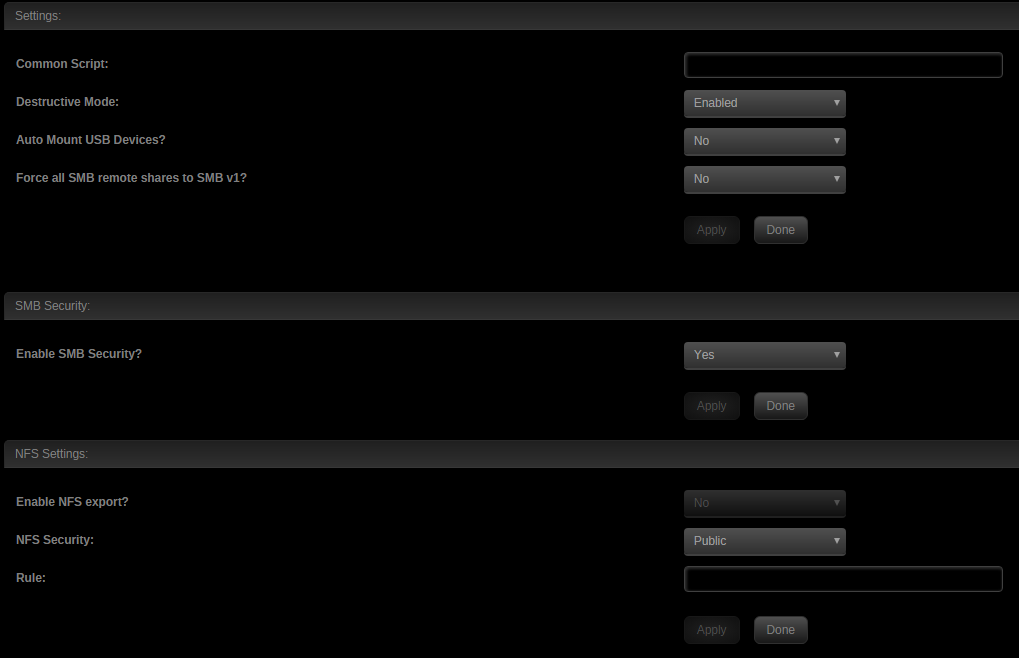

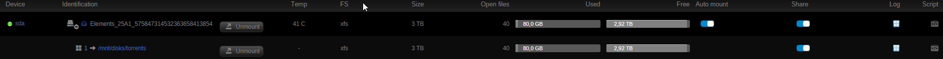

  7. just looking for a bit of help mapping a UD drive in windows 10. I have the drive working exactly as I would like and im just trying to map it in windows 10 for convenience. Its an external usb drive that I am using specifically for downloads. Its not the end of the world if I cant. I have included my settings. I tried \\SERVER\torrents to map it and also \\192.168.0.1\torrants but keep getting an enter credentials pop up.
  8. im an idiot.... simple typo was causing the issue... sorted it out just going to check and make sure its writing to that disk now. fingers crossed thats it Yup thats exactly the issue. writing to the UD ssd now. Thanks
