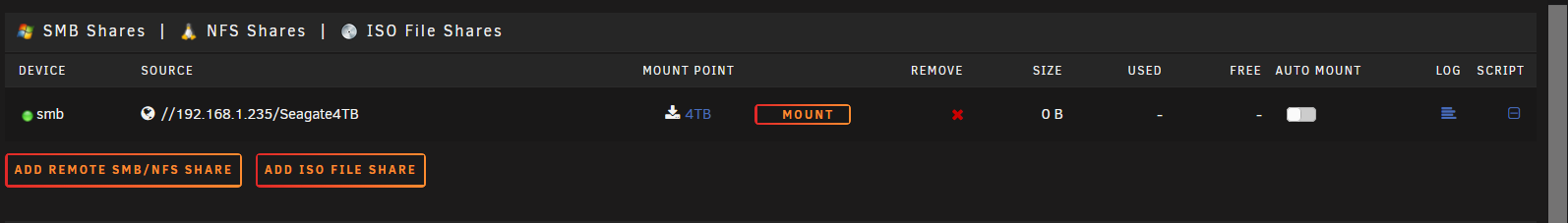

OMG, I had to change the theme to see it. I'm colorblind and I didn't see it on that theme. Thank You.
How do I remove a remote SMB Share from UD? Sorry if the answer is here somwhere but I couldn't find it yet.
