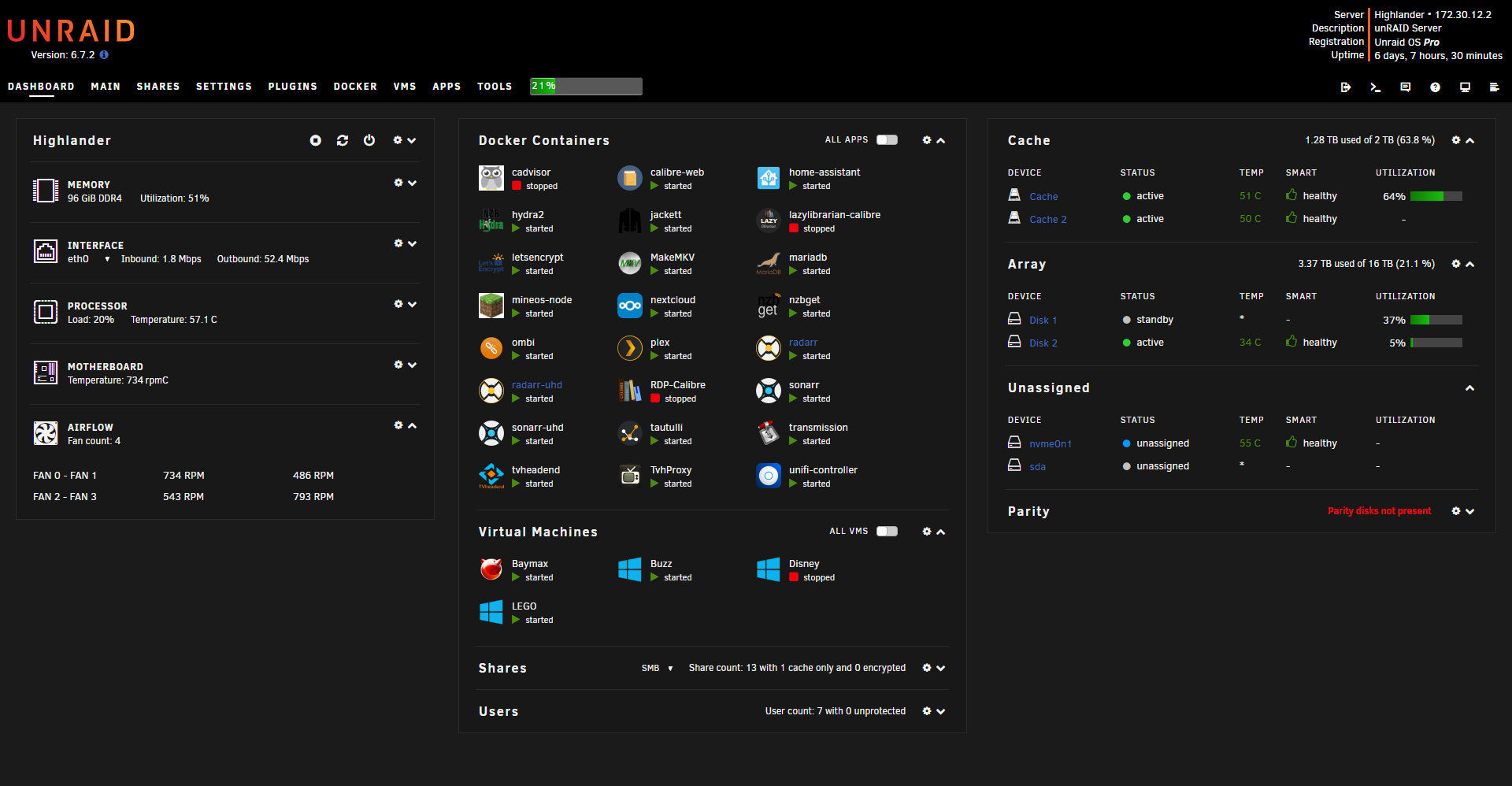

Same here. I've just finished selling 7 HDDs on eBay, including my Parity drive as I have a less real-time backup strategy now (to a seperate teamdrive on a cron job). The noise and heat reduction is really noticeable and of my remaining 16TB, I'm only using around 20% - with nearly 350TB in the cloud which would cost me over £7.5k just for the drives!
