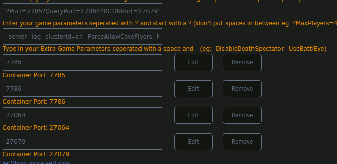

  3. You need to make sure that you tell Ark what ports you are using eg. `?Port=7785?QueryPort=27064` and it's not just that you need to remove and re-add them, the port inside the container needs to be the same port exposed externally. This is because ARK reports it's ports back to steam and you can't change the container port without adding a new port mapping. So from a fresh setup, you should remove the query port and add a 27016<>27016 mapping. In addition, there is no command line argument for the second UDP port (following 7777), it's always the first UDP port +1. So when you tell Ark ?Port=7785 you are also saying UDP2 port is 7786. Then ?QueryPort=27064 is obvious what it does. If you want RCON (do you need this?), then there is more you have to do such as adding ?RCONPort=27075?RCONEnabled=True?ServerAdminPassword=<yourpass> to the commandline.
