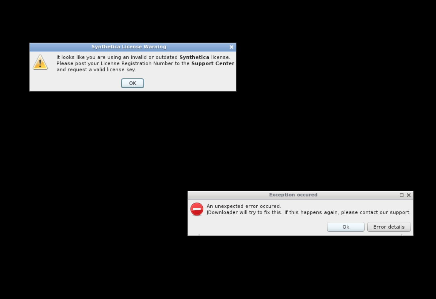

  5. Looks like it started up again, is something up with some of JDownloader's licenses or certs?
  6. I just tried launching it again and an update went through from Jdownloader which appears to have fixed the issue.
  7. Is anyone seeing this when they start Jdownloader? I've been getting this and Jdownloader shut down right away. Here's the log output: text error warn system array login [xvnc ] VNCSConnST: Client pixel format depth 24 (32bpp) little-endian bgr888 [supervisor ] service 'app' exited (with status 0). [supervisor ] service 'app' exited, shutting down... [supervisor ] stopping service 'openbox'... [supervisor ] service 'openbox' exited (with status 0). [supervisor ] stopping service 'nginx'... [xvnc ] Wed Sep 20 15:53:47 2023 [xvnc ] VNCSConnST: closing /tmp/vnc.sock: Clean disconnection [xvnc ] EncodeManager: Framebuffer updates: 3 [xvnc ] EncodeManager: Tight: [xvnc ] EncodeManager: Solid: 4 rects, 3.34592 Mpixels [xvnc ] EncodeManager: 64 B (1:209121 ratio) [xvnc ] EncodeManager: Bitmap RLE: 1 rects, 150 pixels [xvnc ] EncodeManager: 66 B (1:9.27273 ratio) [xvnc ] EncodeManager: Total: 5 rects, 3.34607 Mpixels [xvnc ] EncodeManager: 130 B (1:102956 ratio) [xvnc ] Connections: closed: /tmp/vnc.sock [xvnc ] ComparingUpdateTracker: 0 pixels in / 0 pixels out [xvnc ] ComparingUpdateTracker: (1:-nan ratio) [supervisor ] service 'nginx' exited (with status 0). [supervisor ] stopping service 'xvnc'... [xvnc ] ComparingUpdateTracker: 0 pixels in / 0 pixels out [xvnc ] ComparingUpdateTracker: (1:-nan ratio) [supervisor ] service 'xvnc' exited (with status 0). [finish ] executing container finish scripts... [finish ] all container finish scripts executed. [init ] container is starting... [cont-env ] loading container environment variables... [cont-env ] APP_NAME: loading... [cont-env ] DISPLAY: executing... [cont-env ] DISPLAY: terminated successfully. [cont-env ] DISPLAY: loading... [cont-env ] DOCKER_IMAGE_PLATFORM: loading... [cont-env ] DOCKER_IMAGE_VERSION: loading... [cont-env ] GTK2_RC_FILES: executing... [cont-env ] GTK2_RC_FILES: terminated successfully. [cont-env ] GTK2_RC_FILES: loading... [cont-env ] GTK_THEME: executing... [cont-env ] GTK_THEME: terminated successfully. [cont-env ] GTK_THEME: loading... [cont-env ] HOME: loading... [cont-env ] INSTALL_PACKAGES_INTERNAL: executing... [cont-env ] INSTALL_PACKAGES_INTERNAL: terminated successfully. [cont-env ] INSTALL_PACKAGES_INTERNAL: loading... [cont-env ] QT_STYLE_OVERRIDE: executing... [cont-env ] QT_STYLE_OVERRIDE: terminated successfully. [cont-env ] QT_STYLE_OVERRIDE: loading... and another error in the program: java.lang.NoClassDefFoundError: org/appwork/swing/trayicon/TrayMouseListener at java.lang.ClassLoader.defineClass1(Native Method) at java.lang.ClassLoader.defineClass(ClassLoader.java:757) at java.security.SecureClassLoader.defineClass(SecureClassLoader.java:142) at java.net.URLClassLoader.defineClass(URLClassLoader.java:473) at java.net.URLClassLoader.access$100(URLClassLoader.java:74) at java.net.URLClassLoader$1.run(URLClassLoader.java:369) at java.net.URLClassLoader$1.run(URLClassLoader.java:363) at java.security.AccessController.doPrivileged(Native Method) at java.net.URLClassLoader.findClass(URLClassLoader.java:362) at java.lang.ClassLoader.loadClass(ClassLoader.java:419) at sun.misc.Launcher$AppClassLoader.loadClass(Launcher.java:352) at java.lang.ClassLoader.loadClass(ClassLoader.java:352) at jd.gui.swing.jdgui.JDGui.<init>(JDGui.java:237) at jd.gui.swing.jdgui.JDGui.<init>(JDGui.java:154) at jd.gui.swing.jdgui.JDGui$35.edtRun(JDGui.java:1700) at jd.gui.swing.jdgui.JDGui$35.edtRun(JDGui.java:1696) at org.appwork.utils.swing.EDTHelper.run(EDTHelper.java:119) at org.appwork.utils.swing.EDTHelper.start(EDTHelper.java:154) at org.appwork.utils.swing.EDTHelper.waitForEDT(EDTHelper.java:168) at org.appwork.utils.swing.EDTHelper.getReturnValue(EDTHelper.java:100) at jd.gui.swing.jdgui.JDGui.init(JDGui.java:1704) at jd.SecondLevelLaunch$11.edtRun(SecondLevelLaunch.java:962) at jd.SecondLevelLaunch$11.edtRun(SecondLevelLaunch.java:955) at org.appwork.utils.swing.EDTHelper.run(EDTHelper.java:119) at java.awt.event.InvocationEvent.dispatch(InvocationEvent.java:311) at java.awt.EventQueue.dispatchEventImpl(EventQueue.java:758) at java.awt.EventQueue.access$500(EventQueue.java:97) at java.awt.EventQueue$3.run(EventQueue.java:709) at java.awt.EventQueue$3.run(EventQueue.java:703) at java.security.AccessController.doPrivileged(Native Method) at java.security.ProtectionDomain$JavaSecurityAccessImpl.doIntersectionPrivilege(ProtectionDomain.java:74) at java.awt.EventQueue.dispatchEvent(EventQueue.java:728) at java.awt.EventDispatchThread.pumpOneEventForFilters(EventDispatchThread.java:205) at java.awt.EventDispatchThread.pumpEventsForFilter(EventDispatchThread.java:116) at java.awt.EventDispatchThread.pumpEventsForHierarchy(EventDispatchThread.java:105) at java.awt.EventDispatchThread.pumpEvents(EventDispatchThread.java:101) at java.awt.EventDispatchThread.pumpEvents(EventDispatchThread.java:93) at java.awt.EventDispatchThread.run(EventDispatchThread.java:82) Caused by: java.lang.ClassNotFoundException: org.appwork.swing.trayicon.TrayMouseListener at java.net.URLClassLoader.findClass(URLClassLoader.java:387) at java.lang.ClassLoader.loadClass(ClassLoader.java:419) at sun.misc.Launcher$AppClassLoader.loadClass(Launcher.java:352) at java.lang.ClassLoader.loadClass(ClassLoader.java:352) ... 38 more And another Jdownloader error just before it existed. org.jdownloader.update.launcher.JDLauncherFailedException: java.lang.NullPointerException at org.jdownloader.update.launcher.SecondLevelLauncher.launchJDownloader(SecondLevelLauncher.java:679) at org.jdownloader.update.launcher.SecondLevelLauncher.init(SecondLevelLauncher.java:465) at org.jdownloader.update.launcher.SecondLevelLauncher.runMain(SecondLevelLauncher.java:233) at org.jdownloader.update.launcher.JDLauncherViaClassLoader.main(JDLauncherViaClassLoader.java:10) at sun.reflect.NativeMethodAccessorImpl.invoke0(Native Method) at sun.reflect.NativeMethodAccessorImpl.invoke(NativeMethodAccessorImpl.java:62) at sun.reflect.DelegatingMethodAccessorImpl.invoke(DelegatingMethodAccessorImpl.java:43) at java.lang.reflect.Method.invoke(Method.java:498) at org.jdownloader.updatev2.JDClassLoaderLauncher.main(JDClassLoaderLauncher.java:152) at org.jdownloader.update.launcher.JDLauncher.main(JDLauncher.java:8) Caused by: java.lang.NullPointerException at jd.SecondLevelLaunch.go(SecondLevelLaunch.java:982) at jd.SecondLevelLaunch.start(SecondLevelLaunch.java:515) at jd.SecondLevelLaunch.mainStart(SecondLevelLaunch.java:481) at org.jdownloader.startup.Main.main(Main.java:247) at org.jdownloader.launcher.StandaloneLauncher.launchJDownloader(StandaloneLauncher.java:137) at org.jdownloader.update.launcher.SecondLevelLauncher.launchJDownloader(SecondLevelLauncher.java:641) ... 9 more
