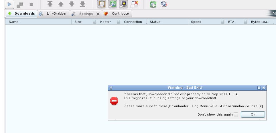

But I wanted to ask if it would be possible for you to add some kind of "nice" shutdown script or something to the container when stopping it from unRAID webUI without first Exiting it from inside the container first?
See below when starting container up after shutdown.
There is already one :)
Do you get this message every single time after you stop the container?
Well I can't seem to be able to provoke the error message again(tried multiple times). So I assume I just got it the first time I stopped the container :)
Consider it solved (I will inform you if it starts happening again)
