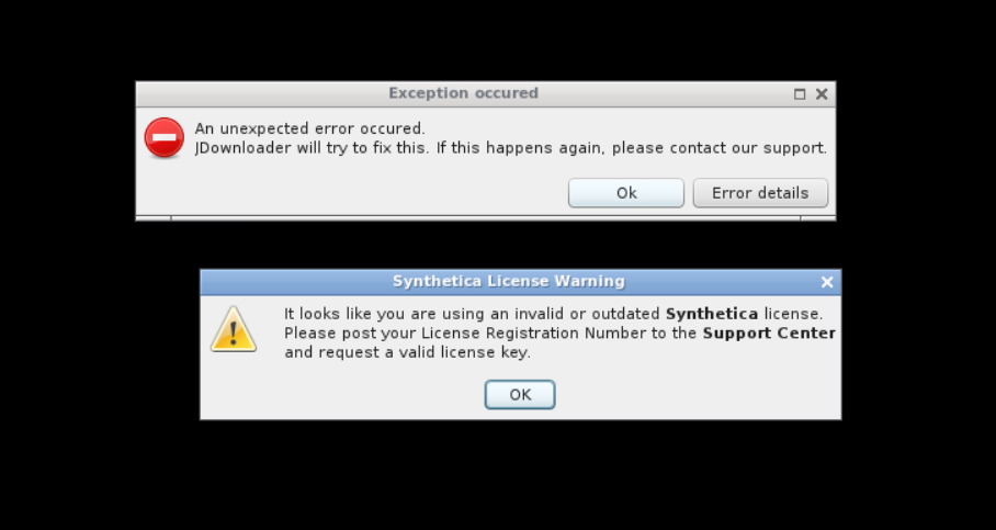

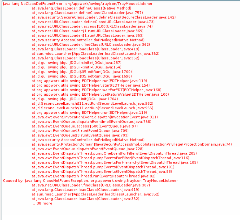

i used jdownloader docker on my unraid server for a very long time now. A few days ago, it stopped working... allready deleted and reinstalled it a few times.
Any ideas ?
On 5/5/2024 at 6:32 PM, jojo345 said:
Same happend to my container yesterday.
I solved it like this:
stopped container
saved my cfg folder
deleted all the jd2 appdatas
deletet container
built new container and started
stopped the again working container and pasted the cfg
No need , just do this
Stop the container
Go to your jd2-config folder an delete the file Core.jar and the folder tmp and update
Start the container and wait for the last update to finish
I had to reconnect my instance with my jD-Account once, because it lost it's connection.

Are you still getting a blank screen after some time ? You might have a blank screen while JDownloader update itself.
Hi Djoss,
many thanks for the answer. I tried several times and waited up to 3 hours. I would assume that any update does not take that long. One time, I saw a red bar at the top stating 'connection refused' for some seconds. Do you have any idea, what I am doing wrong?
Just switched to using this container today - however the mouse in the webVNC viewer doesn't seem to be working? I cannot click on anything, but if I connect via RealVNC client it does work?
Reluctantly bumping this - still having the same issue - can't seem to figure out what's going on. Anyone have any insight?
On 1/19/2025 at 5:06 AM, Oliver22 said:
Hi Djoss,
Maybe share a screenshot of what you are seeing, just to make sure. Did you try to start the container with an empty /mnt/user/appdata/JDownloader2 folder (you can move your current folder if needed)?
