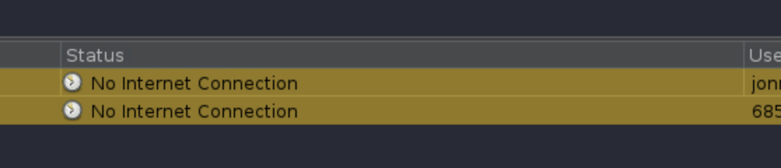

I`ve been using this container for a year now and it was working great. Since last week though I have the problem that the connection to myJDownloader does not work anymore.
In the settings I get this status that is leaving me confused:

I have the exact same issue. Jdownloader can't connect to anything. My premiumizer container can't connect to it. It can't check its accounts and it can't connect to the myjdownloader service.
I already removed the whole container and reinstalled it but no success so far...
Anybody who could help us?
Are you using default container settings ?  Does the container have access to the Internet ?
Yes (Default settings). And my container worked for a year until suddenly it didn't. So no changes from my side to the container and no network changes to Unraid.
Edit: I also deleted the container and reinstalled it. No change, still have the same problem
Edited by Stefan Bugovsky
added info
Is JDownloader able to update itself (Help->Find Updates) ?
"You already have the latest version". So I assume it was able to connect to the internet.
Is it just the MyJDownloader connection that fails ?  Can you download stuff ?
You could look at /mnt/user/appdata/JDownloader2/logs/output.log or other log files to see if there is anything interesting.
No I can't download files, because the account manager can't check account status.
I will check log files now.

Got it to work again after I removed the docker container and deleted the whole Jdownloader folder in appdata.
After a fresh installation it now working again flawlessly.
This solved my problem. Thank you
I had a bunch of issues last week with it too, seems like the recent updates have been a bit buggy. I couldn't paste any links into JD (only tried mega ones since that was all I had), they just never seemed to resolve. I'd see the window pop up for a fraction of a second and then nothing would happen. I searched around and ended up following this support article and it got it working again.
Putting it here for future reference if you don't want have to blow away your entire JD appdata folder, I think you just need to stop JD container, delete the Core.jar file and tmp, update folders, and then start it up again and it should redownload those files/folders and reset JD.
I did also have the weird mixed messages I've seen others post here for the my.jdownloader login (both green and red text), but I don't use that much so didn't look into it. As of now it is only showing the green/successful text at least.
