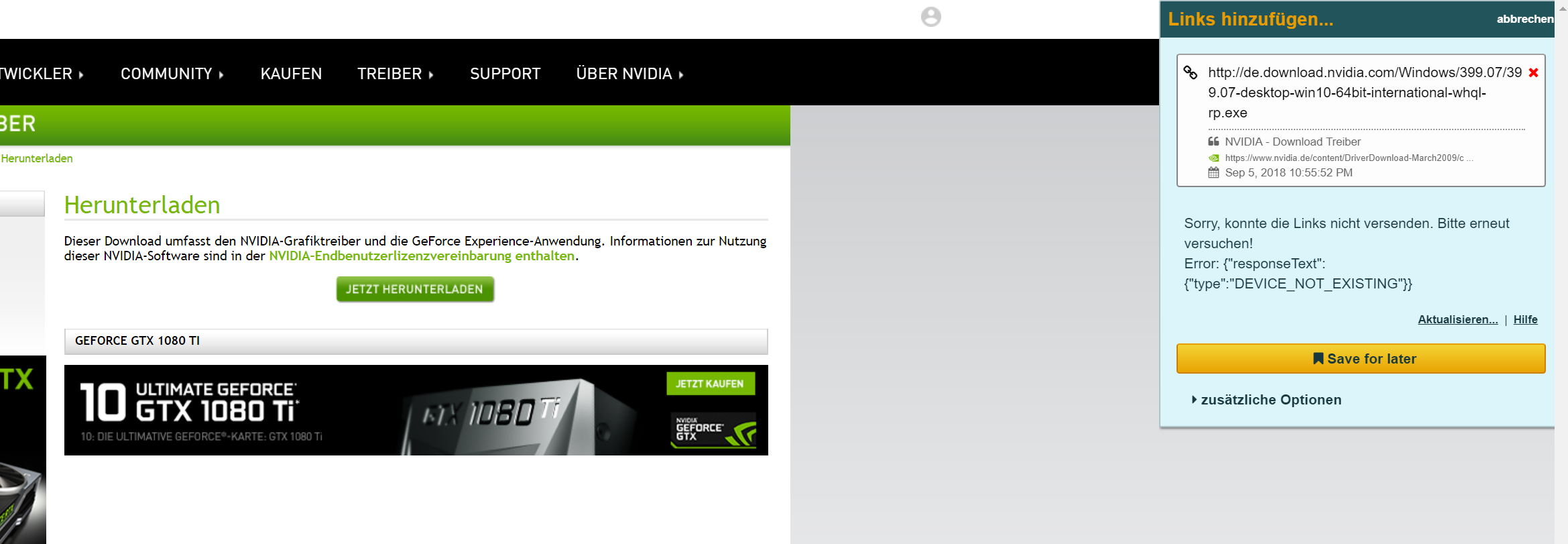

So, its stil happening.
I go to AMD and want to download the drivers via mydownloader.
I click right and sent to jdownloader. Nothing happens, and then after a while "DEVICE NOT EXISTING".
I tried on VM, the same thing.
Theni log into unraid and go into the docker VNC, click on myjdownlodaer it shows, blalba everything fine.
Then i go back to main PC, and the myjdownlodaer says i need to relogin... (???)
Then i relog and it works like it should.
WTF? So unbelievable unusable xD
Ive set unraid to restart dockers every day, if that matters.

I can give you a screenshot but its just showing that it cant reach the "app@unraid"
Edited by nuhll
ok, i was wrong. not restarting it doesnt change anything.
thats the error i get, when i log back into the vnc, it will work again.. but then i dont need the docker at all xD
(I log into docker via vnc, then i go back to browser and press "aktualisieren" (refresh) and it starts the download...) its like the container doesnt talk to jdownloader api when not opend via vnc and therefore the token? expires after X time!?
