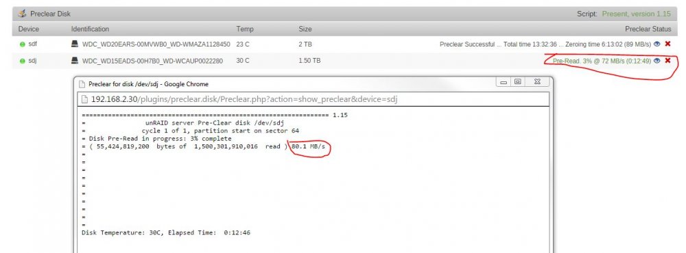

  9. Maybe the web keeps a running average where the script window is an instantaneous??
  10. You mean these two values? I could just be how often one refreshes vs the other.. The plugin author will have to comment on that. Jim
  11. ok... now some dumb questions.. did you refresh the browser? Did you try to reboot the system? The script name looks right if in fact it really is in the correct directory like you say it is... I would just double check that. after that, I'm out of ideas.. Jim
  12. You mean the e-mailed reports and such? the e-mailed reports will calculate based on time elapsed and bytes done. the gui uses the instantaneous value, iirc...
