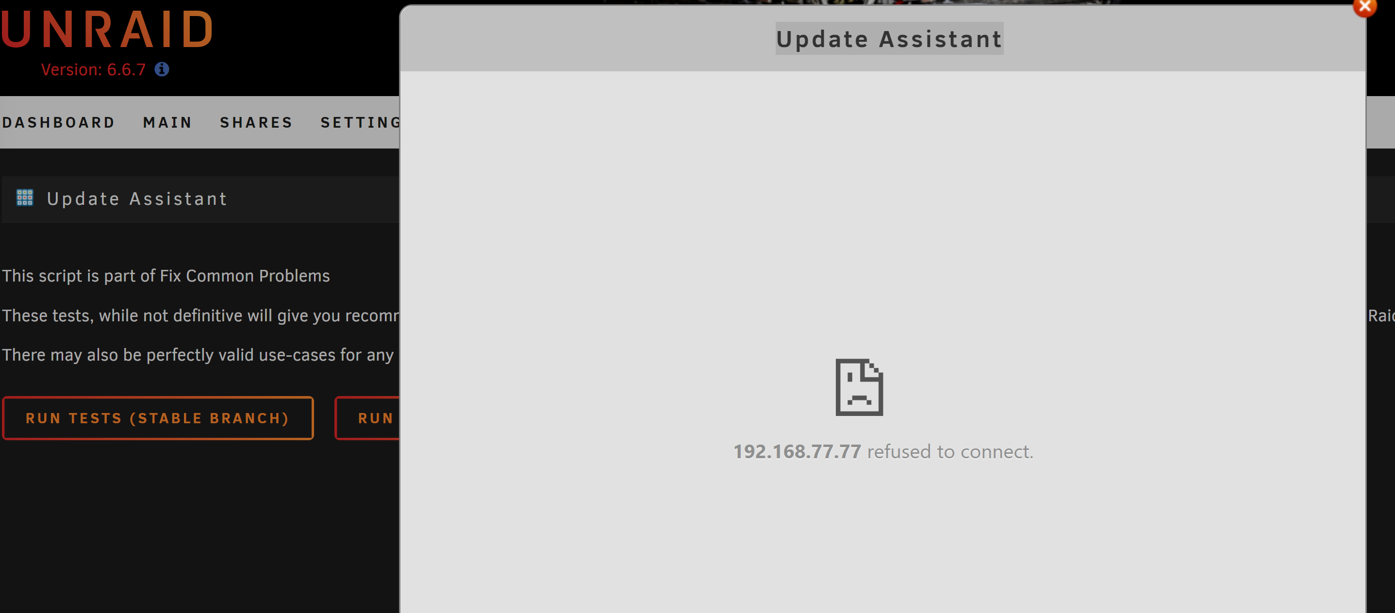

  15. So I just got CA to uninstall and reinstall. Its working and the Apps tab is back, but I cant run the OS update assistant. I get the same error that I was getting prev with CA. Says it cant connect even though my server has an internet connection.
