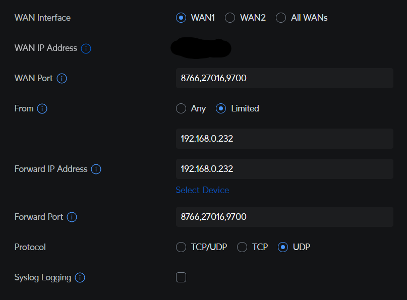

  1. Yes, Unifi allows port ranges and multiple ports with commas like that (It's pretty cool!) I got it working though, not sure what specifically the issue was but it seems to have been with SteamCMD. I made a Windows VM and created a dedicated server on there with a fresh SteamCMD install, changed the ip address in my forwarding to this VM and connecting to it worked. So the only difference now was Windows host or Docker host. I deleted my SteamCMD directory that was created over a year ago from one of your other dockers, though was still working fine for the other dockers, and reinstalled it from fresh. Launching the server and tried connecting, this worked! I am not sure what specifically in the SteamCMD was preventing clients from connecting, especially only on this docker, but I am glad it is working now. I've also tested with the older dockers as they use the same SteamCMD path and they continue to work as well. I appreciate you taking the time to help me out, even though the issue seemed to be on my end. Thank you again for all the work you do!

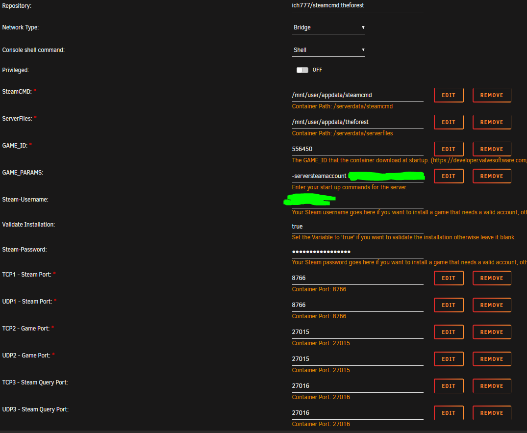

  2. Ports are all forwarded correctly on UDP to the correct internal IP address. I've double checked this and no other services are using these ports. No CG-NAT in place, the IP is unfiltered. Everything is default. I tried adding the "-serversteamaccount" like some other containers need, but with or without it, I have the same issue. -serversteamaccount XXXXXXXXXXXXXXXXXXXXX
  3. I am having an issue using the Sons of the Forest game server. Everything seems to work, except nobody can actually get into the server. Ports are forwarded, docker and steamcmd are updated, the server shows up in the steam browser. I've tried removing the password as well as adding a steam game server token, I'm still having the issue. Anyone else experience this? You join a server, it says "Joining game..." for almost a full minute and then kicks you back to the main menu. I enabled logging and found a few lines that may or may not be concerning: "Client version: no bootstrapper found"

  5. I also get the same log output as you. Looking a bit further into it, I see the game is not creating save files or building worlds. If you modify the "serverconfig.xml" and change the "GameName" value to something different, this would normally trigger a new world to be built when the docker is restarted. As of right now, it's not building anything. Experimental for a reason eh? Lol

  9. @lionel.pereira85 I completely remade it and have it running only on LAN now. Did you leave the "serverIP" at 0.0.0.0? Did you forward your ports to the UnRaid machine or is there another IP I am not seeing? Really not sure why I am having these issues, should be so simple. EDIT: Turns out it was something really stupid. My router has port forwarding called "Port Forwarding" but apparently that is not doing the actual function of forwarding the ports. I had to also add them in a section called "Virtual Server" to forward the ports to my UnRaid box. Everything seems to work perfect now! Thanks for entertaining my stupidity guys!
  10. I think I have the same or similar issue as @lionel.pereira85 Tried all night to install this server and it kept erroring out on something like "Wine: cannot find TheForestDedicatedServer.exe" so I reinstalled it and let it sit and still nothing. So I just downloaded those files from Steam and copied them to the location it was looking for, everything seemed to be discovered. Now I am having Steam Guard and login issues among other things. Temped to just turn off steam guard as it keeps asking me to enter the code, not sure how I can enter the steam guard code via console inside UnRaid though. Thanks for any help on the matter! Will attach what I have in my docker as well as paste below some output logs: 0009:err:ole:CoGetClassObject class {bcde0395-e52f-467c-8e3d-c4579291692e} not registered 0009:err:ole:CoGetClassObject no class object {bcde0395-e52f-467c-8e3d-c4579291692e} could be created for context 0x1 ---Update SteamCMD--- WARNING: setlocale('en_US.UTF-8') failed, using locale: 'C'. International characters may not work. Redirecting stderr to '/serverdata/Steam/logs/stderr.txt' [ 0%] Checking for available updates... [----] Verifying installation... Steam Console Client (c) Valve Corporation -- type 'quit' to exit -- Loading Steam API...OK. Logging in user 'USERNAME_OMITTED' to Steam Public ... This computer has not been authenticated for your account using Steam Guard. Please check your email for the message from Steam, and enter the Steam Guard code from that message. You can also enter this code at any time using 'set_steam_guard_code' at the console. Steam Guard code:FAILED login with result code Account Logon Denied ---Update Server--- ---Validating installation--- WARNING: setlocale('en_US.UTF-8') failed, using locale: 'C'. International characters may not work. Redirecting stderr to '/serverdata/Steam/logs/stderr.txt' [ 0%] Checking for available updates... [----] Verifying installation... Steam Console Client (c) Valve Corporation -- type 'quit' to exit -- Loading Steam API...OK. "@sSteamCmdForcePlatformType" = "windows" �[0mLogging in user 'USERNAME_OMITTED' to Steam Public ... This computer has not been authenticated for your account using Steam Guard. Please check your email for the message from Steam, and enter the Steam Guard code from that message. You can also enter this code at any time using 'set_steam_guard_code' at the console. Steam Guard code:FAILED login with result code Account Logon Denied ---Prepare Server--- ---Checking for 'saves' directory--- ---Directory 'saves' found!--- ---Checking for 'config.cfg'--- ---Server ready--- ---Start Server--- it looks like wine32 is missing, you should install it. multiarch needs to be enabled first. as root, please execute "dpkg --add-architecture i386 && apt-get update && apt-get install wine32" 0010:err:ole:marshal_object couldn't get IPSFactory buffer for interface {00000131-0000-0000-c000-000000000046} 0010:err:ole:marshal_object couldn't get IPSFactory buffer for interface {6d5140c1-7436-11ce-8034-00aa006009fa} 0010:err:ole:StdMarshalImpl_MarshalInterface Failed to create ifstub, hres=0x80004002 0010:err:ole:CoMarshalInterface Failed to marshal the interface {6d5140c1-7436-11ce-8034-00aa006009fa}, 80004002 0010:err:ole:get_local_server_stream Failed: 80004002 Mono path[0] = 'Z:/serverdata/serverfiles/TheForestDedicatedServer_Data/Managed' Mono path[1] = 'Z:/serverdata/serverfiles/TheForestDedicatedServer_Data/Mono' Mono config path = 'Z:/serverdata/serverfiles/TheForestDedicatedServer_Data/Mono/etc' Player data archive not found at `Z:/serverdata/serverfiles/TheForestDedicatedServer_Data/data.unity3d`, using local filesystemInitialize engine version: 5.6.5p4 (10861494ddb7) GfxDevice: creating device client; threaded=0 0009:err:wgl:X11DRV_wglCreateContextAttribsARB Context creation failed (error 1) 0009:err:wgl:X11DRV_wglCreateContextAttribsARB Context creation failed (error 1) 0009:err:d3d:wined3d_adapter_find_polyoffset_scale PolygonOffset scale factor detection failed, using fallback value 2^23. 0009:err:wgl:X11DRV_wglCreateContextAttribsARB Context creation failed (error 1) 0009:err:wgl:X11DRV_wglCreateContextAttribsARB Context creation failed (error 1) 0009:err:d3d:wined3d_adapter_find_polyoffset_scale PolygonOffset scale factor detection failed, using fallback value 2^23. 0009:err:ole:CoGetClassObject class {4590f811-1d3a-11d0-891f-00aa004b2e24} not registered 0009:err:ole:CoGetClassObject no class object {4590f811-1d3a-11d0-891f-00aa004b2e24} could be created for context 0x1 Direct3D: Version: Direct3D 11.0 [level 10.1] Renderer: NVIDIA GeForce 8800 GTX (ID=0x191) Vendor: NVIDIA VRAM: 40289 MB D3D shader create error for vertex shader [0x80070057] ShaderProgram is unsupported, but because jobified rendering is enabled the ShaderProgram can not be removed. (Filename: Line: 450) D3D shader create error for vertex shader [0x80070057] ShaderProgram is unsupported, but because jobified rendering is enabled the ShaderProgram can not be removed. (Filename: Line: 450) D3D shader create error for vertex shader [0x80070057] ShaderProgram is unsupported, but because jobified rendering is enabled the ShaderProgram can not be removed. (Filename: Line: 450) D3D shader create error for vertex shader [0x80070057] WARNING: Shader Unsupported: 'Hidden/Post FX/Temporal Anti-aliasing' - Pass '' has no vertex shader D3D shader create error for vertex shader [0x80070057] ShaderProgram is unsupported, but because jobified rendering is enabled the ShaderProgram can not be removed. (Filename: Line: 450) D3D shader create error for vertex shader [0x80070057] ShaderProgram is unsupported, but because jobified rendering is enabled the ShaderProgram can not be removed. (Filename: Line: 450) 0009:err:ole:CoGetClassObject class {bcde0395-e52f-467c-8e3d-c4579291692e} not registered 0009:err:ole:CoGetClassObject class {bcde0395-e52f-467c-8e3d-c4579291692e} not registered 0009:err:ole:create_server class {bcde0395-e52f-467c-8e3d-c4579291692e} not registered 0009:err:ole:CoGetClassObject no class object {bcde0395-e52f-467c-8e3d-c4579291692e} could be created for context 0x17 0009:err:ole:CoGetClassObject class {bcde0395-e52f-467c-8e3d-c4579291692e} not registered 0009:err:ole:CoGetClassObject no class object {bcde0395-e52f-467c-8e3d-c4579291692e} could be created for context 0x1 0009:err:ole:CoGetClassObject class {bcde0395-e52f-467c-8e3d-c4579291692e} not registered 0009:err:ole:CoGetClassObject no class object {bcde0395-e52f-467c-8e3d-c4579291692e} could be created for context 0x1 0009:err:ole:CoGetClassObject class {bcde0395-e52f-467c-8e3d-c4579291692e} not registered 0009:err:ole:CoGetClassObject no class object {bcde0395-e52f-467c-8e3d-c4579291692e} could be created for context 0x1 0009:err:dsound:get_mmdevenum CoCreateInstance failed: 80040154 0009:err:ole:CoGetClassObject class {bcde0395-e52f-467c-8e3d-c4579291692e} not registered 0009:err:ole:CoGetClassObject no class object {bcde0395-e52f-467c-8e3d-c4579291692e} could be created for context 0x1 0009:err:ole:CoGetClassObject class {bcde0395-e52f-467c-8e3d-c4579291692e} not registered 0009:err:ole:CoGetClassObject no class object {bcde0395-e52f-467c-8e3d-c4579291692e} could be created for context 0x1 Begin MonoManager ReloadAssembly Platform assembly: Z:\serverdata\serverfiles\TheForestDedicatedServer_Data\Managed\UnityEngine.dll (this message is harmless) Loading Z:\serverdata\serverfiles\TheForestDedicatedServer_Data\Managed\UnityEngine.dll into Unity Child Domain Platform assembly: Z:\serverdata\serverfiles\TheForestDedicatedServer_Data\Managed\Assembly-CSharp-firstpass.dll (this message is harmless) Loading Z:\serverdata\serverfiles\TheForestDedicatedServer_Data\Managed\Assembly-CSharp-firstpass.dll into Unity Child Domain Platform assembly: Z:\serverdata\serverfiles\TheForestDedicatedServer_Data\Managed\Assembly-CSharp.dll (this message is harmless) Loading Z:\serverdata\serverfiles\TheForestDedicatedServer_Data\Managed\Assembly-CSharp.dll into Unity Child Domain Platform assembly: Z:\serverdata\serverfiles\TheForestDedicatedServer_Data\Managed\Assembly-UnityScript-firstpass.dll (this message is harmless) Loading Z:\serverdata\serverfiles\TheForestDedicatedServer_Data\Managed\Assembly-UnityScript-firstpass.dll into Unity Child Domain Platform assembly: Z:\serverdata\serverfiles\TheForestDedicatedServer_Data\Managed\Assembly-UnityScript.dll (this message is harmless) Loading Z:\serverdata\serverfiles\TheForestDedicatedServer_Data\Managed\Assembly-UnityScript.dll into Unity Child Domain Platform assembly: Z:\serverdata\serverfiles\TheForestDedicatedServer_Data\Managed\UnityEngine.UI.dll (this message is harmless) Loading Z:\serverdata\serverfiles\TheForestDedicatedServer_Data\Managed\UnityEngine.UI.dll into Unity Child Domain Platform assembly: Z:\serverdata\serverfiles\TheForestDedicatedServer_Data\Managed\UnityEngine.Networking.dll (this message is harmless) Loading Z:\serverdata\serverfiles\TheForestDedicatedServer_Data\Managed\UnityEngine.Networking.dll into Unity Child Domain Platform assembly: Z:\serverdata\serverfiles\TheForestDedicatedServer_Data\Managed\SteamworksManaged.dll (this message is harmless) Loading Z:\serverdata\serverfiles\TheForestDedicatedServer_Data\Managed\SteamworksManaged.dll into Unity Child Domain Platform assembly: Z:\serverdata\serverfiles\TheForestDedicatedServer_Data\Managed\AmplifyOcclusion.dll (this message is harmless) Loading Z:\serverdata\serverfiles\TheForestDedicatedServer_Data\Managed\AmplifyOcclusion.dll into Unity Child Domain Platform assembly: Z:\serverdata\serverfiles\TheForestDedicatedServer_Data\Managed\Pathfinding.ClipperLib.dll (this message is harmless) Loading Z:\serverdata\serverfiles\TheForestDedicatedServer_Data\Managed\Pathfinding.ClipperLib.dll into Unity Child Domain Platform assembly: Z:\serverdata\serverfiles\TheForestDedicatedServer_Data\Managed\Pathfinding.Ionic.Zip.Reduced.dll (this message is harmless) Loading Z:\serverdata\serverfiles\TheForestDedicatedServer_Data\Managed\Pathfinding.Ionic.Zip.Reduced.dll into Unity Child Domain Platform assembly: Z:\serverdata\serverfiles\TheForestDedicatedServer_Data\Managed\Pathfinding.JsonFx.dll (this message is harmless) Loading Z:\serverdata\serverfiles\TheForestDedicatedServer_Data\Managed\Pathfinding.JsonFx.dll into Unity Child Domain Platform assembly: Z:\serverdata\serverfiles\TheForestDedicatedServer_Data\Managed\Pathfinding.Poly2Tri.dll (this message is harmless) Loading Z:\serverdata\serverfiles\TheForestDedicatedServer_Data\Managed\Pathfinding.Poly2Tri.dll into Unity Child Domain Platform assembly: Z:\serverdata\serverfiles\TheForestDedicatedServer_Data\Managed\bolt.dll (this message is harmless) Loading Z:\serverdata\serverfiles\TheForestDedicatedServer_Data\Managed\bolt.dll into Unity Child Domain Platform assembly: Z:\serverdata\serverfiles\TheForestDedicatedServer_Data\Managed\bolt.user.dll (this message is harmless) Loading Z:\serverdata\serverfiles\TheForestDedicatedServer_Data\Managed\bolt.user.dll into Unity Child Domain Platform assembly: Z:\serverdata\serverfiles\TheForestDedicatedServer_Data\Managed\udpkit.common.dll (this message is harmless) Loading Z:\serverdata\serverfiles\TheForestDedicatedServer_Data\Managed\udpkit.common.dll into Unity Child Domain Platform assembly: Z:\serverdata\serverfiles\TheForestDedicatedServer_Data\Managed\udpkit.dll (this message is harmless) Loading Z:\serverdata\serverfiles\TheForestDedicatedServer_Data\Managed\udpkit.dll into Unity Child Domain Platform assembly: Z:\serverdata\serverfiles\TheForestDedicatedServer_Data\Managed\Newtonsoft.Json.dll (this message is harmless) Loading Z:\serverdata\serverfiles\TheForestDedicatedServer_Data\Managed\Newtonsoft.Json.dll into Unity Child Domain Platform assembly: Z:\serverdata\serverfiles\TheForestDedicatedServer_Data\Managed\RestSharp.dll (this message is harmless) Loading Z:\serverdata\serverfiles\TheForestDedicatedServer_Data\Managed\RestSharp.dll into Unity Child Domain Platform assembly: Z:\serverdata\serverfiles\TheForestDedicatedServer_Data\Managed\TheForest.Commons.dll (this message is harmless) Loading Z:\serverdata\serverfiles\TheForestDedicatedServer_Data\Managed\TheForest.Commons.dll into Unity Child Domain Platform assembly: Z:\serverdata\serverfiles\TheForestDedicatedServer_Data\Managed\TheForest.Modding.dll (this message is harmless) Loading Z:\serverdata\serverfiles\TheForestDedicatedServer_Data\Managed\TheForest.Modding.dll into Unity Child Domain Platform assembly: Z:\serverdata\serverfiles\TheForestDedicatedServer_Data\Managed\PlayMaker.dll (this message is harmless) Loading Z:\serverdata\serverfiles\TheForestDedicatedServer_Data\Managed\PlayMaker.dll into Unity Child Domain Platform assembly: Z:\serverdata\serverfiles\TheForestDedicatedServer_Data\Managed\Rewired_Core.dll (this message is harmless) Loading Z:\serverdata\serverfiles\TheForestDedicatedServer_Data\Managed\Rewired_Core.dll into Unity Child Domain Platform assembly: Z:\serverdata\serverfiles\TheForestDedicatedServer_Data\Managed\Rewired_Windows_Lib.dll (this message is harmless) Loading Z:\serverdata\serverfiles\TheForestDedicatedServer_Data\Managed\Rewired_Windows_Lib.dll into Unity Child Domain - Completed reload, in 0.183 seconds Platform assembly: Z:\serverdata\serverfiles\TheForestDedicatedServer_Data\Managed\System.Core.dll (this message is harmless) Platform assembly: Z:\serverdata\serverfiles\TheForestDedicatedServer_Data\Managed\System.dll (this message is harmless) OnLevelWasLoaded was found on FocusLostAudio This message has been deprecated and will be removed in a later version of Unity. Add a delegate to SceneManager.sceneLoaded instead to get notifications after scene loading has completed (Filename: Line: 376) OnLevelWasLoaded was found on PlayMakerFSM This message has been deprecated and will be removed in a later version of Unity. Add a delegate to SceneManager.sceneLoaded instead to get notifications after scene loading has completed (Filename: Line: 376) NullReferenceException: Object reference not set to an instance of an object at System.Guid.NewGuid () [0x00000] in <filename unknown>:0 at UniqueIdentifier..ctor () [0x00000] in <filename unknown>:0 at StoreInformation..ctor () [0x00000] in <filename unknown>:0 at PrefabIdentifier..ctor () [0x00000] in <filename unknown>:0 (Filename: Line: -1) NullReferenceException: Object reference not set to an instance of an object at System.Guid.NewGuid () [0x00000] in <filename unknown>:0 at UniqueIdentifier..ctor () [0x00000] in <filename unknown>:0 at StoreInformation..ctor () [0x00000] in <filename unknown>:0 at PrefabIdentifier..ctor () [0x00000] in <filename unknown>:0 (Filename: Line: -1) The referenced script on this Behaviour (Game Object 'VR System') is missing! (Filename: Line: 1744) UnloadTime: 3.855300 ms EntryPointNotFoundException: AttachConsole at (wrapper managed-to-native) Bolt.ConsoleWriter/PInvoke:AttachConsole (uint) at Bolt.ConsoleWriter.Open () [0x00000] in <filename unknown>:0 at CoopDedicatedBootstrap.ServerRoutine (System.String[] args) [0x00000] in <filename unknown>:0 at CoopDedicatedBootstrap.Awake () [0x00000] in <filename unknown>:0 (Filename: Line: -1) 0009:err:ole:CoGetClassObject class {bcde0395-e52f-467c-8e3d-c4579291692e} not registered 0009:err:ole:CoGetClassObject no class object {bcde0395-e52f-467c-8e3d-c4579291692e} could be created for context 0x1
