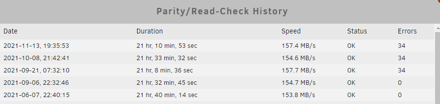

  2. Ok, after the next planned check, it has found 0 errors ! The one I launched manually did the trick it seems. It seems then that the auto checks done after a crash don't repair the errors, which is very weird, because you need twice the amount of time... Which becomes a lot on 10+TB drives.

  4. Hi, 1-2 months ago, power went down. After the automatic parity check Unraid did post-reboot, the server had 34 errors. Since then, I've done 2 more checks (3 in total), and all of the 3 gave 34 errors, so it seems that the errors can't be removed by the parity check. The checkbox for correcting is checked. What can I do ? I've already done a memtest with one successful pass (took already fairly long, a few hours). I don't think it is cable related, as I moved my server beginning of 2021 to the Silverstone NAS case and had to buy brand new special cables for that case (SFF-8643) that worked well for a while before this incident. I've started migrating my array from 4TB to 12TB disks, maybe one of the old 4TB that shows its age ? mediaserver-diagnostics-20211114-1607.zip

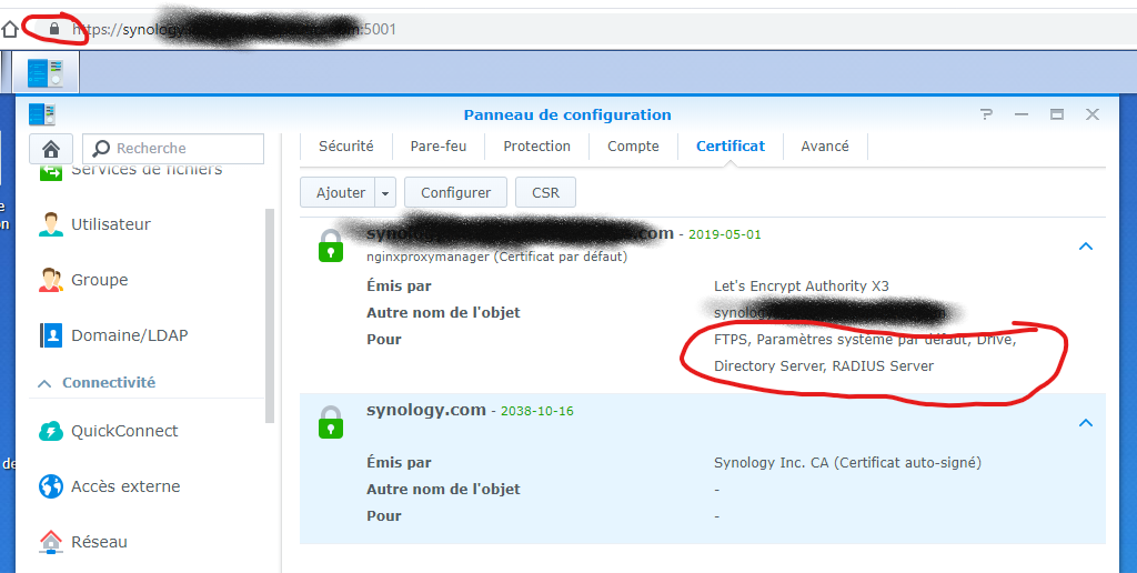

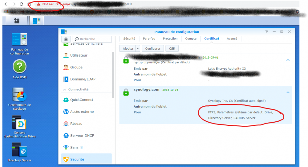

  15. I don't need the certificate from my Synology, my Synolody DSM needs the certificate generated by NPM :
