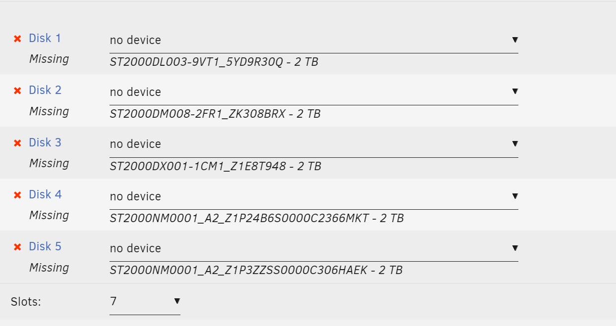

  4. sorry just read what i put and made no sence I have updated to Version: 6.10.0-rc1 and have hpsahba plugin installed but all i see is this and clicking drop down just shows no device. i have tried resetting config but that does not help
  5. Hi all, I wanted to upgrade to 6.10-rc1 however once i upgrade i cant see any of my disks because ive enabled hpsahba is there a way to disable it so i can run the kernel patcher again then re enable without losing data tia

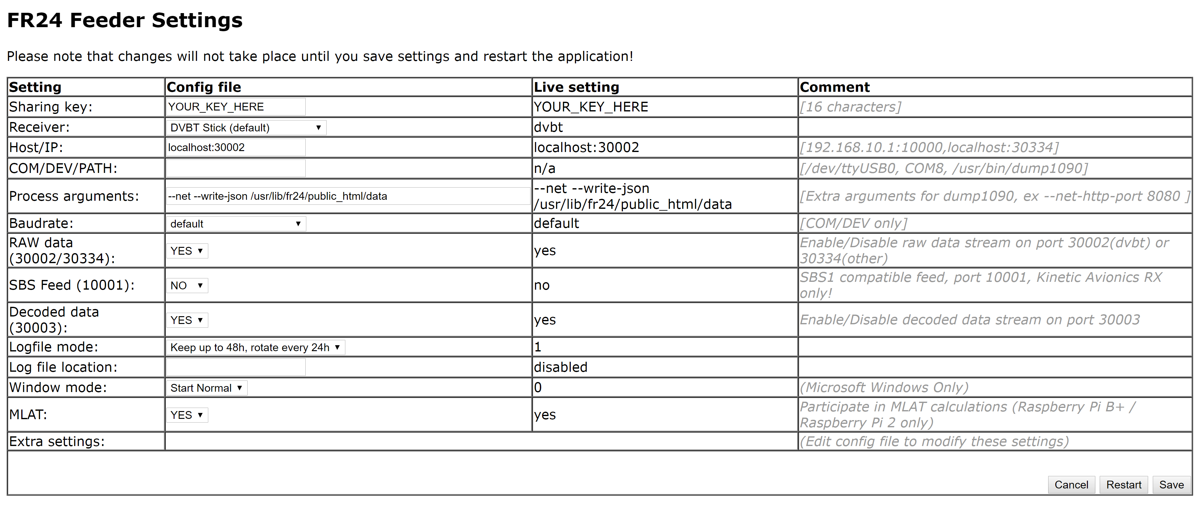

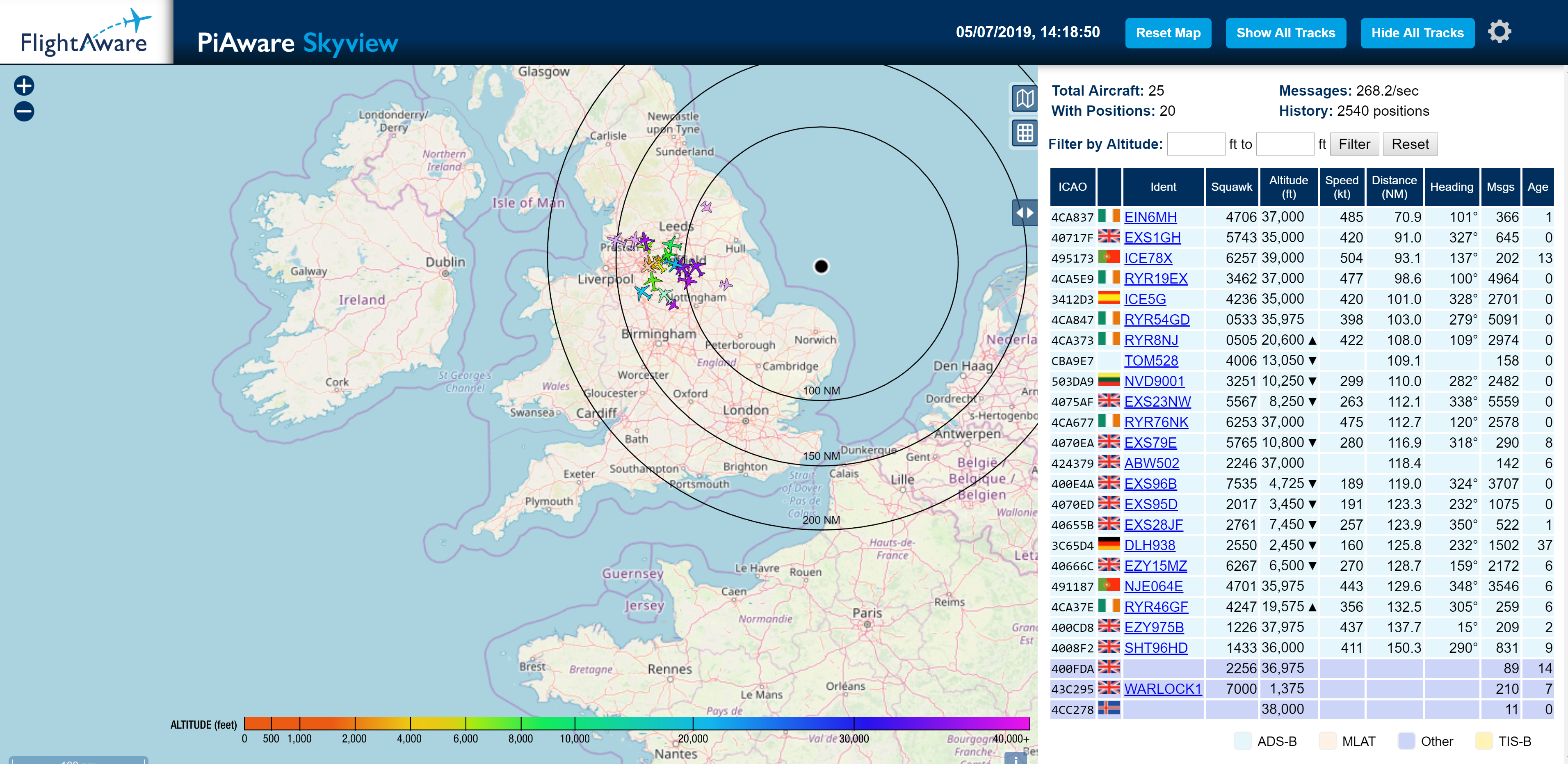

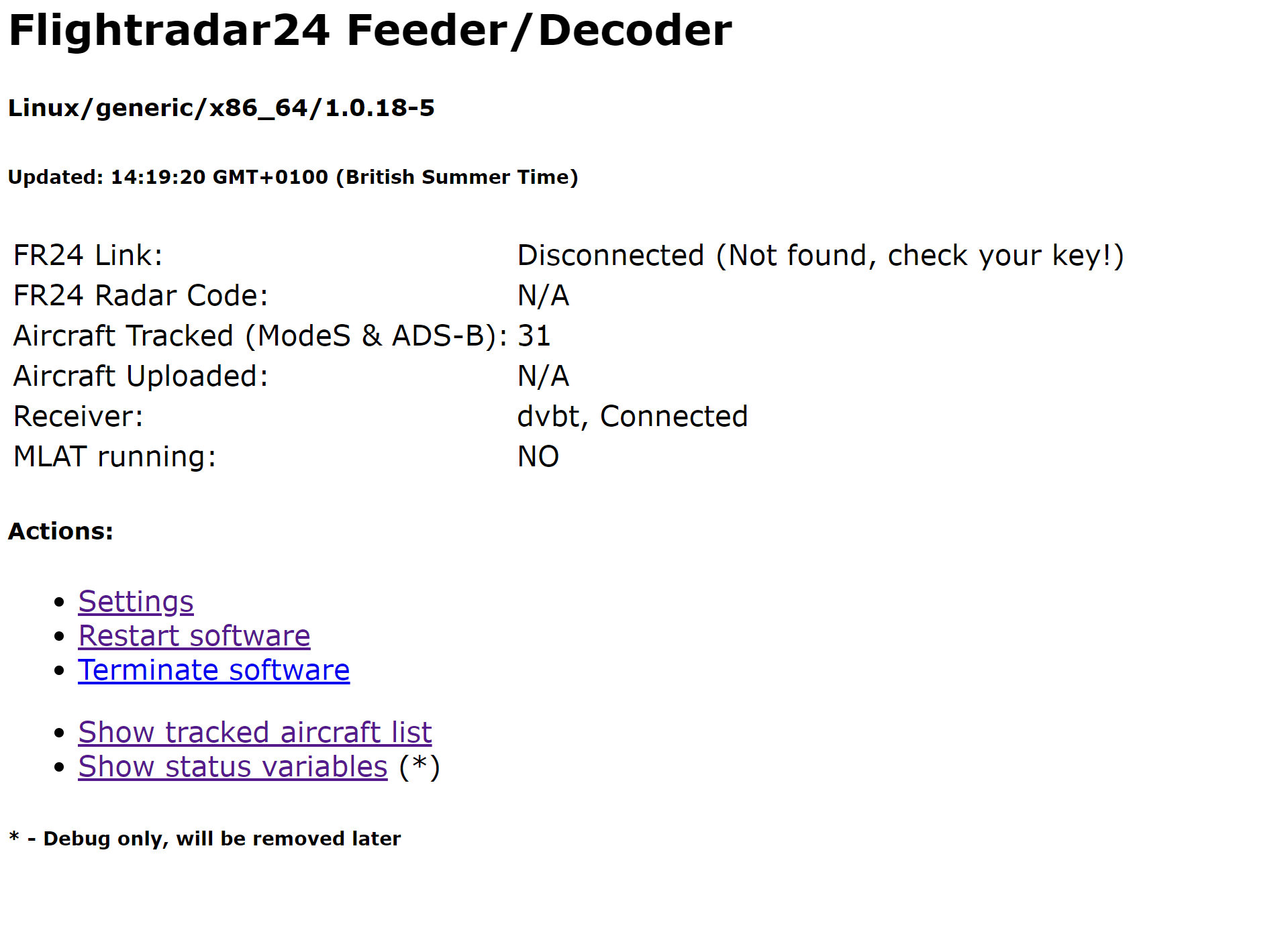

  7. Hi all new to this i have managed to configure flight aware side of this and am supplying them with data however im unable to get Flight radar 24 to work see my settings below not sure what i have done wrong and not sure how to get key ive tried --signup not does not seem to work either in putty or docker console
