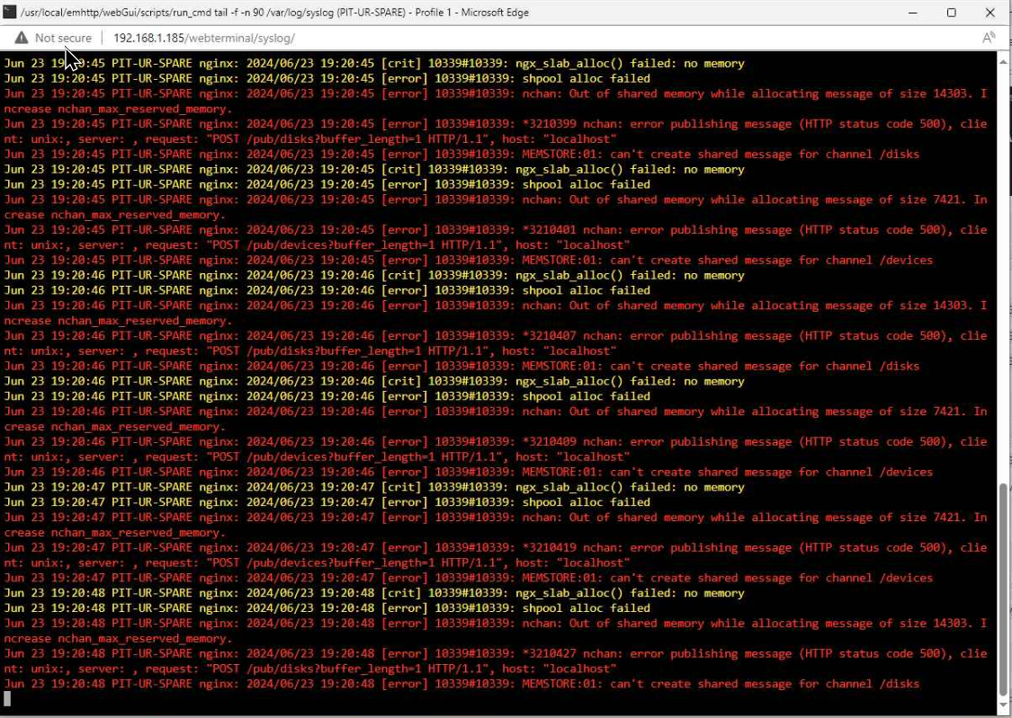

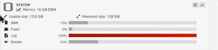

I reduced the amount of memory my VM's were taking, thinking I was running out of room. But that didn't fix it. How do I troubleshoot this nchan_max_reserved_memory and other things in the log? I am attaching the diagnostics file too Thanks for the help in advance, George pit-ur-spare-diagnostics-20240624-0035.zip

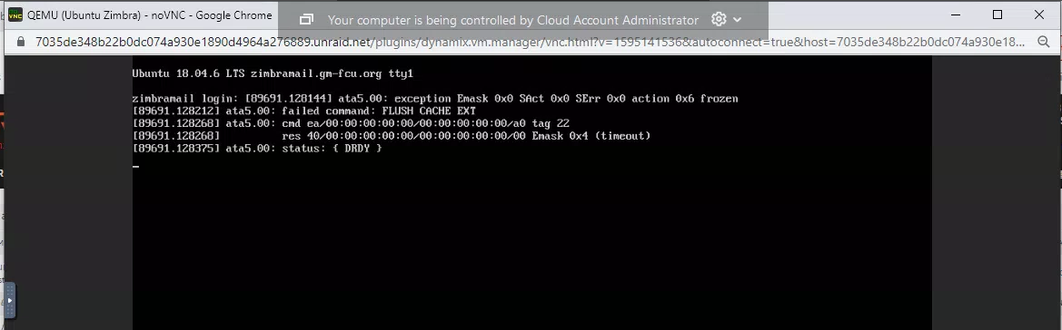

Ubuntu server VM, Failed to write entry... ignoring: read-only file system errors - production unit
Thank you very much for the help. I need to schedule some after hours maintenance and replace things. I am thinking of replacing the sata cable first... then maybe the sata pcie card that has 4 ports on it if the problem persists. maybe both at the same time... since its a production server.... oh the joy.... George
Thank you. I have a question. I do not know how to tie atat10.00 to which Sata port or piece of hardware. I do have a multiple port sata card.. and a total of 7 disks in this thing including two cache drives.. How can I figure this out? Thank you for finding this. SIncerely, George Miller
NEW ERRORS Everything was clean for a few days after the fix, but now I am seeing these (below) error starting to creep in. Maybe there are better clues in this screen shot. We have had no power failures (unraid system is on a huge UPS), no force stoppings, no updates, HD's are reporting good within unraid, no improper shutdowns either ( always shutdown this email system from the SSH terminal). Thanks (in advance too) to everyone looking at this with me. I appreciate your help. any more ideas?

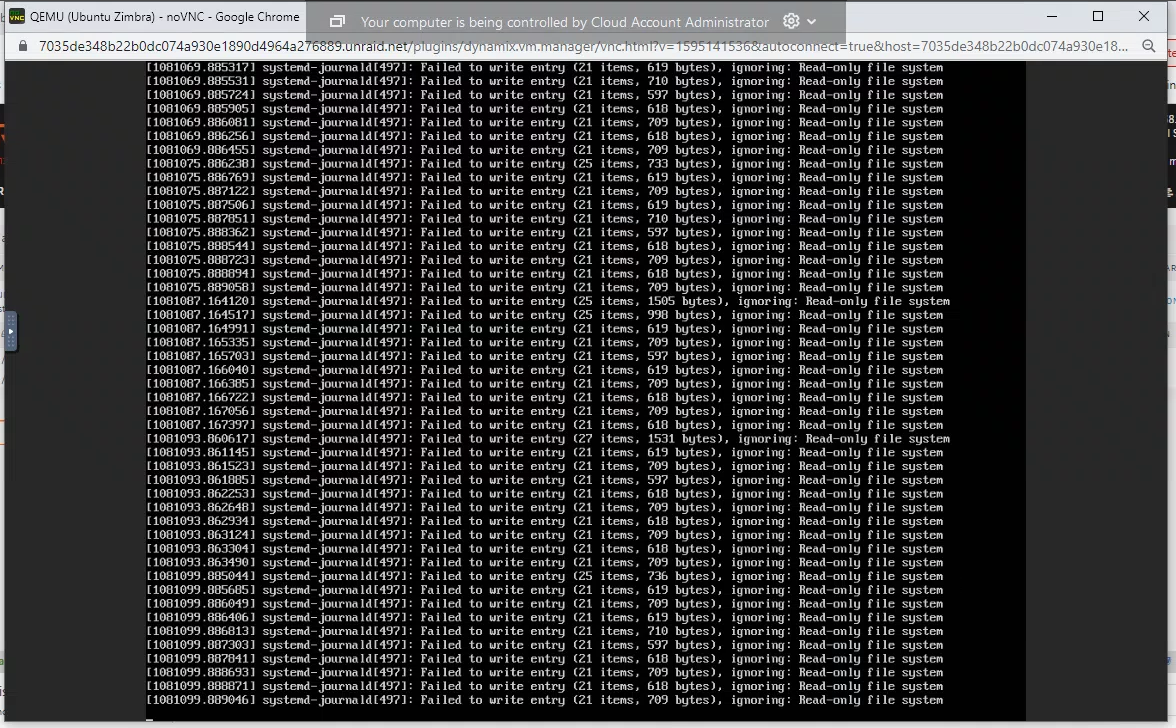

To sum it up, we are up and running again which is good, HOWEVER these errors, shown at the beginning of the post that were showing up on the VM VNC session of this ubuntu server need to be researched, so I can prevent it from happening again. If anyone has any insight as to what could cause them, PLEASE let me know and thanks in advance for your help. Sincerely, GTM

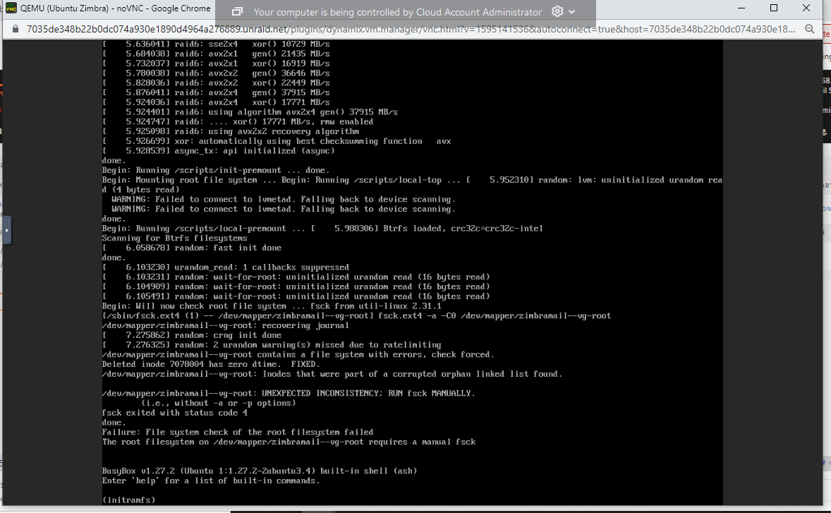

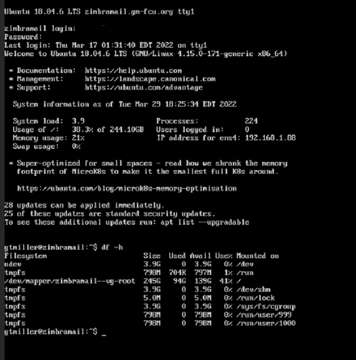

Then I followed the article and performed the FSCK as described, it did the repair of the /dev/mapper/zimbramail--vg-root partition, I pressed yes through the prompts, it did the repairs, then I typed in "reboot" when it was complete and it came back up. After reading this similar problem on the web: On boot up, I logged in and did a df -h command.. to see if any partititions on the disk were full.... I don't see a sector called "boot".. but I may not know what I am looking at.. do you think disk space has anything to do with this? It doesn't look like it to me, but I could be wrong. Please let me know what you think and thank you in advance for your help.

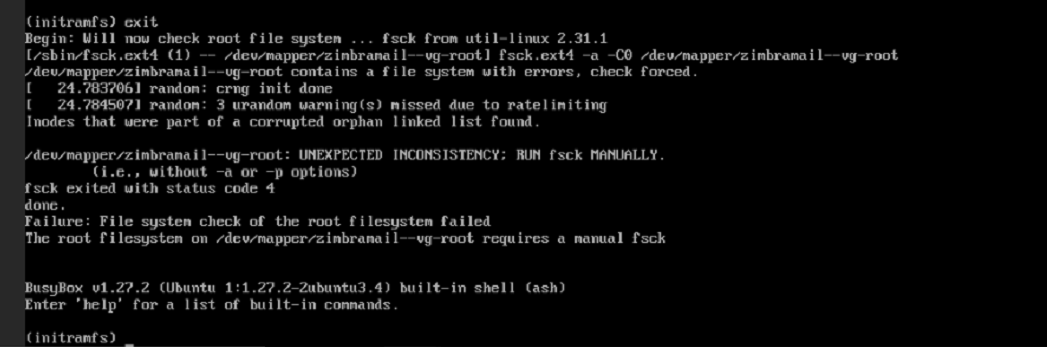

To update the situation, I found this article: https://ostechnix.com/how-to-fix-busybox-initramfs-error-on-ubuntu/ I then at the last prompt of the last screenshot (above) typed in "exit" and pressed enter.. and got this:
Thanks, Here is the diagnostics I just now downloaded. server-vm-diagnostics-20220329-1911.zip
Need help asap. production unit. willing to pay for support. attaching screen shots of vnc ssh session. Ubuntu server has been running fine for months as a VM, now wont boot up - production unit. need help fixing.
