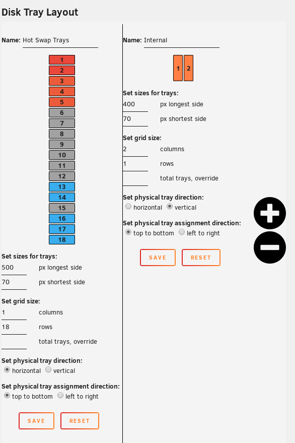

  11. Update 2019.07.10 Commit #98 - IMPROVEMENT: Added color list for color selection under the "Configuration" tab.
  12. Did you make sure that: - You changed the "Data" color under the "Configuration" tab and not the "Custom color" under "Tray Allocations" - Does not try to use the same color for "Custom color" as for those pre-defined under "Configuration"? Custom colors works as an override and can not be the same as "Parity" "Cache" "Data" "Empty" or "Unassigned" pre-defined colors. Try to change 11 and 14 to f.eks. #FF0000 to see if it saves and uses those values, to reset to colors, you can use the predefined colors and it will automatically ignore it and use the pre-defined instead.

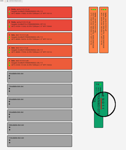

  18. Update 2019.07.06 Commit #90 - IMPROVEMENT: Adding a console window for "Force Scan" button, making it easier to see what's going on in the background. Commit #89 - BUG: Cache drive get unassigned color if it is an nvme drive. Use SCSI generic device node name instead if device node name is null.
  19. @shaunmccloud It likely happened because your cache drive is an nvme drive and that unraid uses nvme0n1 device node name for identification. This would be left blank in this plugin as it saved only the device node, and not the scsi generic device node. It will now store scsigen dev node as dev node if it is empty. In other words, should be fixed during next update.

  22. Ah, in the database itself. That flag means "hidden", and simply hides it for assignments. It should be auto detected by force scanning the drives (which it does not do automatically anymore).
  23. What do you mean by identified by "h", like sdh? or does some information lack here? The "sdh" in this case is used to catch data from Unraid-table so we know which disk does what in regard of the Unraid array. Else the most useful information this plugin needs and uses is the information from "lsscsi -g -u" + smartctl. It might be a bug.
  24. The plugin doesn't use the "sdX" for anything other than information (as they are quite useless and unpredictable). But the cache disk has to be set as a cache drive by unraid and recognized as one as well. You can try to reset the specific Cache drive color by choosing one of the pre-defined colors, it should then null out the value in the database.
