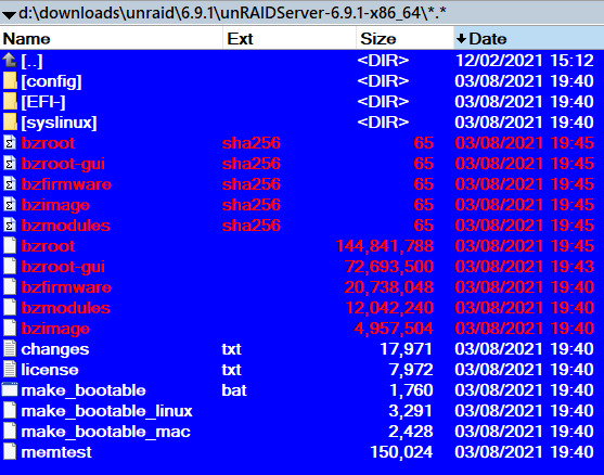

  6. @klepel Thank you! I cannot believe that I saw nothing out of place, yet the issue was looking right at me, wow. I didn't notice that the cache drives were no longer assigned. That explains my issues. After assigning the drives, everything is back to normal on 6.8.3. Take away for me is to remember to review those release notes Now that I emergency is over, what do you think about staying on 6.8.3 vs trying 6.9.1? I have downloaded 6.9.1 zip, but should I just wait for 6.10 stable? @Hoopster Oh thanks for the reminder about manually upgrading. It's been so long since we had to do it that way, I forgot. I thought we only copied a couple of files back then. I see there are several bz* files now. If I decide to try 6.9.1, I assume I can just copy the highlighted bz* files to my flash, and there is no need to update any other files on the flash, meaning no need to update files from the syslinux directory, as example. Is that correct?
  7. Thank you! That does bring back some memories of how we upgraded in the old days. That said, I will wait to take any further action until I get advice on a path forward. I don't want to make things worse.

  9. Was on 6.8.3 with no issues. Upgraded to 6.9.2, everything was working great except my drives would not spin down, so they remained up all the time. Because that will take life off the drives, I decided to use the GUI to rollback to 6.8.3. I now have the follow issues: -Missing shares, some are there and some are missing. Those missing are not accessible, "Share not published". However, the conf files for shares on my flash drive look ok, nothing missing. -Docker says it cannot start, most likely corrupt. I did see an error for one of them saying my Automation path was invalid. That's one of the shares missing. I posted in a couple of threads and was told to start a new thread, so here we are. I want advice before taking any further action. I'm now worried that going back to 6.8.3 is the problem. I have downloaded 6.9.1, but I'm not certain the process to manually upgrade. Update : Marked as Solved. The solution is to read the release notes, especially when upgrading or downgrading major releases, 6.8x to 6.9x 6.9.2 before downgrading tower-diagnostics-20211125-0835.zip after downgrading to 6.8.3 tower-diagnostics-20211202-0939.zip

  11. no, I was on 6.8.3 before upgrading to 6.9.2 So I just used the Upgrade OS tool to rollback. However, no sooner than I posted here, I noticed that some of my shares are missing and my docker won't start. I found in another thread to check folder permissions for /mnt/user and it indeed has the wrong permissions. I'm trying to fix that right now. Is there a issue going back to 6.8.3? Should I, and how do I get to 6.9.1? The GUI only offers the latest version.
