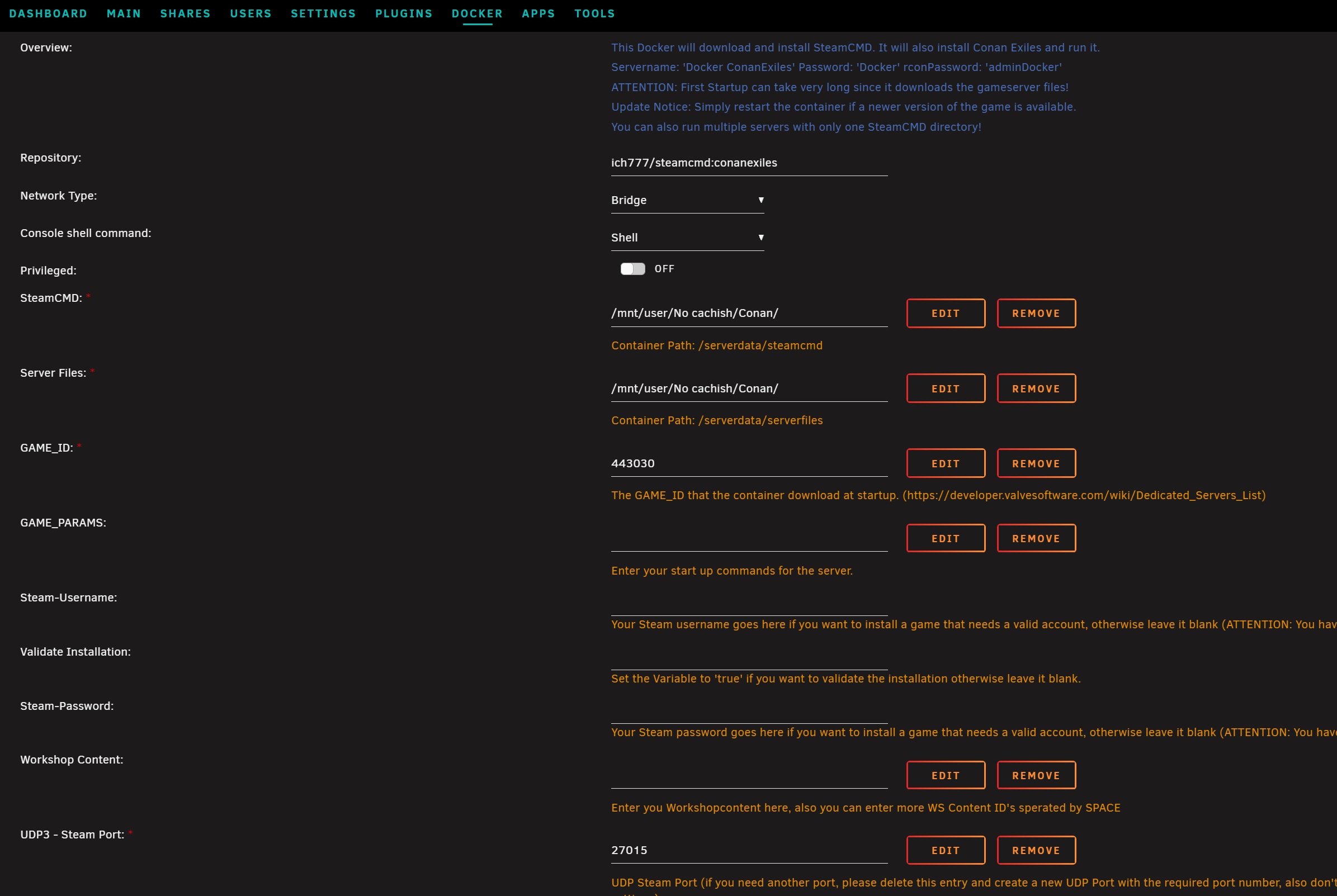

so the ONLY change i have made was the installation directory so it installed into a share that is NOT on a cache drive.. https://pastebin.pl/view/ad2a3afb is the errors im getting... i changed the pre set installation folder from a cache share to a non cache share.. /mnt/user/No cachish/Conan/ for steam CMD /mnt/user/No cachish/Conan/ for server data

Conan issues... wine: cannot find '/serverdata/serverfiles/ConanSandboxServer.exe Connecting anonymously to Steam Public...Logged in OK Waiting for user info...OK ---Update Server--- Redirecting stderr to '/serverdata/Steam/logs/stderr.txt' [ 0%] Checking for available updates... [----] Verifying installation... Steam Console Client (c) Valve Corporation -- type 'quit' to exit -- Loading Steam API...OK. "@sSteamCmdForcePlatformType" = "windows" [0m Connecting anonymously to Steam Public...Logged in OK Waiting for user info...OK Success! App '443030' already up to date. ---Prepare Server--- ---Looking for config files--- ---'Engine.ini' found--- ---'ServerSettings.ini' found--- ---Checking if WINE workdirectory is present--- ---WINE workdirectory found--- ---Checking if WINE is properly installed--- ---WINE properly set up--- ---Checking for old display lock files--- ---Server ready--- ---Start Server--- wine: cannot find '/serverdata/serverfiles/ConanSandboxServer.exe' ---Checking if UID: 99 matches user--- usermod: no changes ---Checking if GID: 100 matches user--- usermod: no changes ---Setting umask to 000--- ---Checking for optional scripts--- ---No optional script found, continuing--- ---Starting...--- ---Update SteamCMD--- Redirecting stderr to '/serverdata/Steam/logs/stderr.txt' [ 0%] Checking for available updates... [----] Verifying installation... Steam Console Client (c) Valve Corporation -- type 'quit' to exit -- Loading Steam API...OK. and it repeats help??
