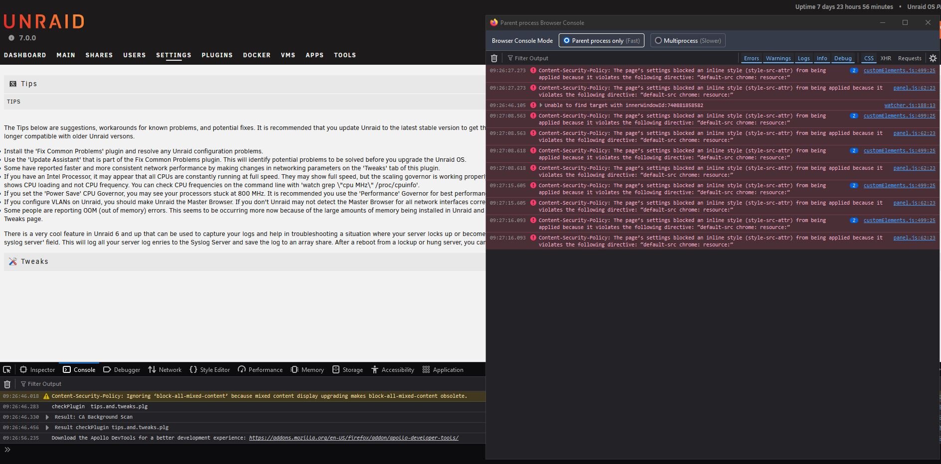

  1. See attached. A server crash and reboot last night did not help 😅 Nevermind! The crash was caused by (or caused?) corruption of my USB flash. Upon further investigation one of the files affected was tips_and_tweaks.cfg which was corrupted. I migrated to a new USB flash, replaced the pluging files from an older backup and now the settings part is back! Thnx anyway.
  2. Thnx for your reply. See a screenshot from Firefox attached. Not sure if I'm showing you the right stuff, as I don't see "Java Script console" you mentioned. I've tried Chrome and Firefox on 2 separate clients.
  3. I have a weird issue with the plugin: since the update to Unraid 7.0.0, the Tweaks section is empty? I only see the Tips (textual) and the Tweaks header, but nothing else. Reinstalling the plugin did not solve this. Any suggestions?
