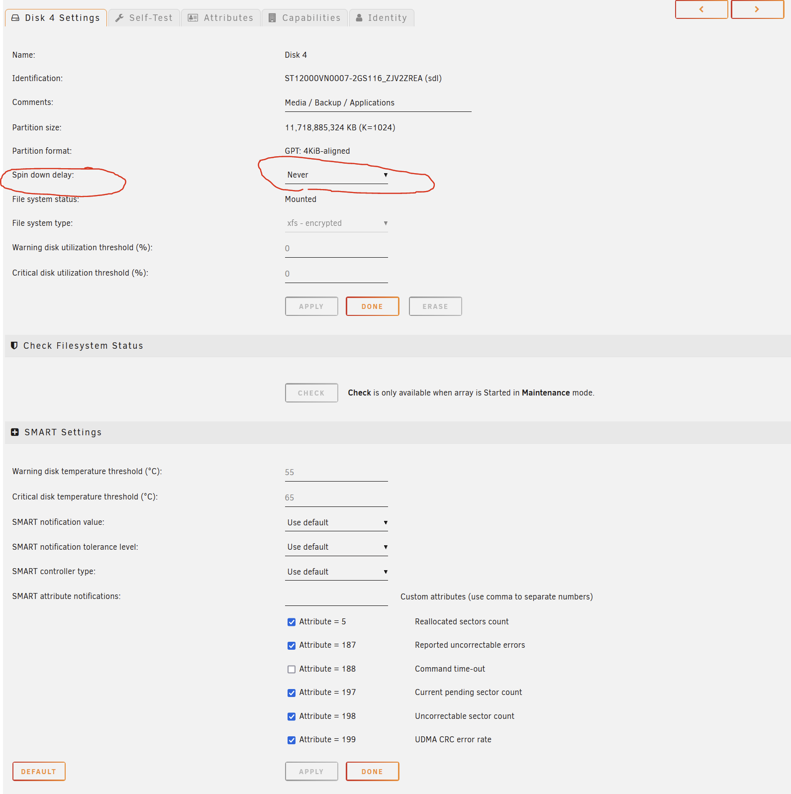

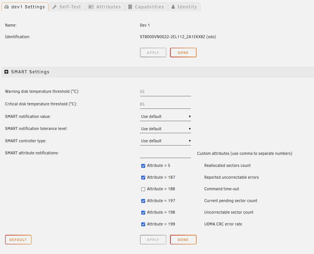

Sorry for opening this thread again, but i have a similar issue but my disks spins down and i don't want it to, i installed unassigned devices and set the disk to "pass through" but i still cannot control the spin up/down from the settings page of the disk where as other disks that are in my array i have the option, see screenshots below: Passed through disk: disk in unraid array:
