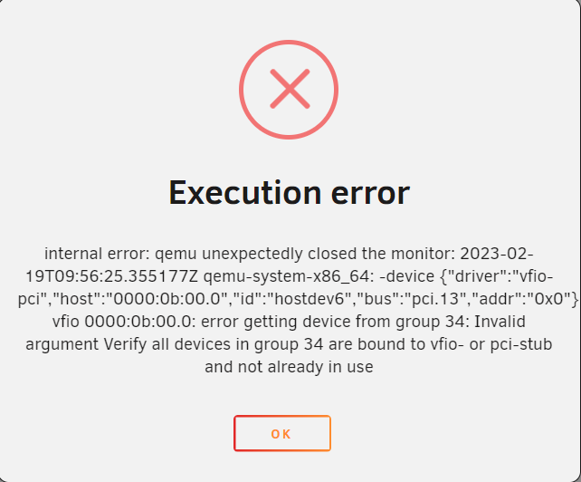

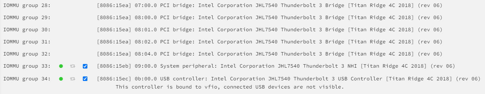

Thunderbolt 3 AIC Passthrough successful, but no devices are detected
glockmane replied to Ahmad's topic in VM Engine (KVM)
Also trying to pass Titan Ridge Card on a Gigabyte X370 Gaming K7 Board.. If I only bind 09:00.0 via XML I can use the Type-C Ports.. -
